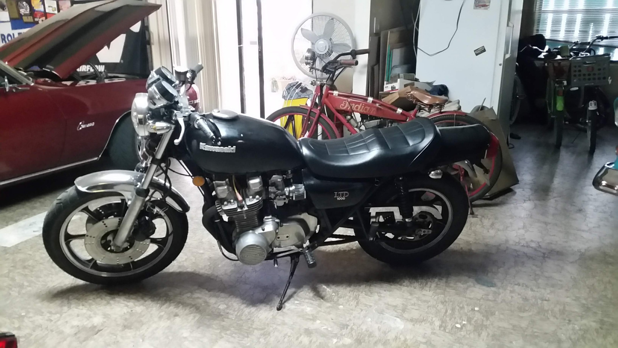

Time to turn my kz1000 into a resto mod.

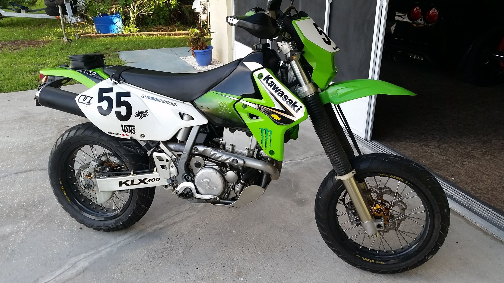

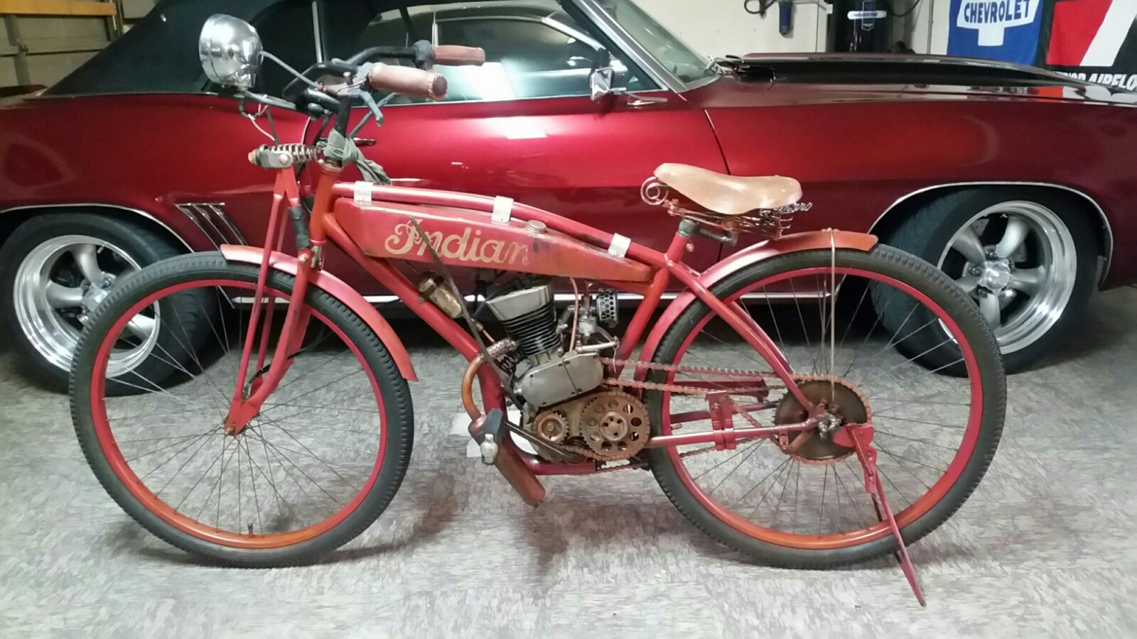

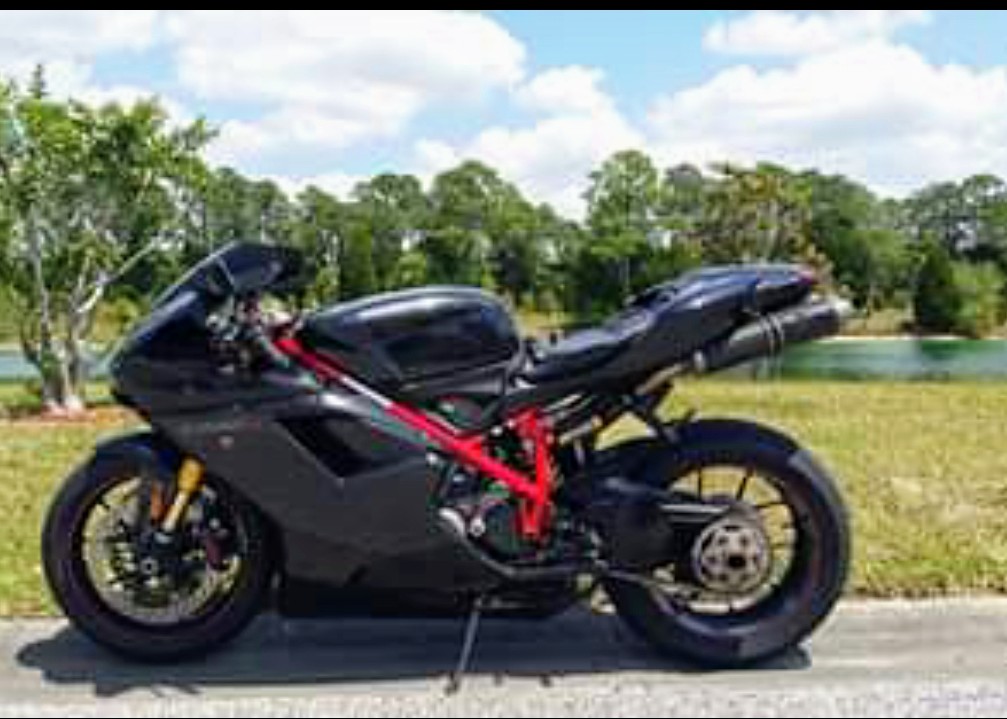

My other bikes. I'm selling the ducati , just built the Indian replica and I'm thinking of robbing my supermoto of its expensive rims for the kz.
I have been looking for the right kz1000 for over 20 years , now I can turn it into what I dreamed of.

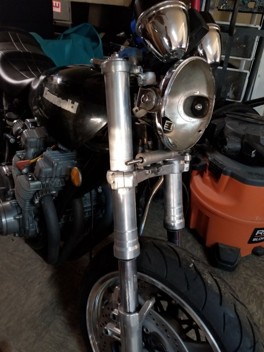

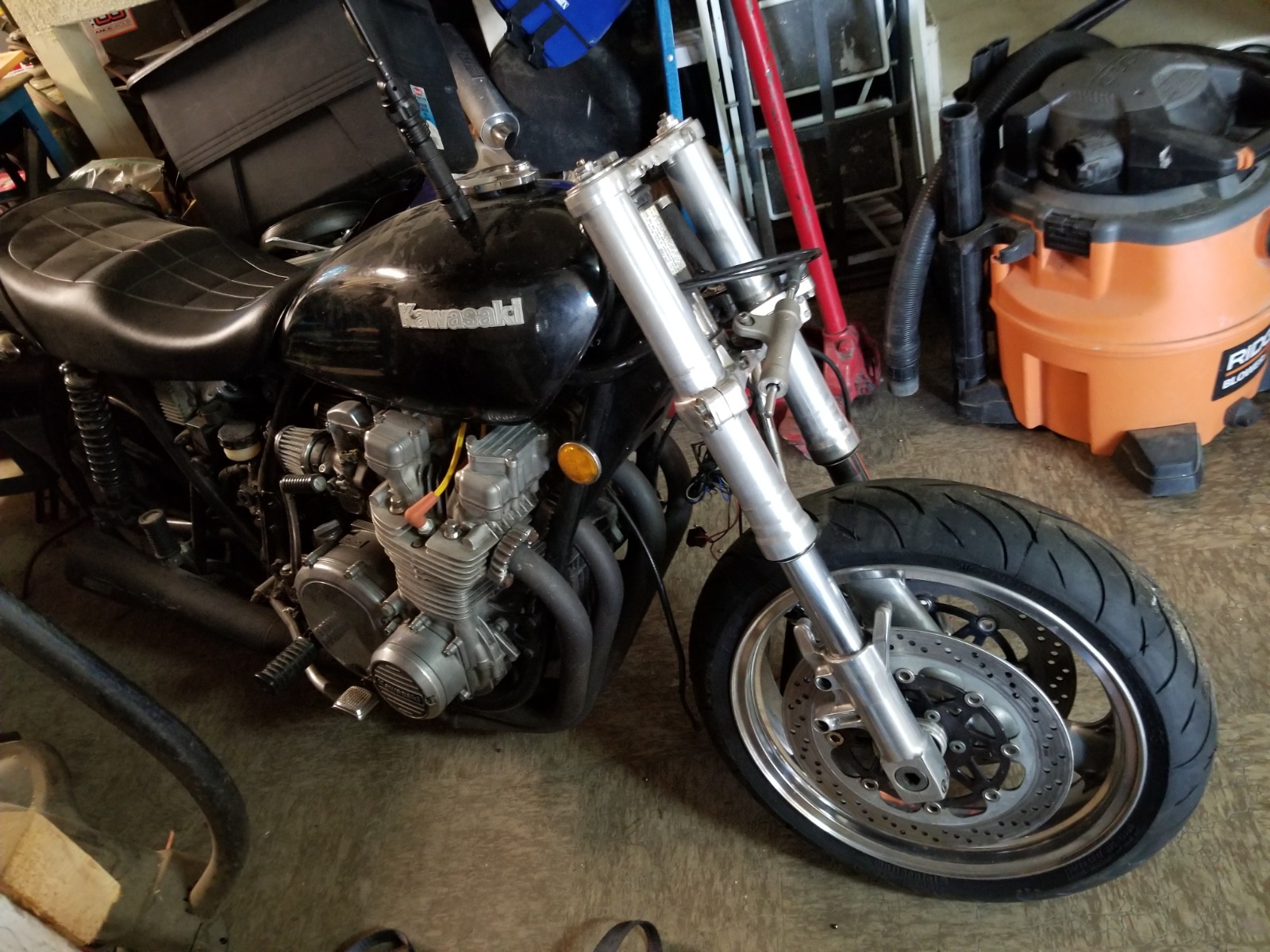

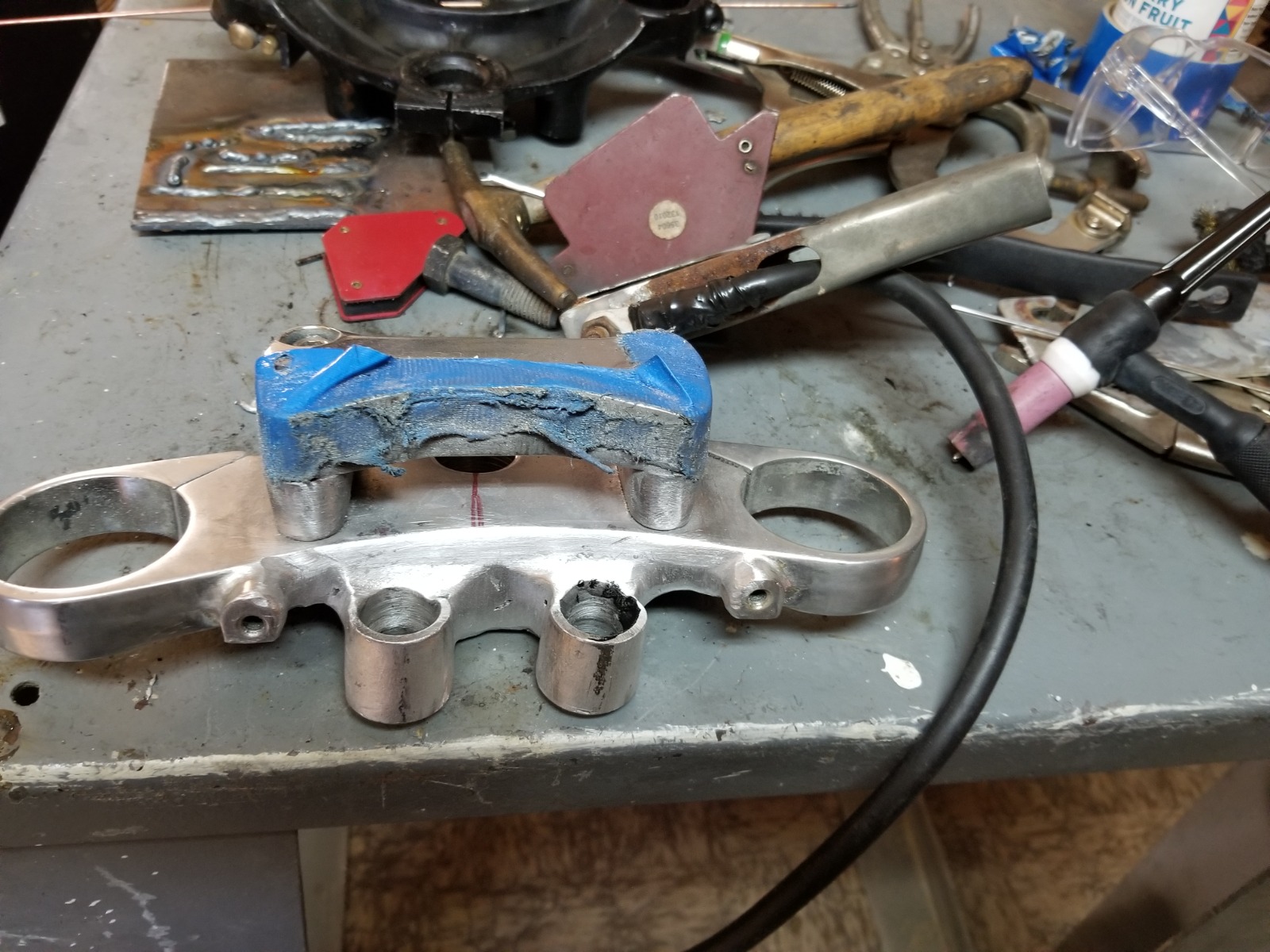

Got some work done on it.
The new front is on.
Forks are rebuilt with 3/4 " spacers.
I welded brackets on the upper tree and a steering stop / steering damper bracket.
Polished everything and put some new rubber on it.
Starting on the rear next.

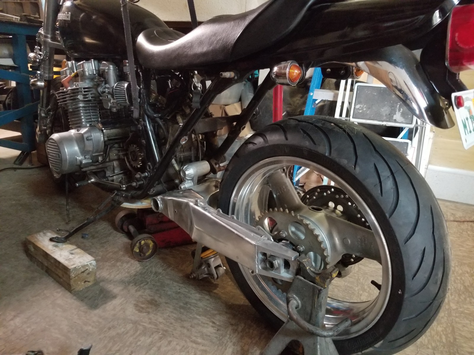

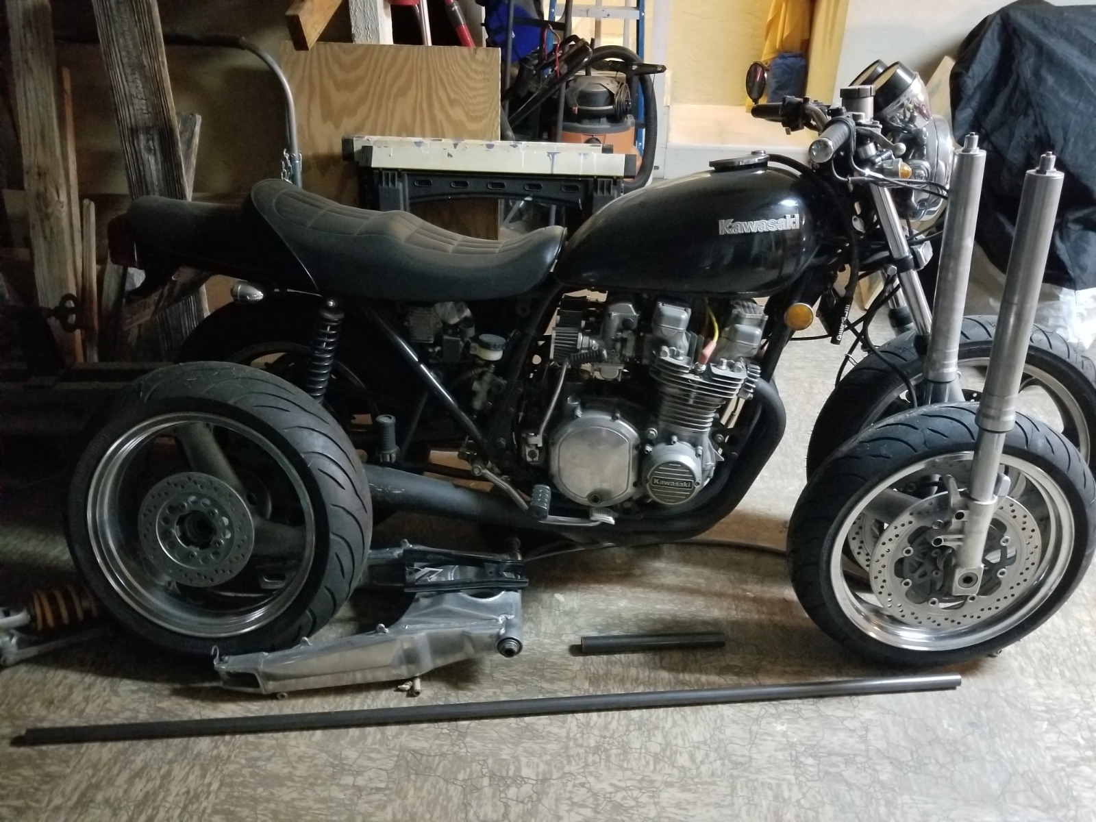

Just did a test fit. There is no way that zx7 swingarm will fit.
Even if I took all I safely could off the swingarm and frame I would still need 3/8 .
Guess I will start shopping for a zx6 or 636 swingarm.
Glad I smoothed and polished this one first.
Probably scrap it with the zx7 frame.
