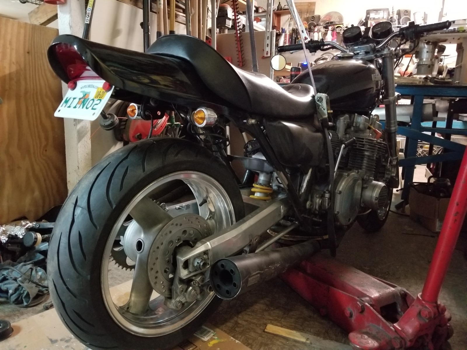

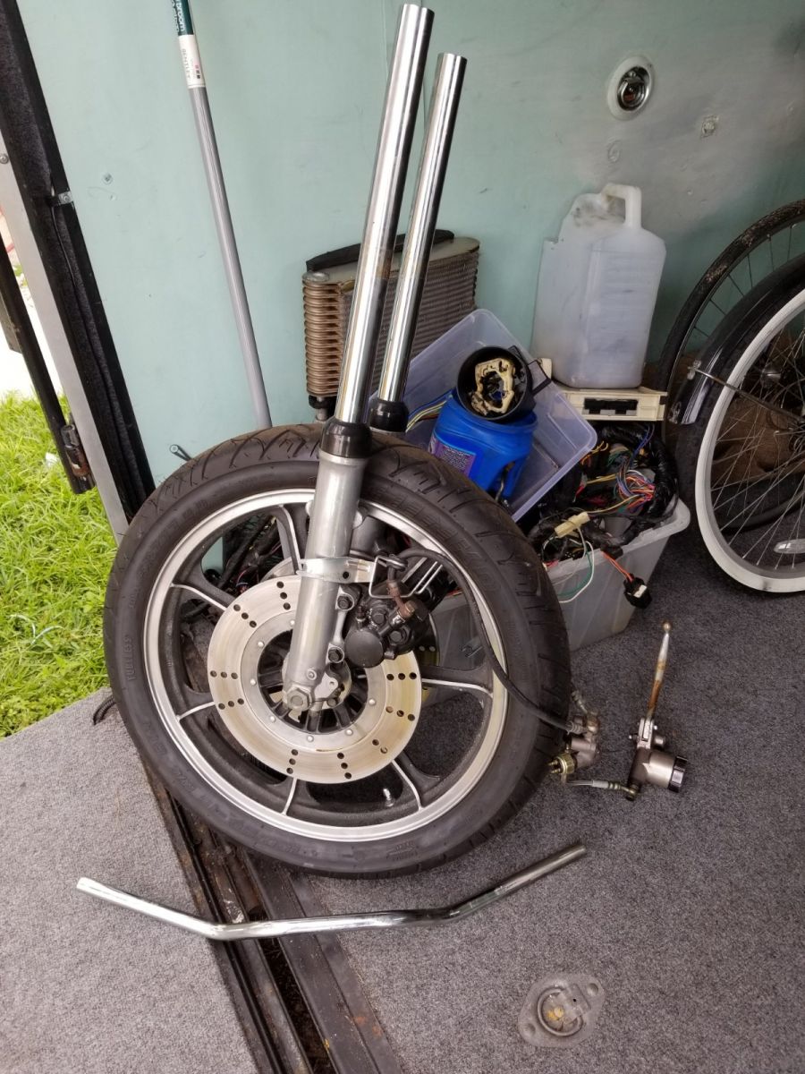

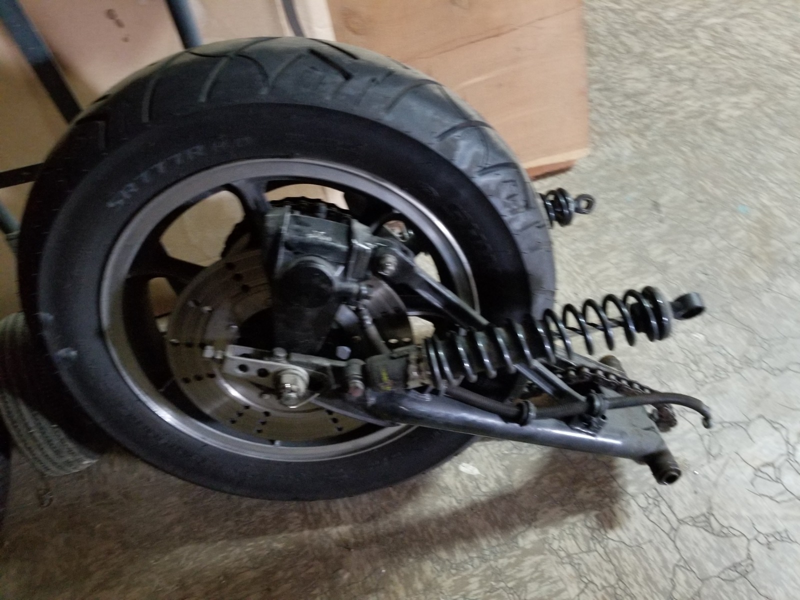

What do you all think these are worth?
Its all in great condition, just put on the new tires so I could ride it for a few miles so I knew it was running right before the build.
Would be nice to start recouping some money to finish it.
Not having any luck selling the parts off the zx7r parts bike .

Where do you live?

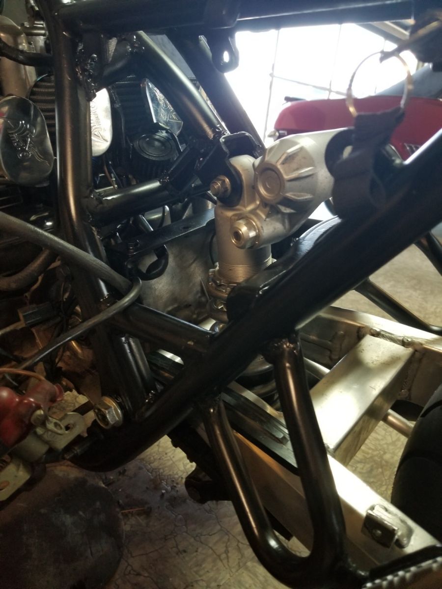

The zx6 swingarm fits much better .
Spent a day stripping and polishing it first.
I took a1/8 off the width and enlarged the holes to use the zx6 bolt. Now I got to make some brackets ,mounts and frame bracing.
Last edit: 29 Oct 2019 04:38 by Bulletkz.

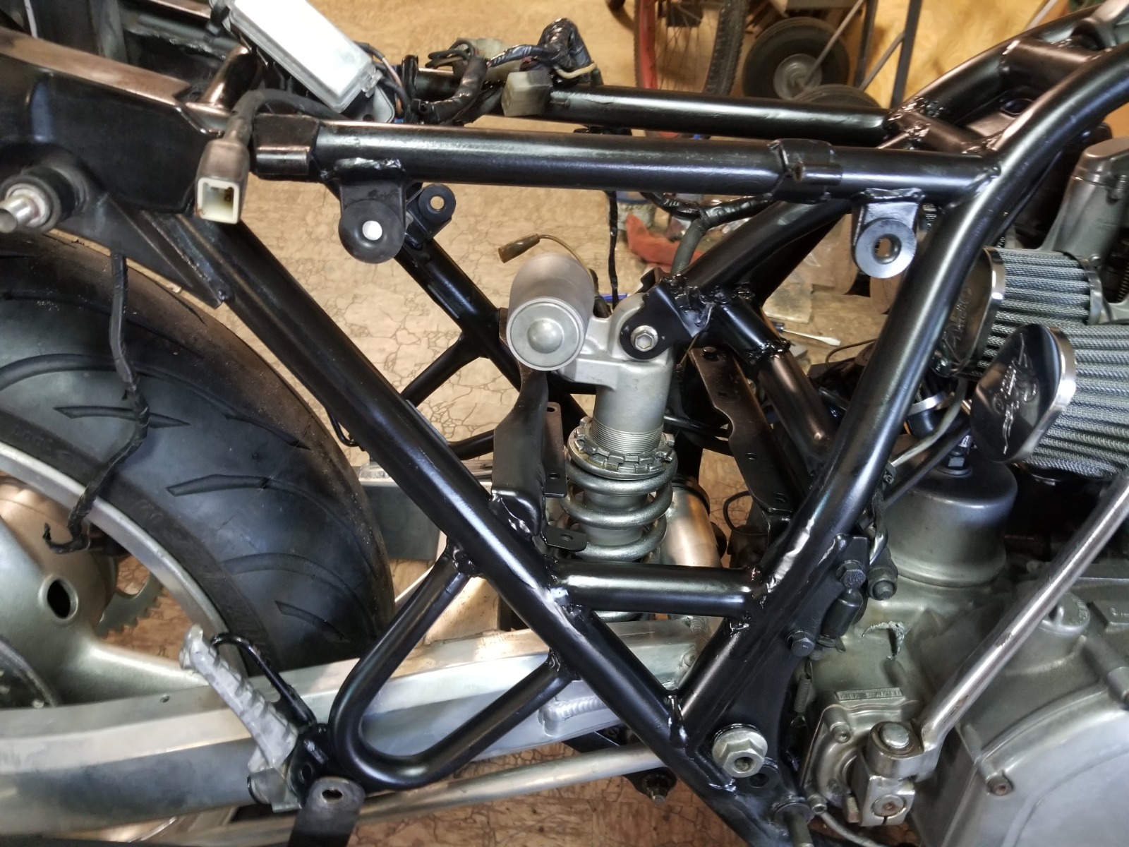

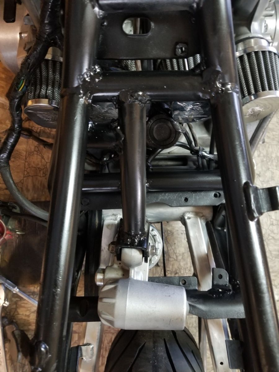

Got all the fab work finished.
Rear pegs installed.
Next will be making gsxr rearsets fit and facing up a battery tray.

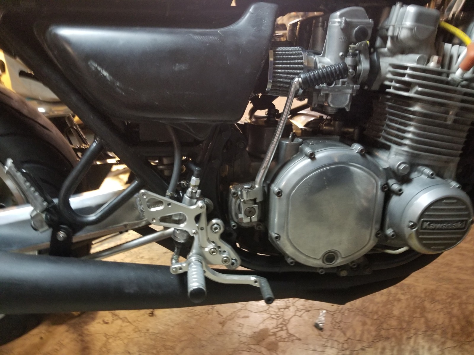

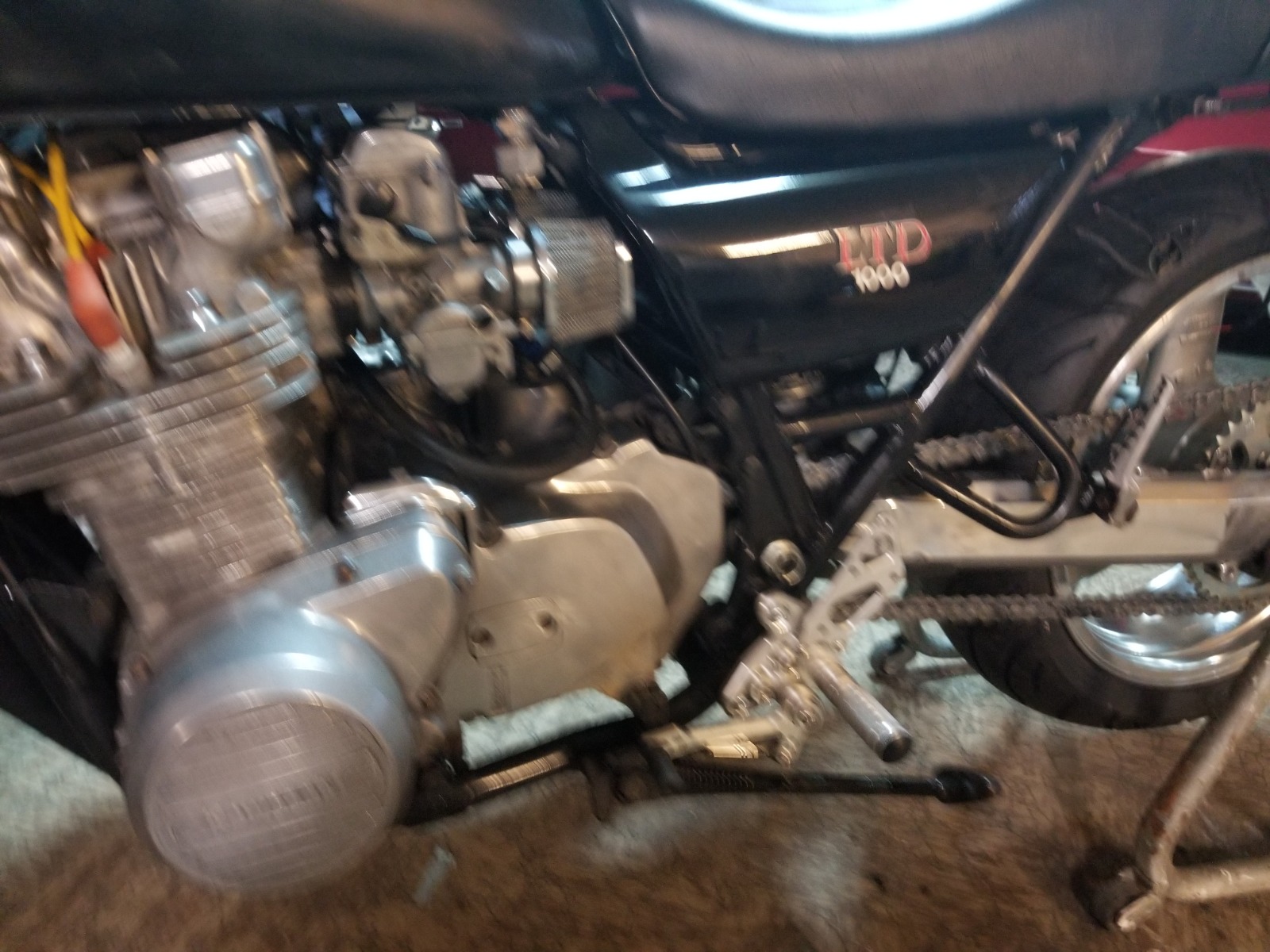

Got some aftermarketgsxr rearsets.
Made some adapters and a kickstandstop.
The kickstand hangs a bit low but I don't think it will rub but will keep a eye on it.
