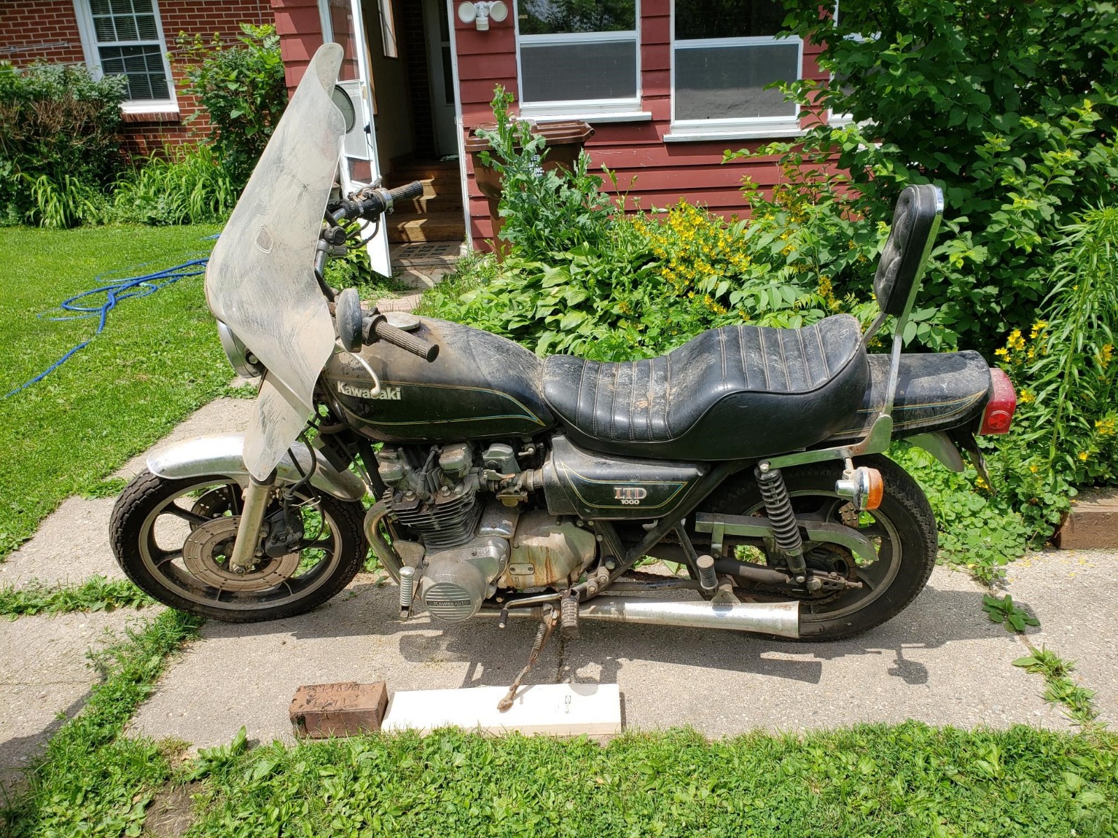

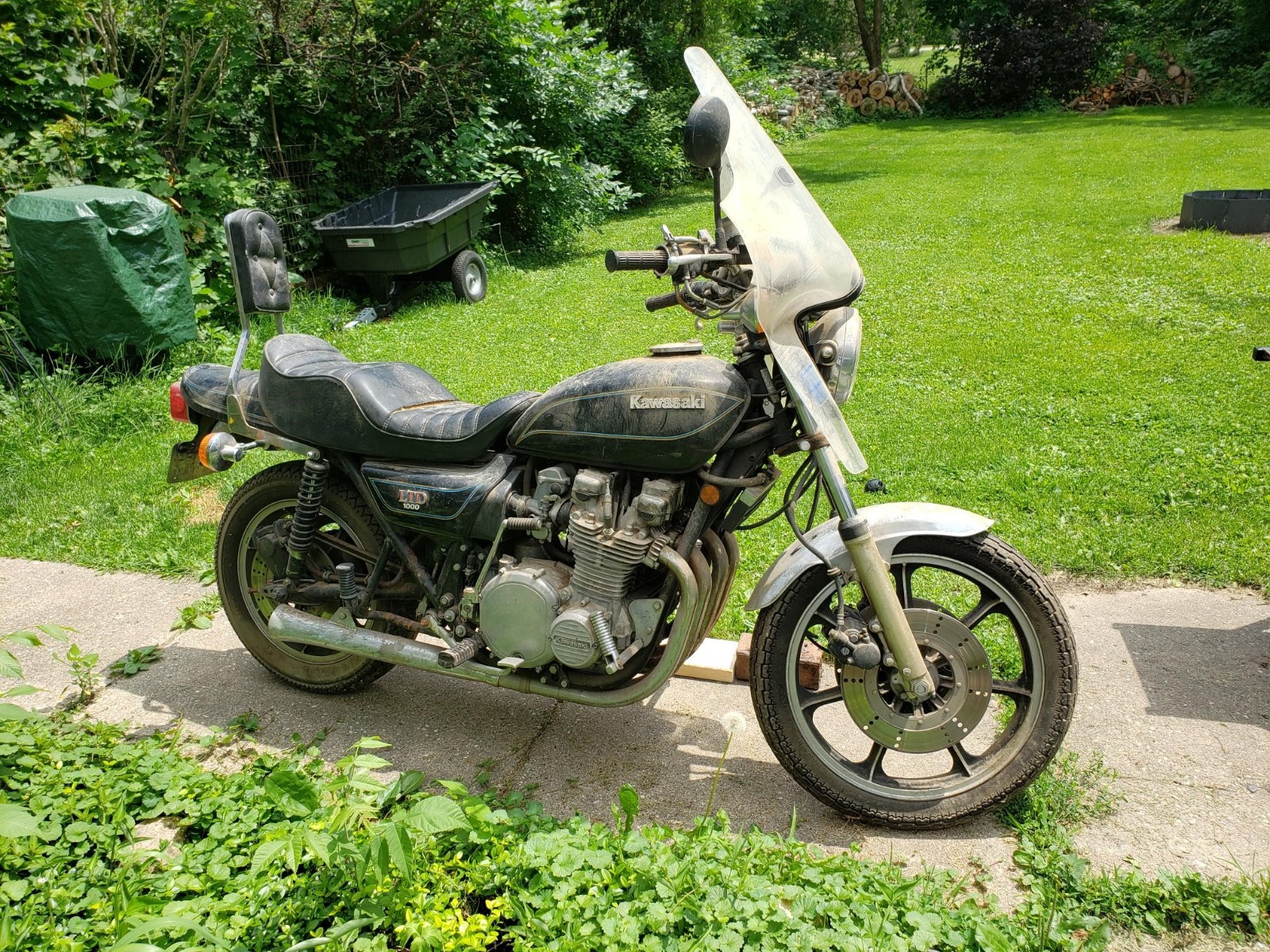

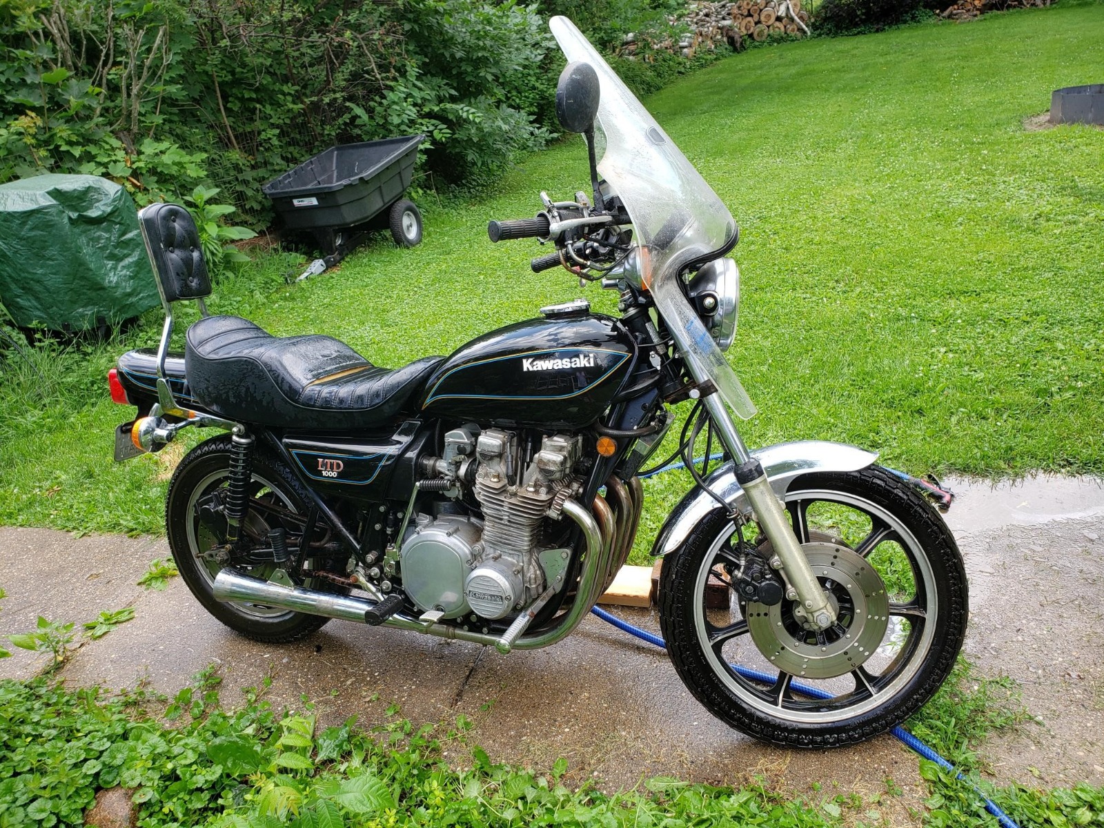

I got her home and started taking a look at her. I posted a photo of what it looked like as I unloaded it off of my truck, and then another photo after literally just spending 15 minutes cleaning a few areas with a scrubby sponge and dawn. I'm encouraged by how clean most of it is coming, including some chrome pieces that I feared may be pitted beyond cleaning. The front fender looks almost new. I'm sure with the parts removed, and some real polish, most of the parts will be reusable.
Same with the gas tank....when I got it open (the little flip cover needed some encouragement), there was a big vacuum sound when I opened it. So that means there's no leaks. There was still about a gallon of 22 year old gas in it.....okay, rust-tea really. I dumped that out and when I first looked in the tank, I wondered if it was going to be usable. But after spending some time with my pressure washer nozzle in there, hitting it from every angle that I could, it looks WAY better. Next I'll give it the metal rescue treatment (my plan is to use just 1 gallon, and set it up on a modified rotisserie to splash that stuff around everywhere. The tank has no dents.....some rust around the cap area, but I don't think it's too bad.
I also got it winched into the room that I had setup for this project. Just getting it into the room with our 90+ degree temps and high humidity proved to me that it was worthwhile setting up this room.
After the gas tank, I'm not really sure what's the next logical thing to attack....

First thing I would do is to make sure you havn't put any water into the cylinders via the carbs. There appears to be water sitting in the airbox inlet in the picture with the seat up.

01 Jul 2019 10:42 - 01 Jul 2019 10:43Oldjeep wrote: First thing I would do is to make sure you havn't put any water into the cylinders via the carbs. There appears to be water sitting in the airbox inlet in the picture with the seat up.
That was from my spraying it down....those carbs are coming off soon though....
