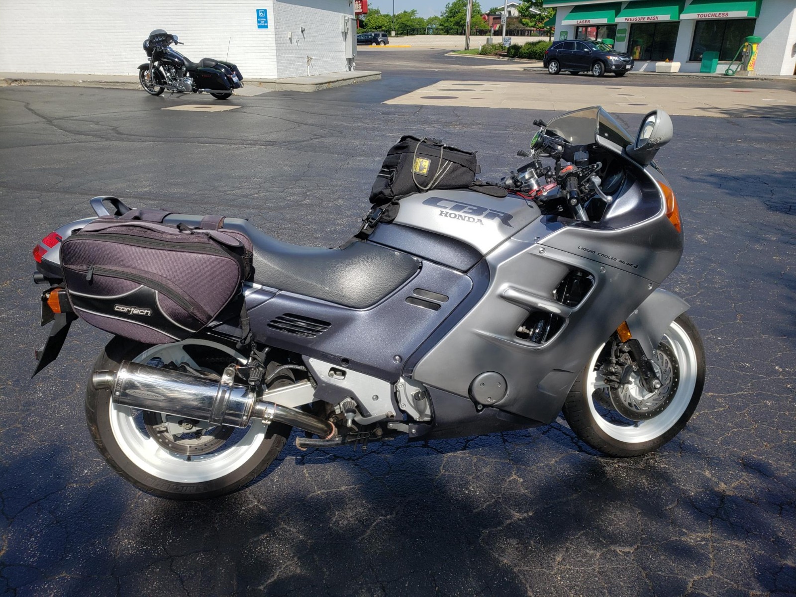

My 1990 CBR1000F that I bought 3 years ago only had 7k miles on it. Luckily, besides tires, fork seals, clutch (maybe PO didn't use the correct oil at some point), and a voltage regulator that failed, it was pretty good. It still looks close to new. Love the bike, but couldn't pass up this KZ1000 opportunity.

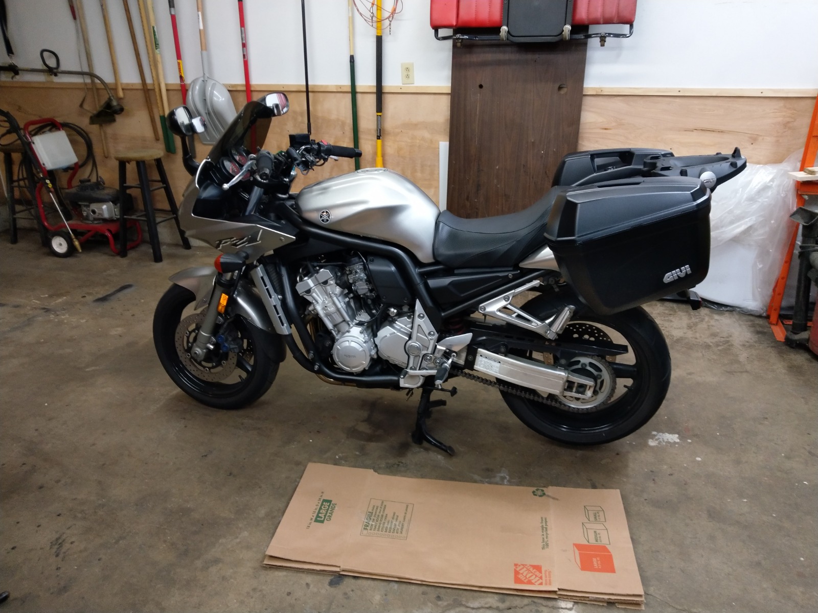

20 Jun 2019 15:05Nice. I've got a similar setup. The kz is for messing around in town and my fz is for longer range, higher speed fun.Webbie1 wrote:Oldjeep wrote:Webbie1 wrote: By the way, this bike has just under 19k miles on it, so it should still be pretty good internally.

Yep, the CBR is pretty much a do-all bike. Comfortable enough to take on a 2k mile weeklong trip, fun enough to blast around town. Even though she's pushing 30, it's still making well over 100hp to the rear wheel, which isn't shabby. Cruising at 100, she's not even breathing hard yet. But this KZ is going to be a really fun restore....such a classic bike. And it's going to be more comfortable for a passenger, from a seating position standpoint for sure, especially with that backrest.
