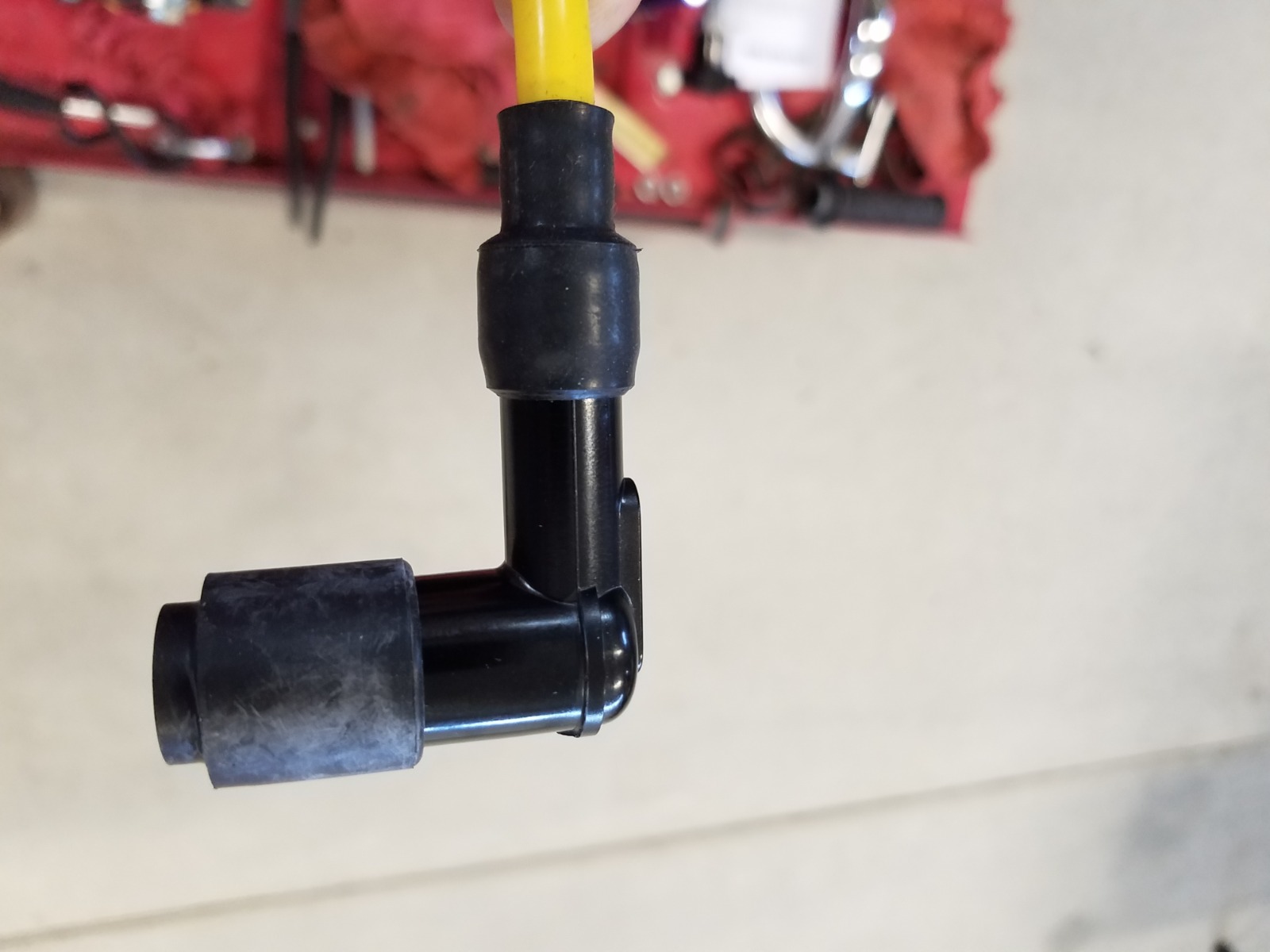

I don't know how much it matters but those wires are resistor type and the caps are resistor too. You don't need both. I'm not sure about with the NGK caps but with some OEM type caps you can remove the resistor and replace it with a straight piece of metal to get rid of the resistance.
- Skidmark
- Posts: 1087
- Thanks: 312
Re: Saving a '81 KZ750-E
04 Aug 2021 18:32
The wire is listed as RFI suppression. I have seen other wire listed as resistance wire with much more resistance than this one does. Since I am going to be running a GPS speedometer, I hope this will help eliminate any signal interference. I have had a real hard time trying to eliminate this issue with an Autometer Speedometer in a VW baja bug. Been down that rabbit hole with RFI interference, and it's not fun. If I experience any performance issues I will be sure to share the outcome. The GPS speedo I got came from China. Crossing my fingers on how the gauge itself works out.

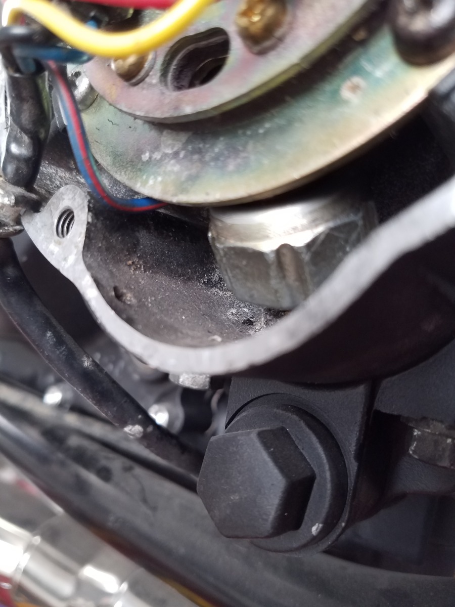

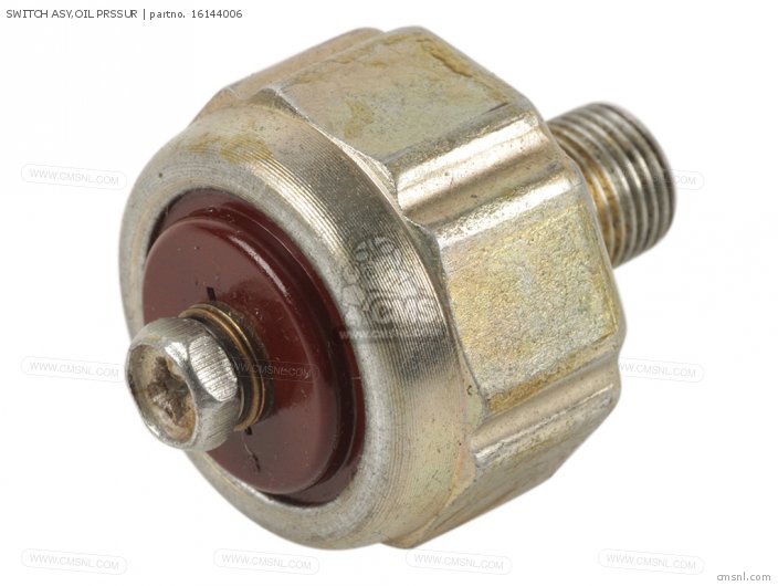

Sorted out my starter issue. The motor cranks over now. But, I have found the oil pressure switch is malfunctioning - it is stuck open, electrically. No continuity with an ohm meter, and should read continuity until pressure is applied. I confirmed 12v to the switch. I was hoping to find a replacement on Z1E or Partzilla, but no luck. Any tips on finding a replacement in the US? Tried Amazon, Ebay as well. OEM p/n 16144-006

I ended up talking to the nearest Kawi dealer, and they link other shops that may have parts. He found a motorsports company in Michigan that showed some (?) in stock. I called, and sure enough, he confirmed he has a new OEM unit (not used). Worth it's own weight in gold... after tax & shipping - $99.94. Considering the amount of these switches left in this world I felt like I had no choice. Expensive, but one more issue solved.

No eBay APP ID and/or Cert ID defined in Kunena configurationDon´t waste your money, AFAIK, early AUDI, DAIHATSU, FORD, SEAT, SKODA, VW engines use the same 5 dollar oil pressure switch with a flat connector.
www.cmsnl.com/products/switch-asy-oil-prssur_16144006/ 25 dollar

There isn't enough room under the ignition plate for any part taller then OEM. That part you posted will not fit. (or it doesn't look like it would)
