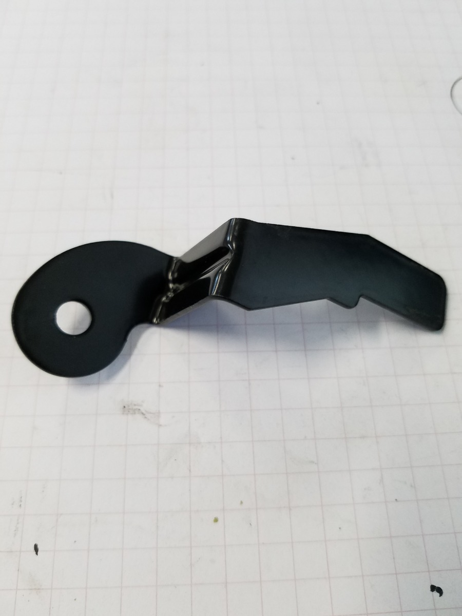

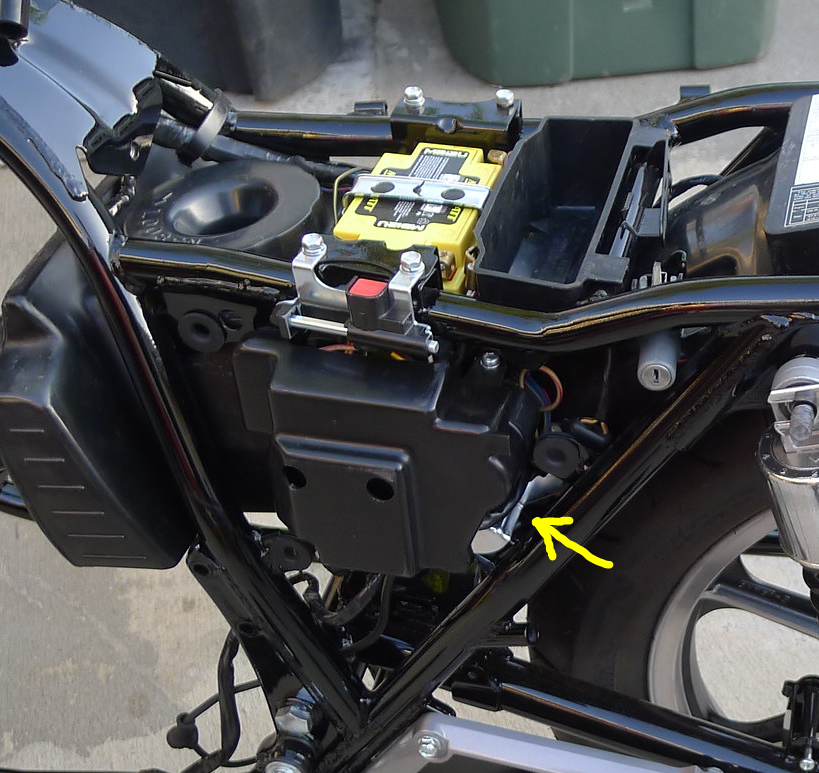

I know this bracket holds the fuse holder, but have a head scratcher on its orientation and location. Can anyone post a pic of where theirs is mounted? Thanks.

That bracket does hold a small fuse holder, and it mounts under the LH side cover. It's the silver plated part in the photo below.

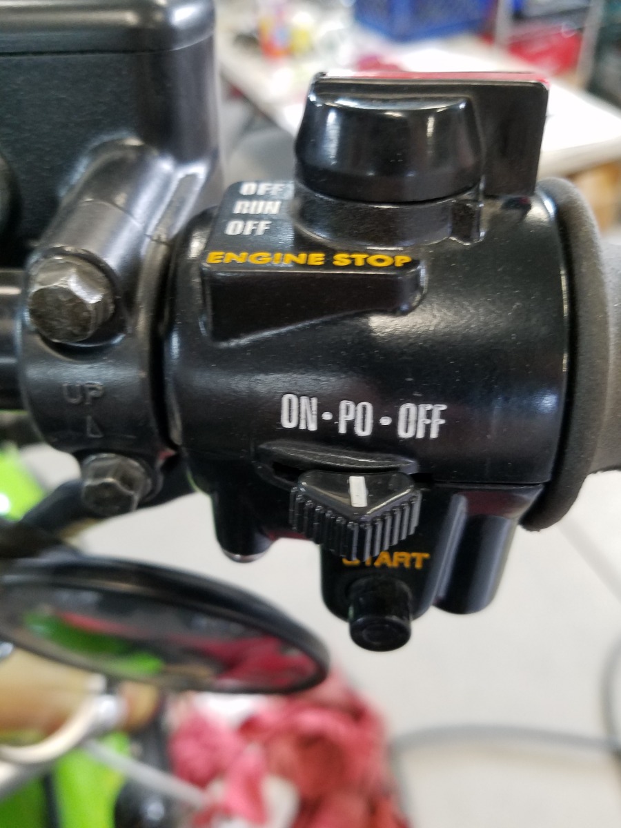

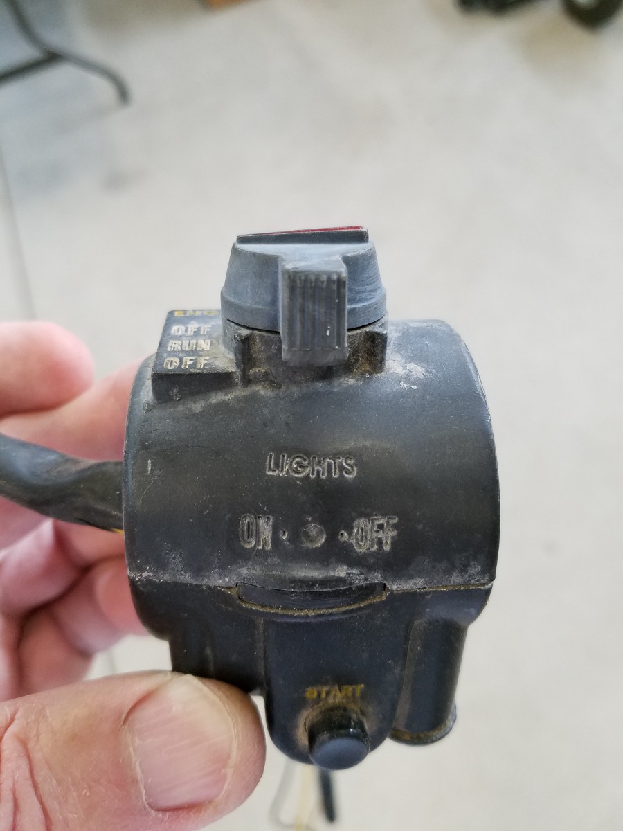

This is a pure curiosity question for the Z1 gurus on here. There is a light switch on the right handlebar control - on/po/off. What does the "po" stand for?
The reason it is curiosity only is this swicth was not utilized on the '81 KZ750E (US model). The lights were always on when the ignition key was in the "on" position. The control housing did not have the lettering painted, and the slot for the switch arm was filled in.

The "PO" position is for the position light, a smal 12 Volt 5 Watt bulb in the headlight reflector.
It´s like an emergency light if your main head light bulb is blown.
