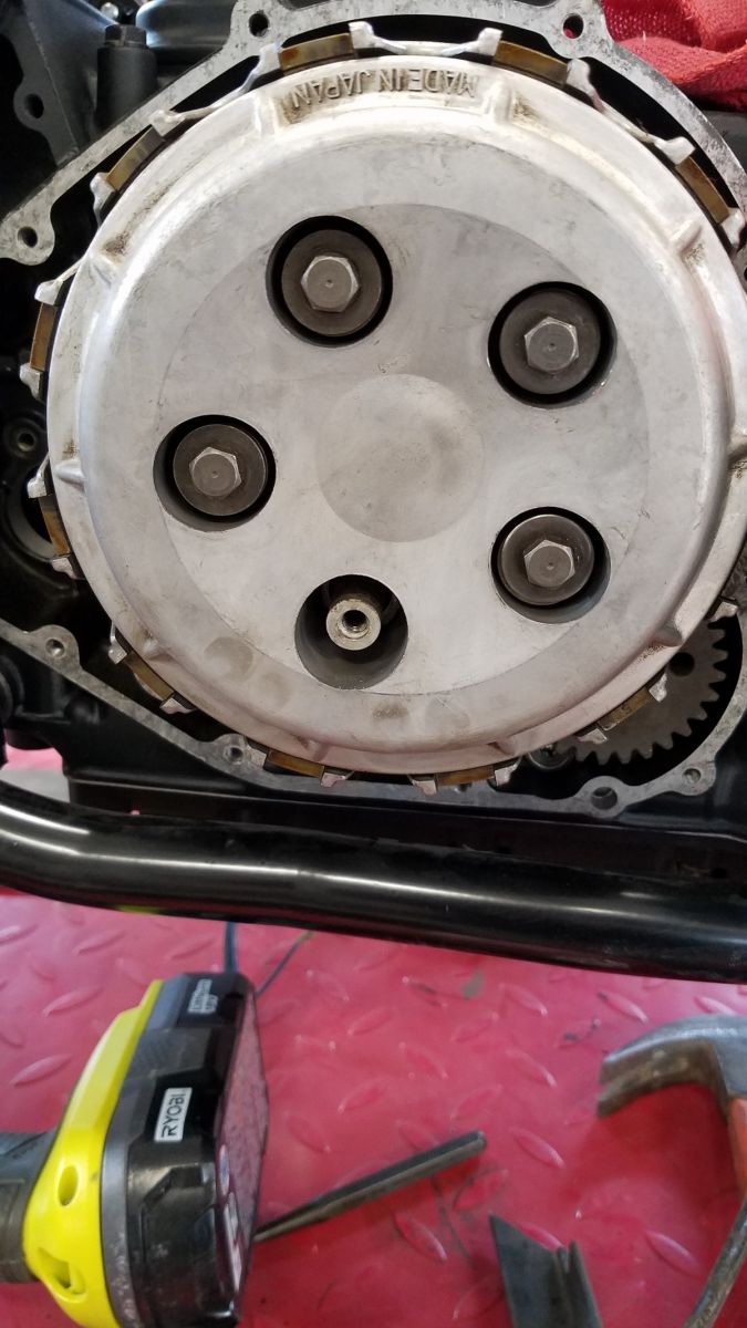

Not something to be proud about, but I am getting rather good at this crap... five new clutch bolts are on their way.

06 Oct 2020 16:58Skidmark wrote: Not something to be proud about, but I am getting rather good at this crap... five new clutch bolts are on their way.
Getting good at breaking them??? lol
- Skidmark
- Posts: 1087
- Thanks: 311
Re: Saving a '81 KZ750-E
06 Oct 2020 19:11 - 06 Oct 2020 19:11
Yes, which leads to experience taking them out.

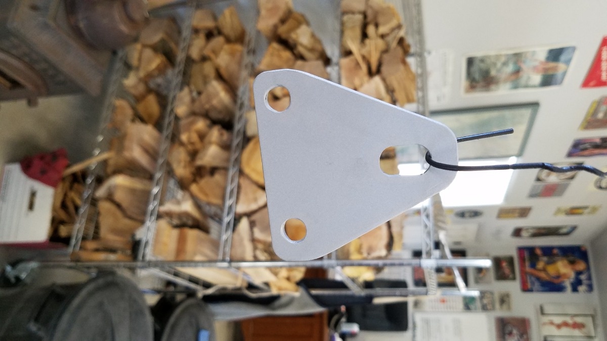

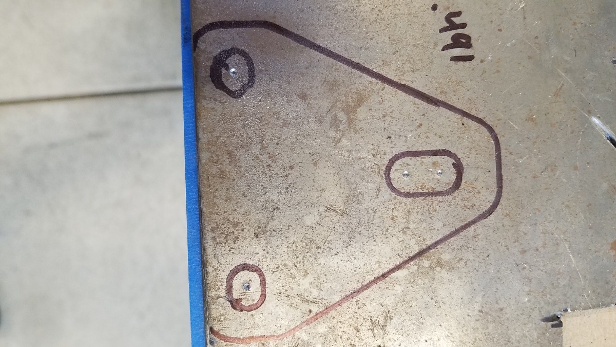

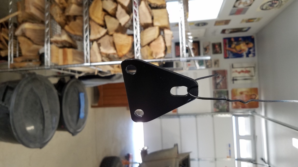

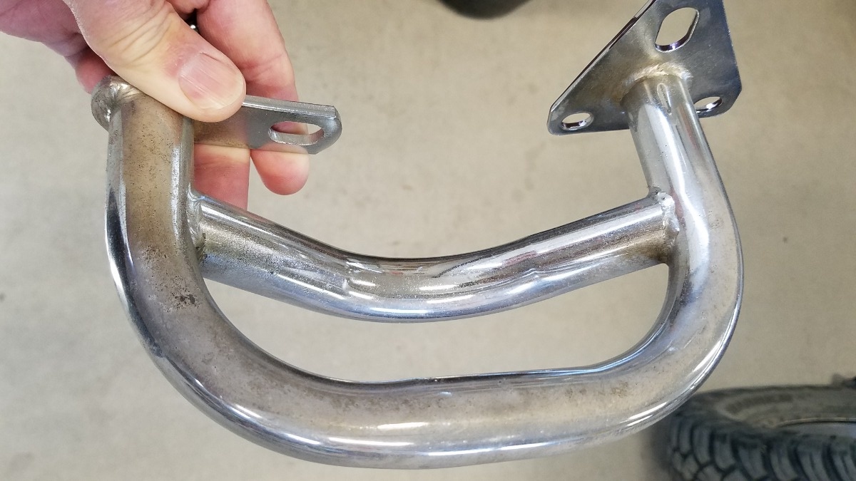

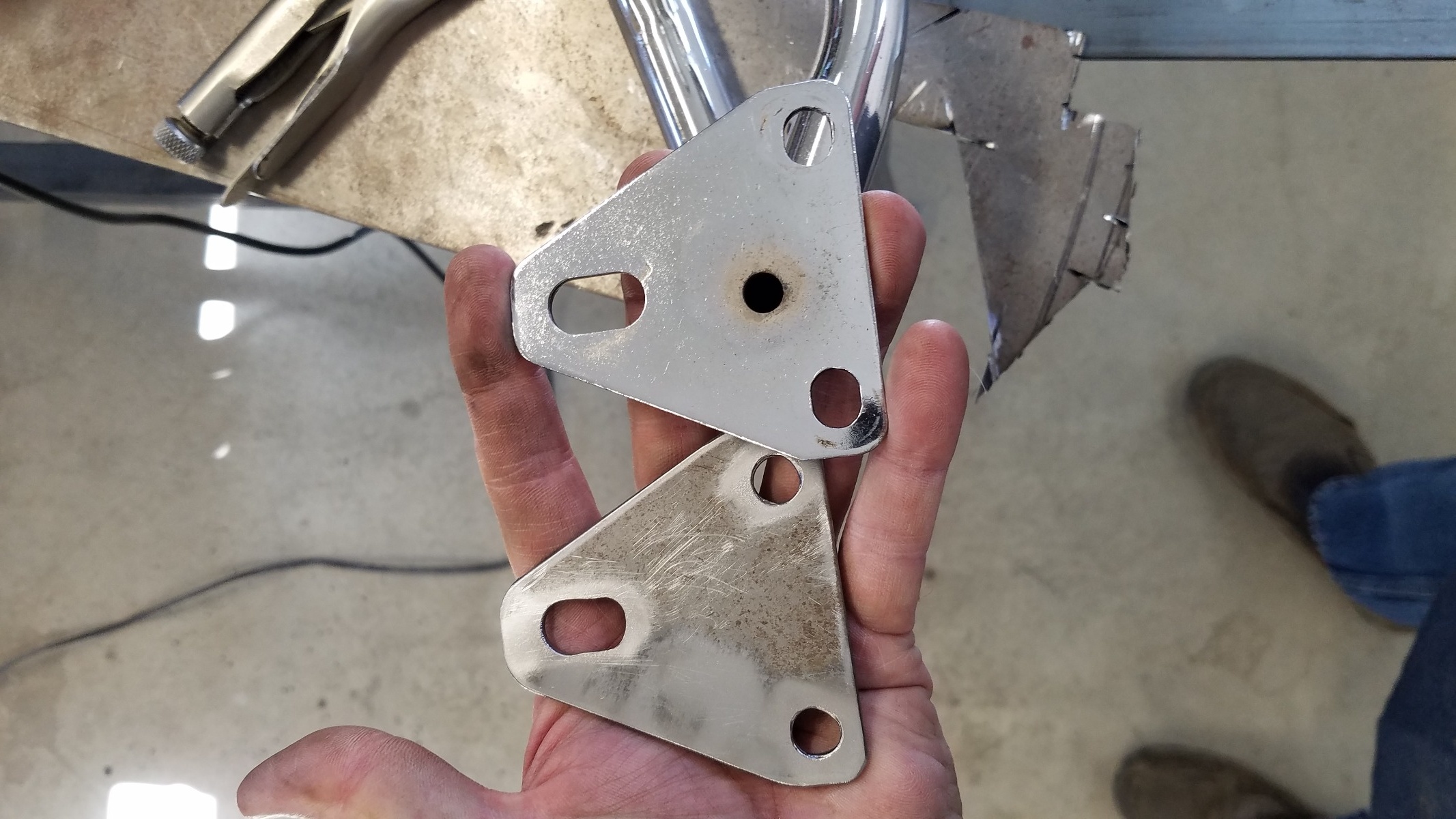

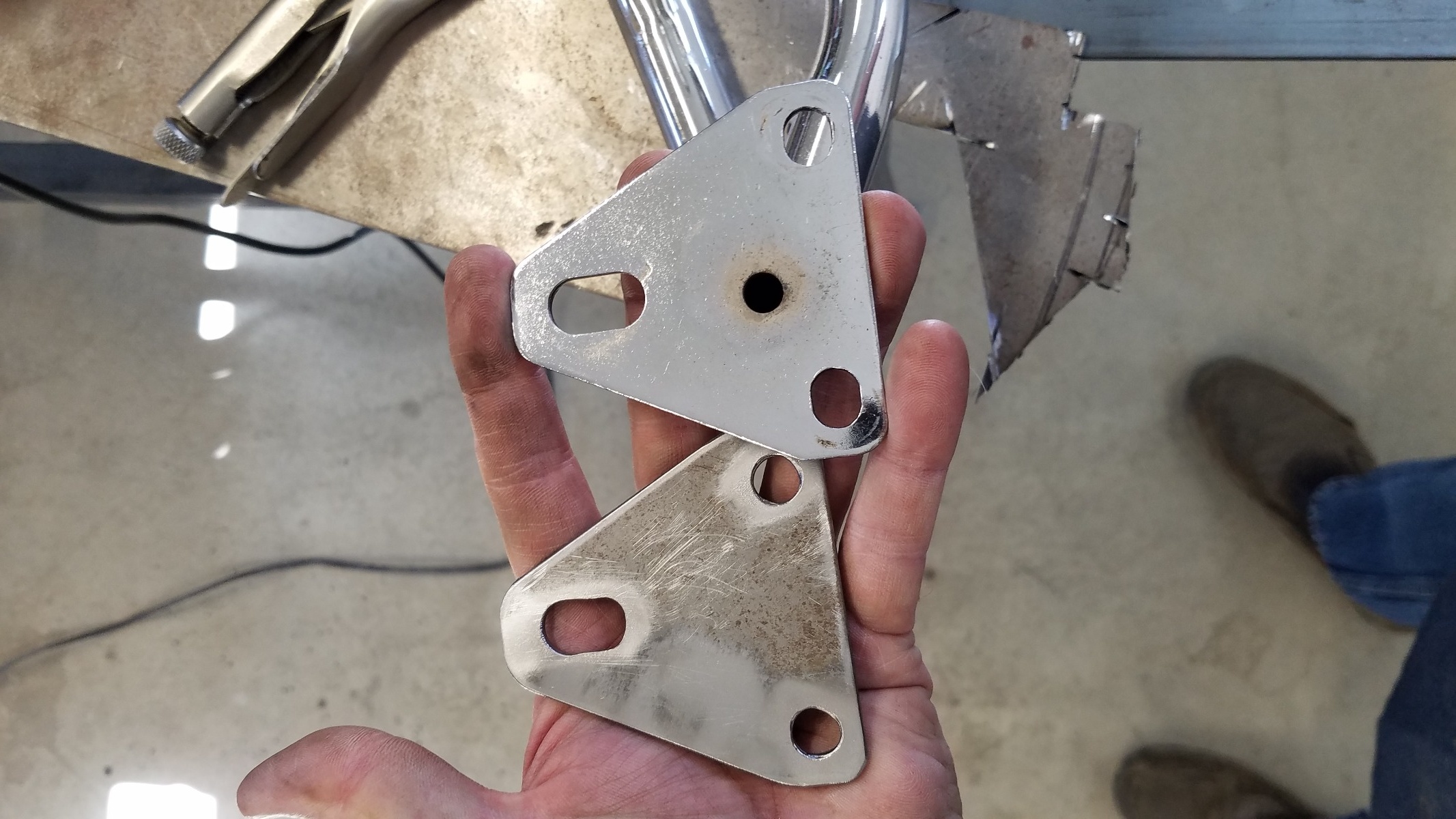

Case Savers. I have been wrestling with this ever since I took this bike apart - use them or not? Since the original hardware and motor mount plate on the right front side are long gone, I was thinking of having them powder coated to match the frame. But the chrome plating is an issue. I cannot find anyone in Nevada or Sacramento that will strip chrome plating. The plating shops I have talked with can apply chrome, but will not strip it. Apparently the chemicals to strip the chrome plating are quite nasty and the government regulations in controlling them have forced the businesses to quit using them. Since bead blasting it off is too time consuming, I decided to run without the case savers. I had to order some new bolts and make the engine mount plate for the top right side.
