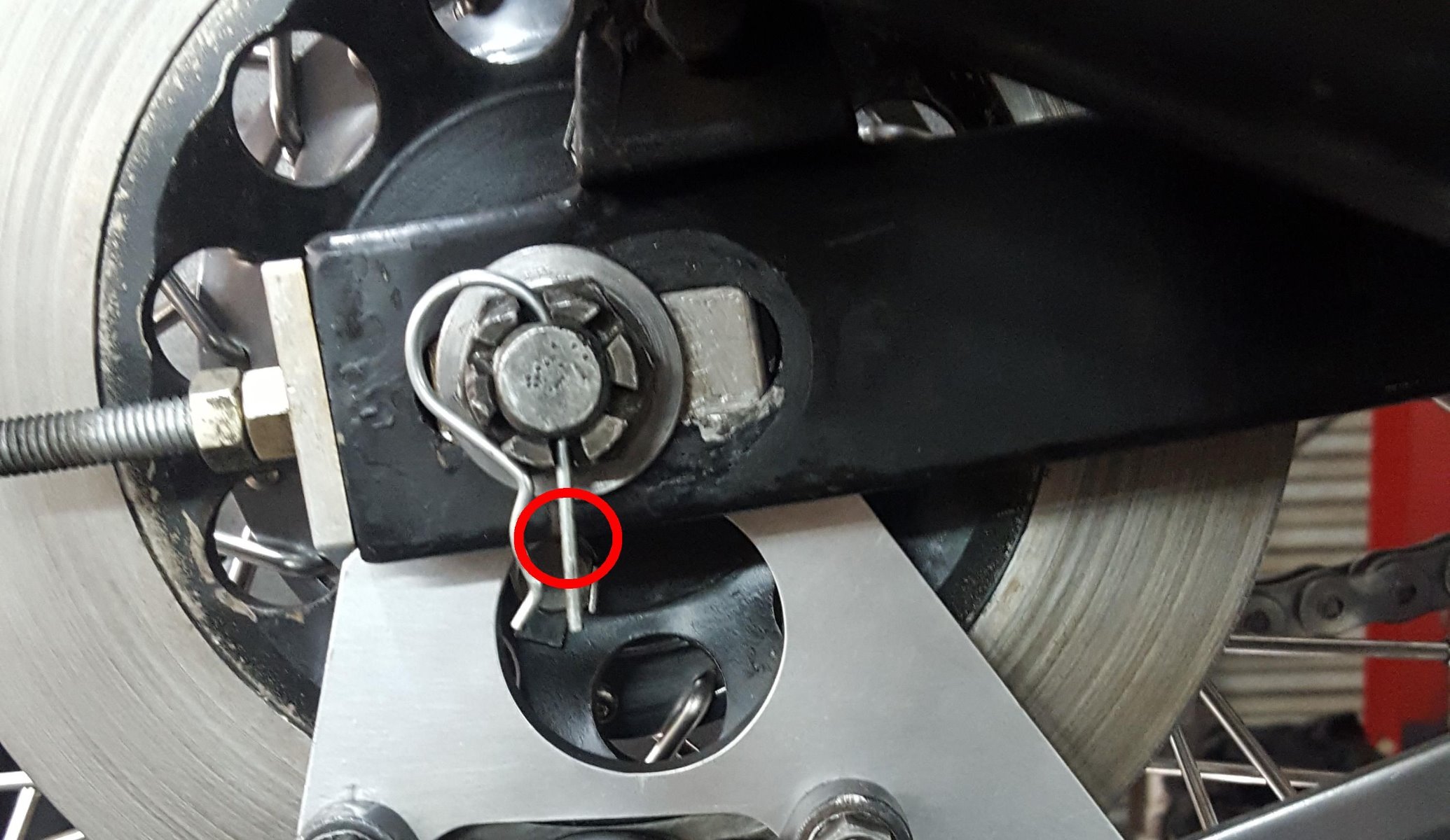

Just a Little hint Move0ver
The clip for the crown nut has to be in this position for max. sping tension.

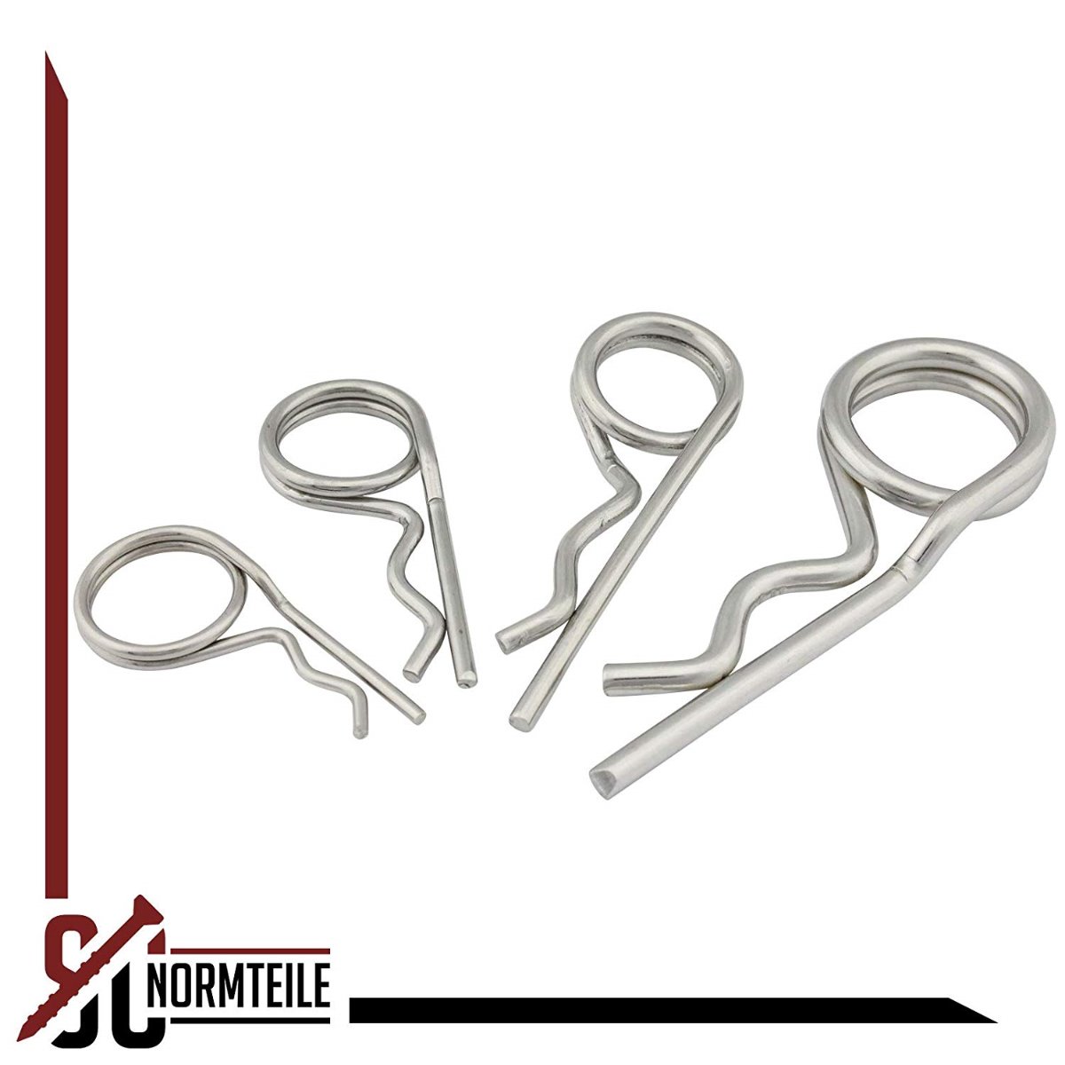

I use clips with an extra loop form more Tension

Good catch Scirocco, though I'd imagine having the clip either way would fulfill the intended purpose...
