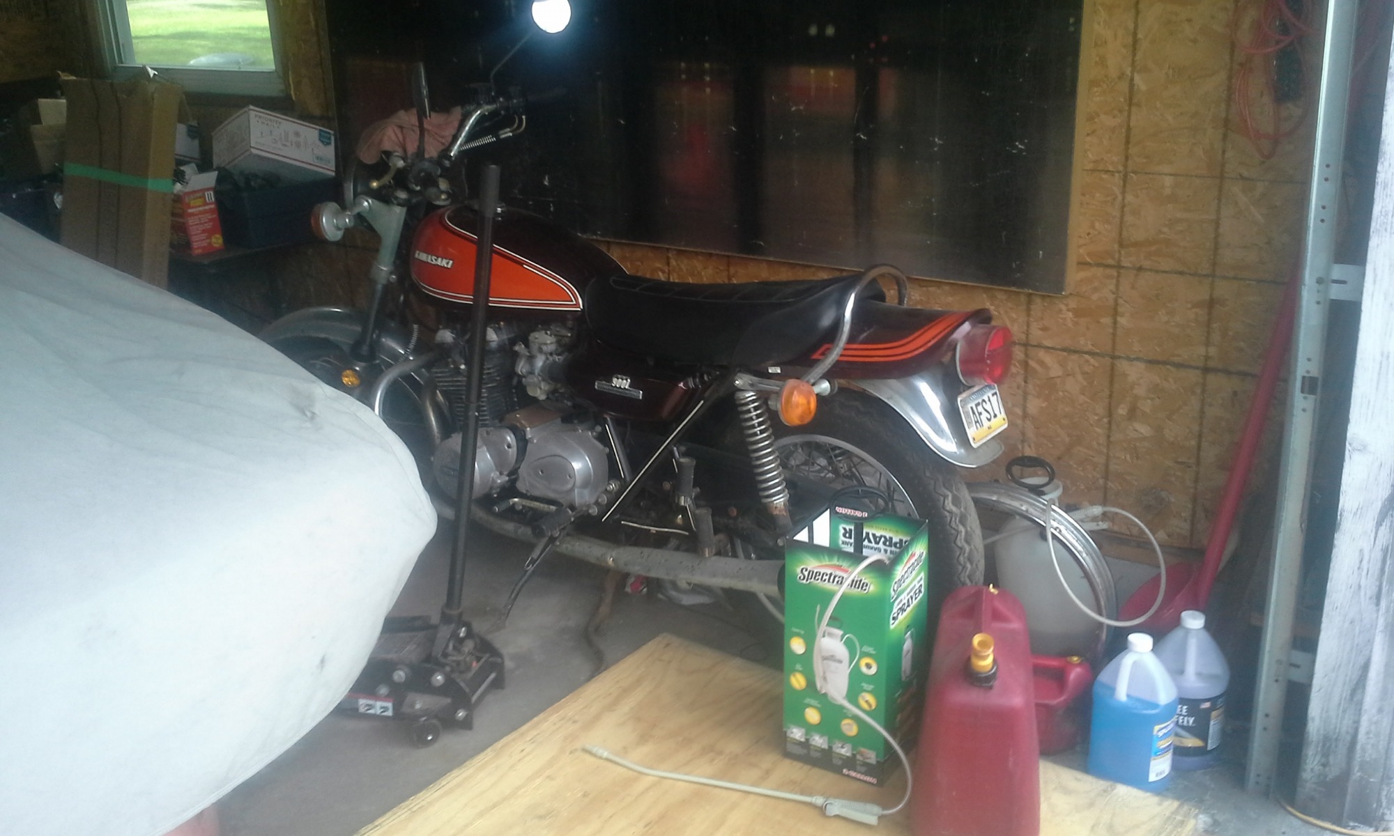

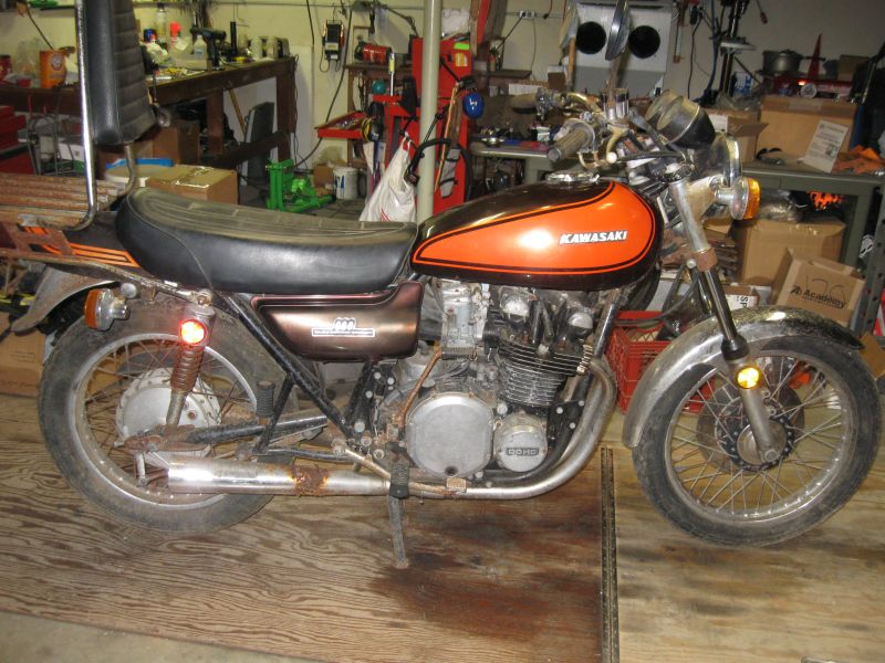

This thread will document the recently acquired 1973 Z1 project we've named The Wounded Z.
After sitting in a barn for over half it's life, it was freed and treated to a two-week-long cross country ride on various 18 wheelers, arriving in Kentucky on 8/9/2018.
Ser# Z1F-168xx
Motor # Z1E-16746
Mfgr. date 6/73
Not sure what to make of the serial # spread, motor vs frame. Looking at the Z1 registry database, numbers of some of the '73 Z1's in the mid-to-high teens are all over the map. I see no obvious indication that the motor and frame are not those originally mated at the factory. Or, perhaps the motor was replaced under warranty?
We know almost nothing of it's history. Last licensed in 1986 somewhere in the Pacific Northwest, it was apparently abandoned in said barn for three decades, a situation both blessing and curse. Curse, in that languishing untouched allowed time and humidity to slowly chip away at it's carcass with the inevitable results; slow death by a thousand wounds. Blessing, in that whatever protection was to be had while in the barn supplied a modicum of protection from the direct action of the elements and, being out-of-sight, out-of-mind, kept it from being molested and cannibalized.
Everything is present except the owner's manual, tool kit and key. We have a correct # key on the shelf.

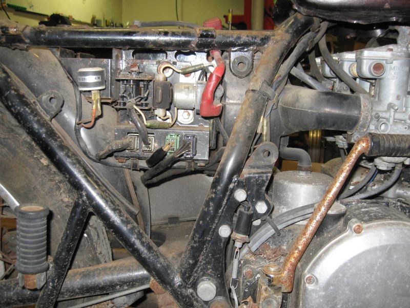

At a glance the bike is a rough survivor.
Not even ten minutes into evaluation, The Lovely Z1BEBE already has designs on it being Her Baby, "casually" mentioning (but with suspicious enthusiasm ... :laugh: ) more than a few times "I'll help you clean it up!". Translation: "Can it be mine to ride? Pretty please??" (Queue up scene from Fellowship of The Ring: “It is MINE, I tell you... My own. My precious. Yes... My precious...”

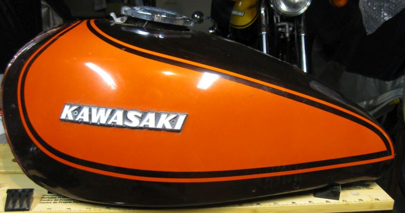

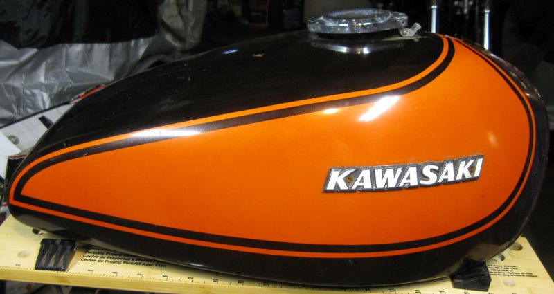

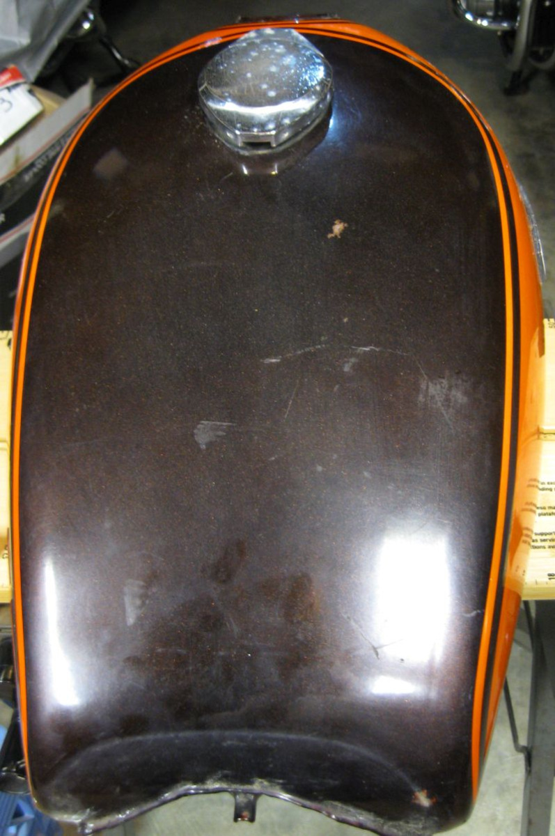

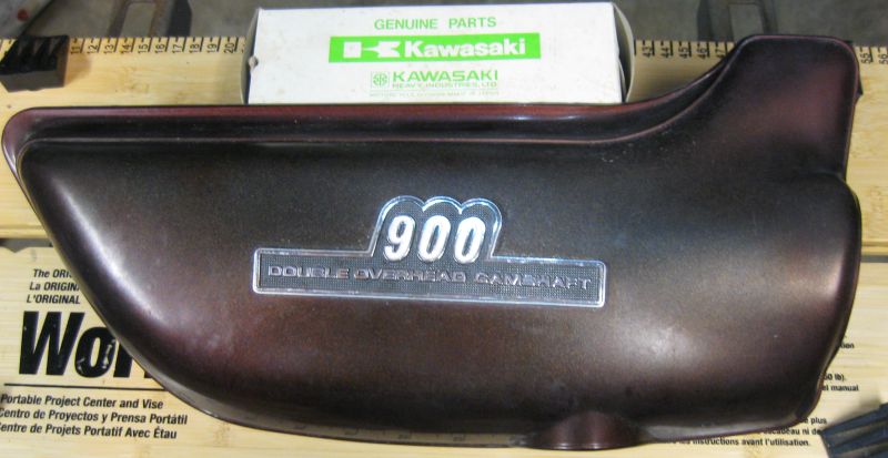

Compared to the rest of the bike, the OEM paint is in amazingly good condition.

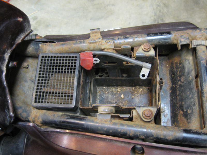

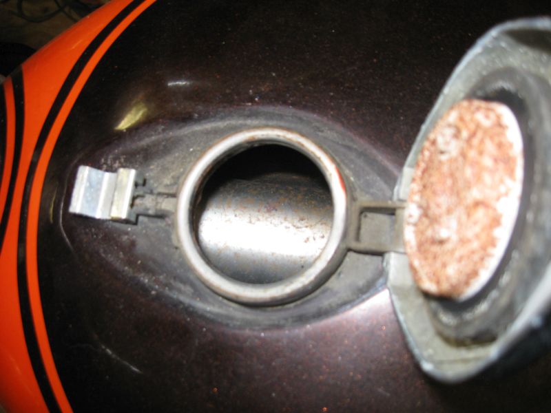

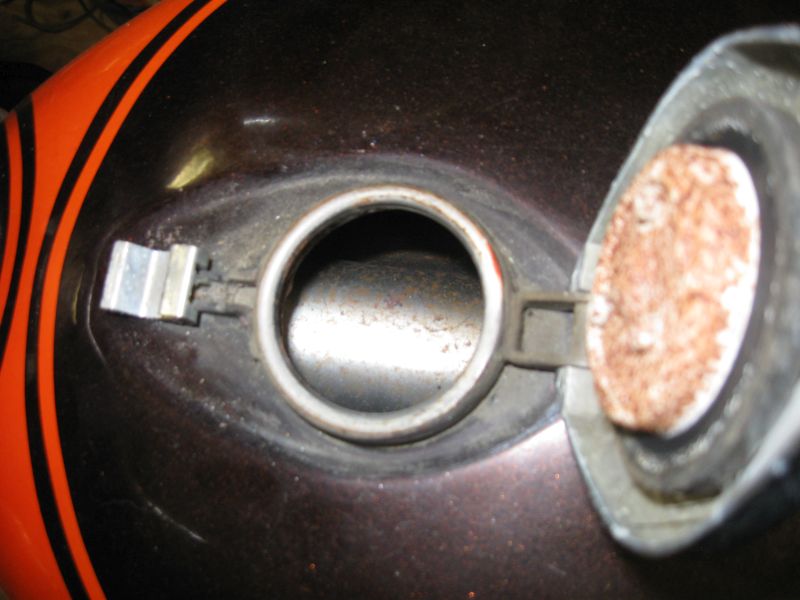

We're really sorta speechless regarding how good the internal tank condition is! I don't have a way to get good pics of the lower rear corners of the tank, but a long, flexible bore light reveals surfaces almost as clean. No loose rust at all! Looks like a fine candidate for gentle electrolytic rust removal with a 12V battery charger and washing soda.

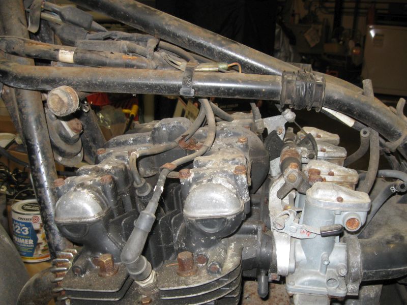

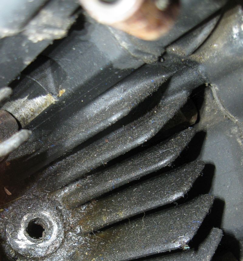

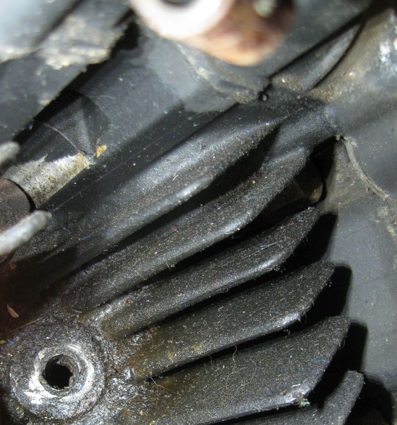

Motor is stuck. We knew that going in. Looks like a broken plug in #3. Hopefully just broken, not seized. All the other plugs are present. Haven't tried to remove them yet. No milk on the sight glass. Oil is plainly visible between the fill marks.

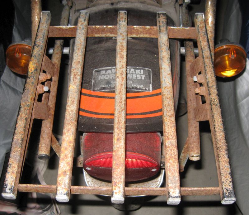

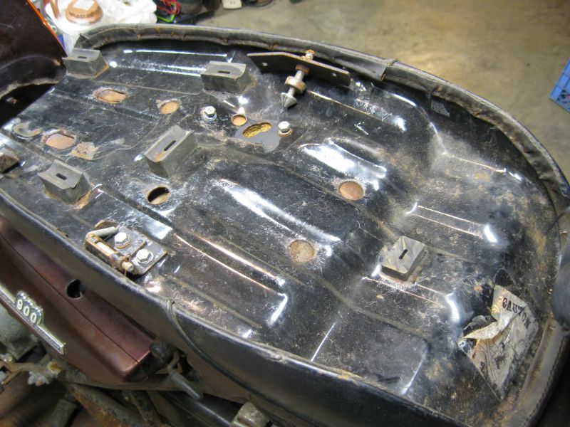

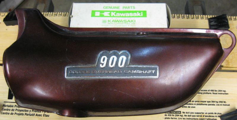

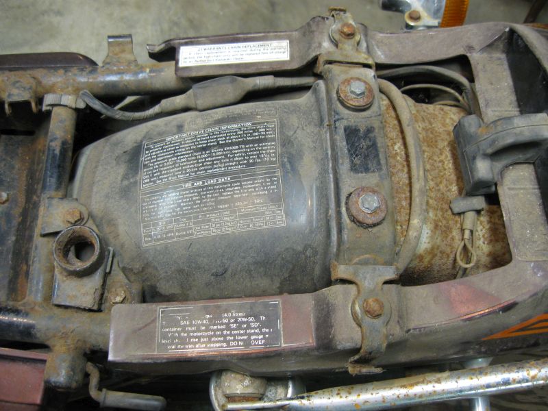

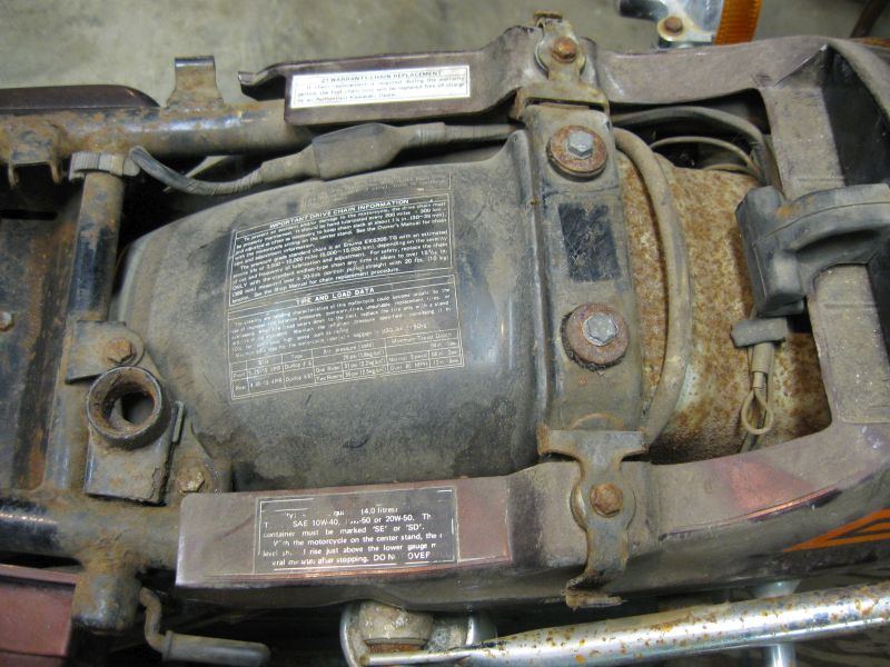

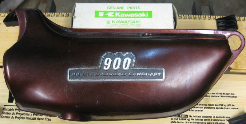

More bodywork.
Sad that the luggage rack notched the tailpiece paint above that 45 year old sticker...
More pics to come...

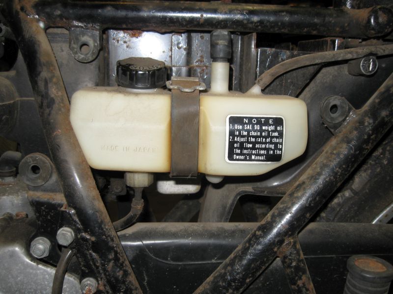

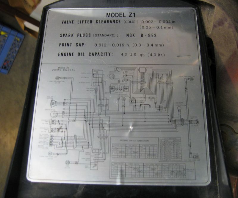

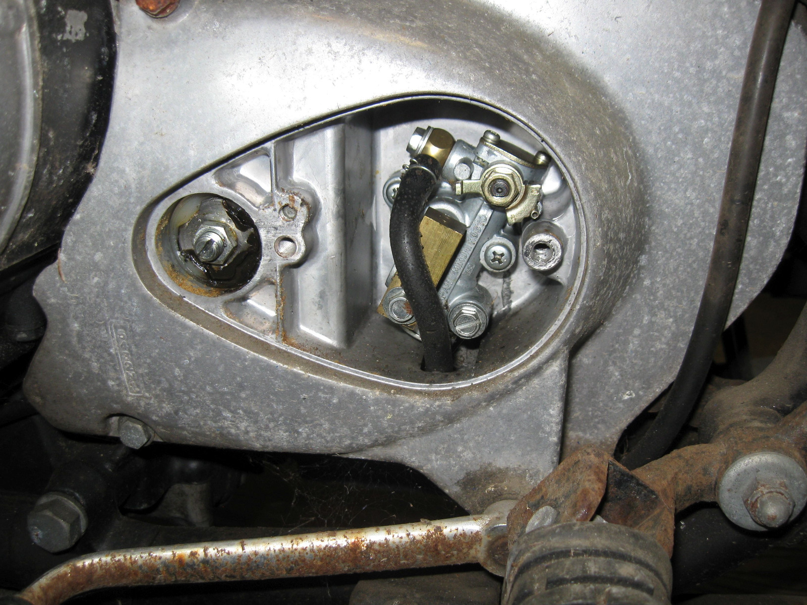

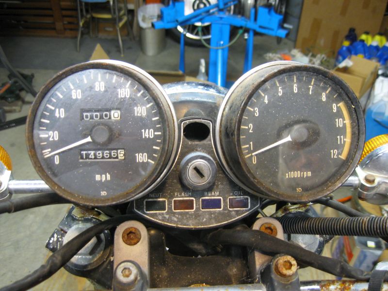

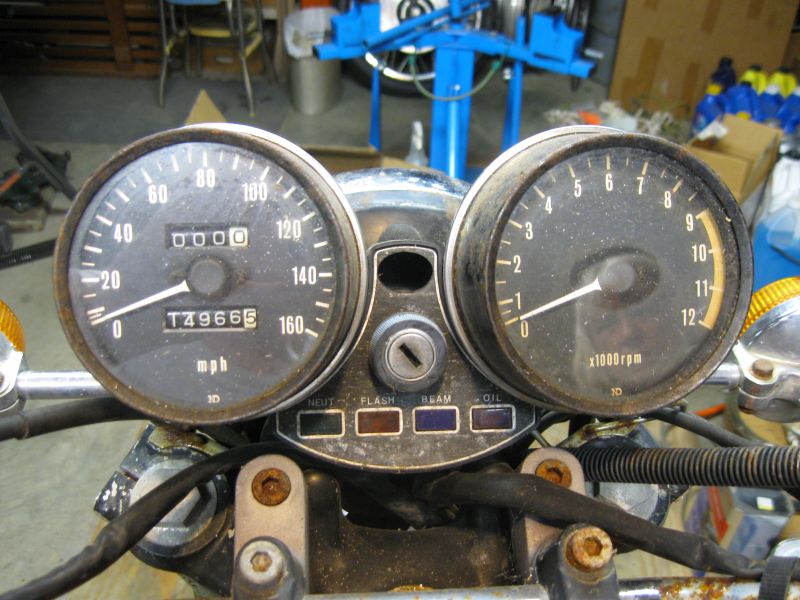

Correct gauges.

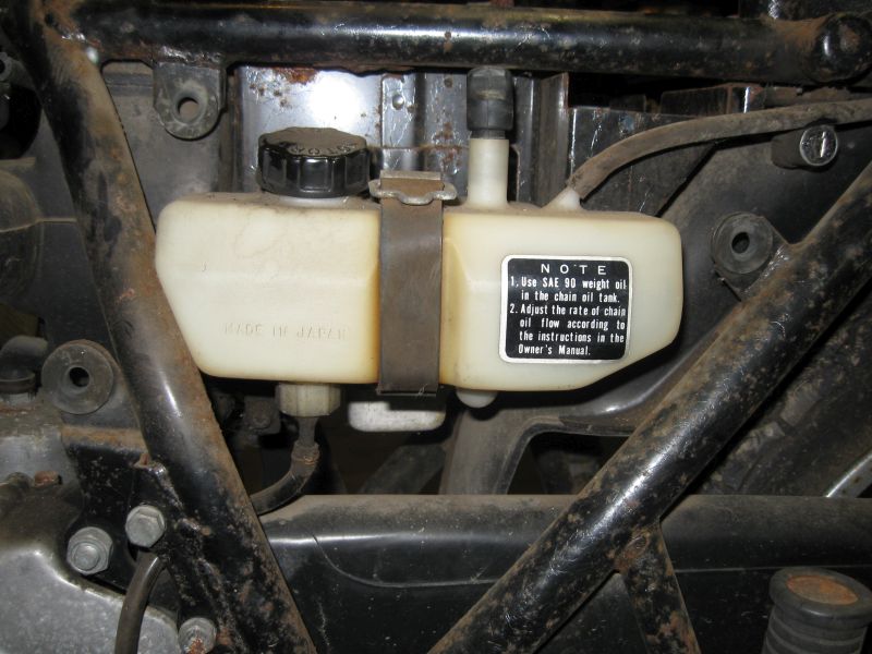

The plumbing for the chain oiler is likely undisturbed. Good reference.
The carb sliders aren't stuck!!

As far as the tail, you might be able to plastic weld in a filler piece and spend some time blending the paint so it's impossible to notice.

OEM '73 and '74 paint was a 5-step process: white-black-flake-candy-top. There is no practical way for "blending" damaged areas into undamaged OEM paint. That's one reason good condition OEM Z1 bodywork is so prized.
