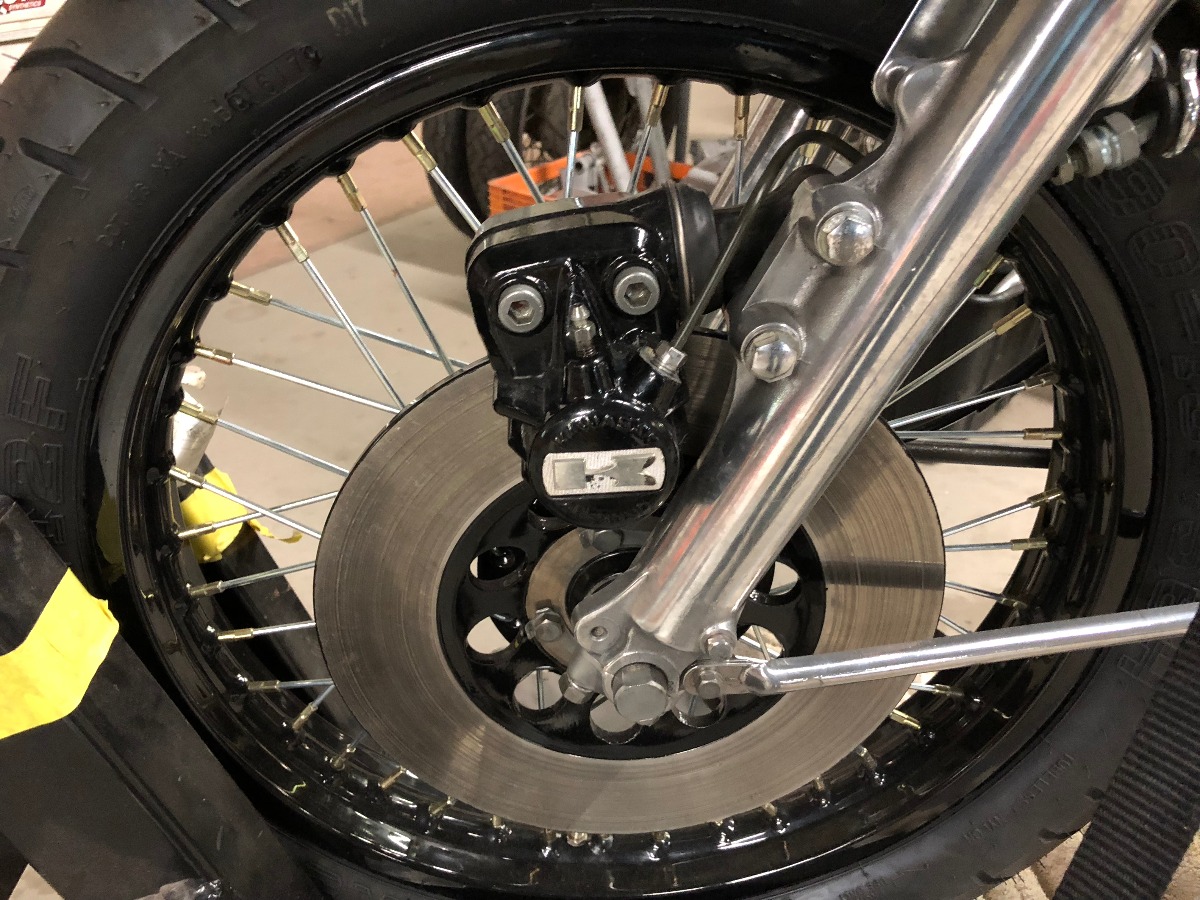

I wanted to give everyone a heads up regarding the pilot jet cap (fig 28 in the manual) Kawi part #16036015 - I ordered two different size caps from Z1 (Rubber Passage Plug - Honda SKU: 100-1319 and the bigger one Rubber Passage Plug SKU: 100-1325) Neither of these fit. Z1 noted that the first one I listed from the Honda is the smallest one they have. I tried to shave the sides down a bit to get it to fit, and ended up ruining it. Its close, but I feel it puts too much pressure on the Main Jet Plate since it does not sit all the way in.
If anyone else has any input on cross referenced Pilot Jet Caps for the early years 400s, I would greatly appreciate it. I need 8 of these. There are a few crooks on Ebay trying to get 30+ dollars a piece for these. I even reached out to one person and offered them 60 for 4 of them and they said no. With all due respect F that seller. Thanks in advance!

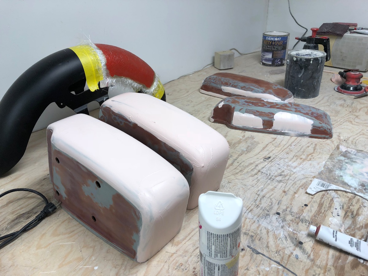

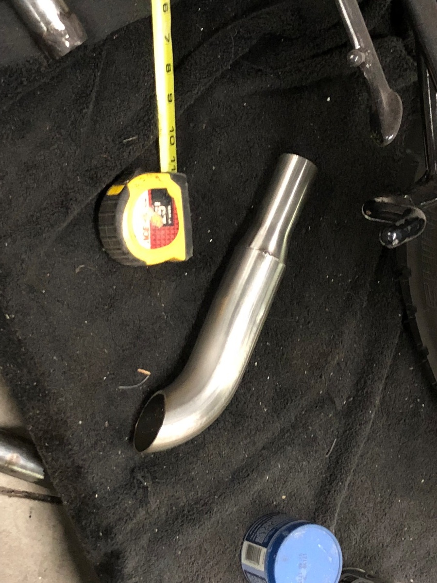

Got some more body work done today, started to piece the mufflers together and get some measurements. Stuck the plate on. I cant wait to hear this start up again!
