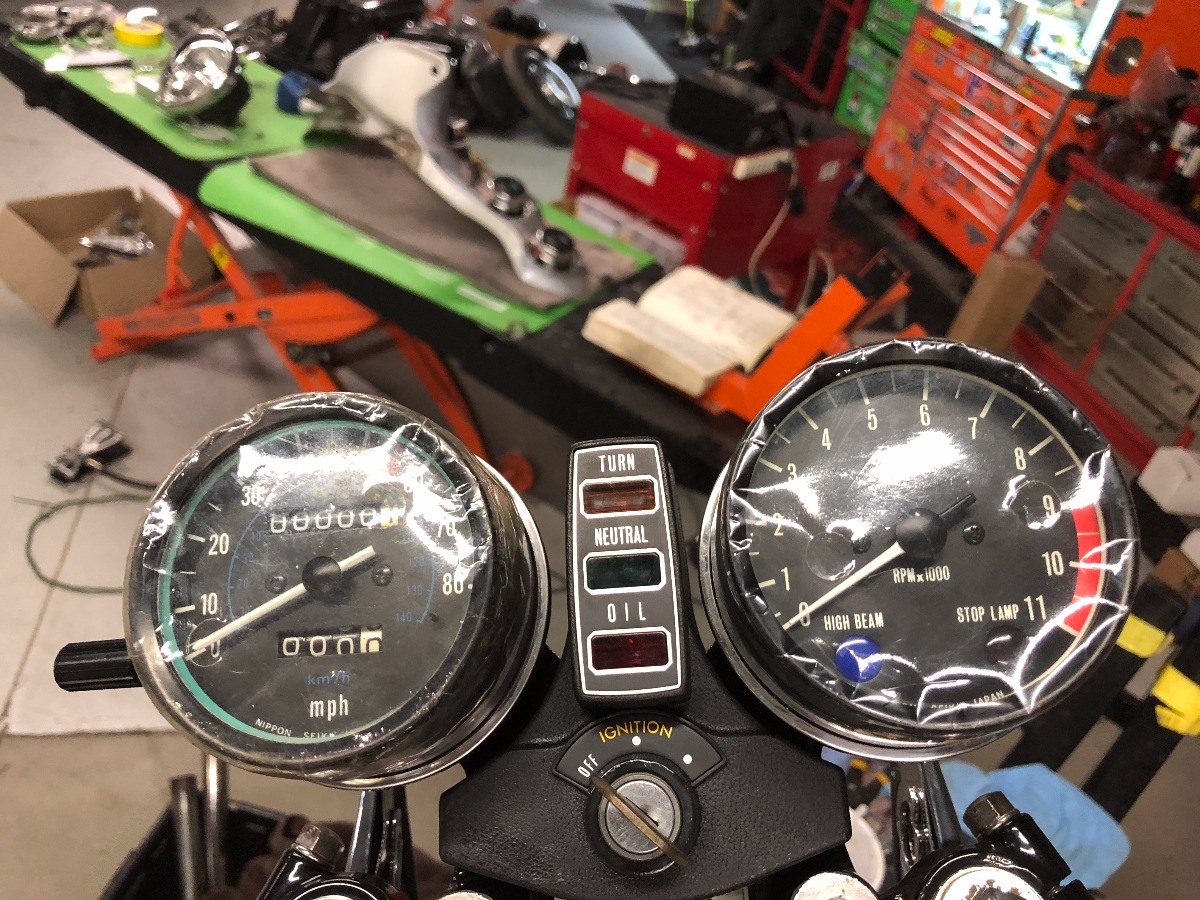

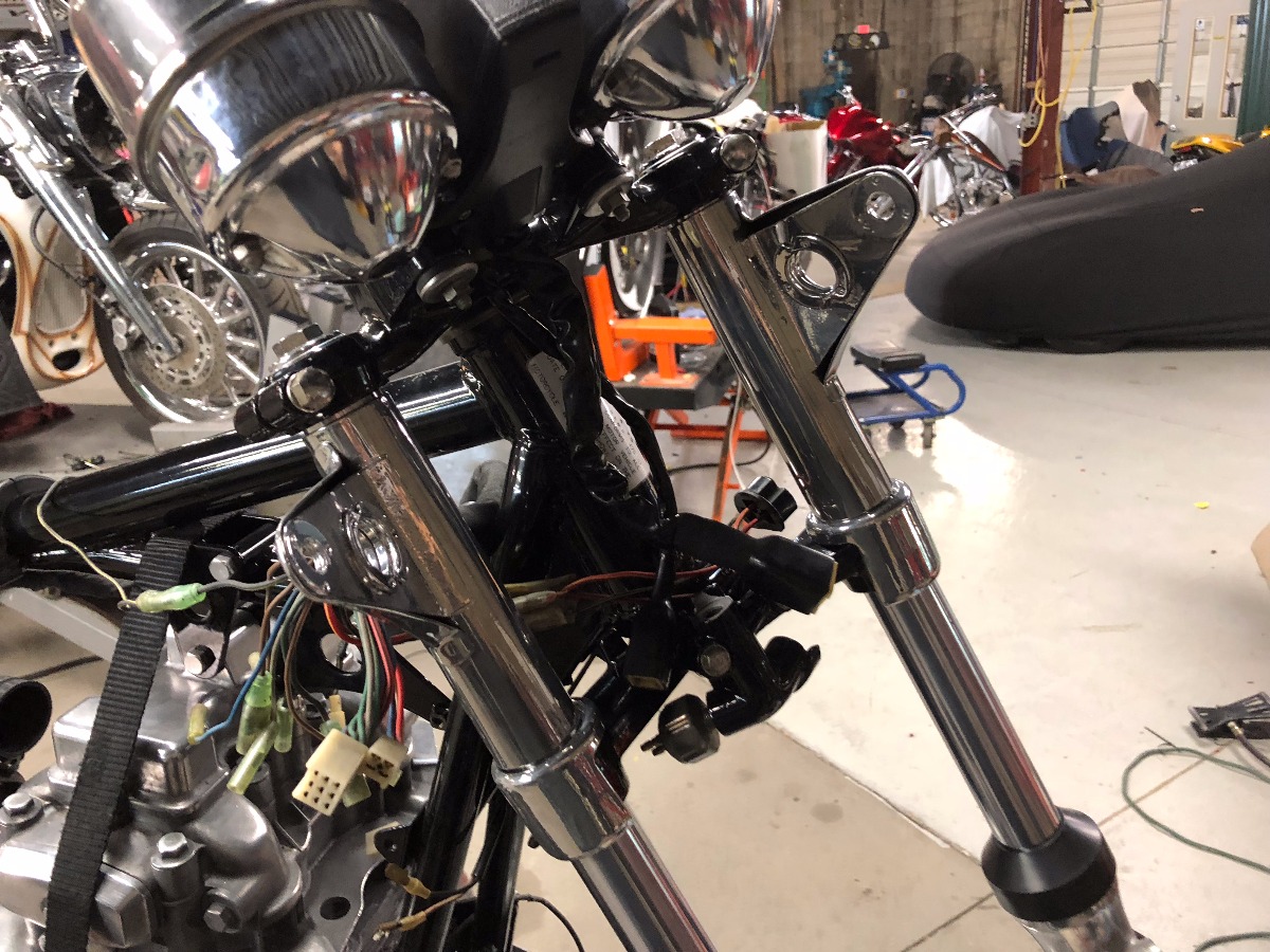

I got the gauges mounted and such on the bike yesterday. Bought a LED headlight, but its a bit small, and wont fit the stock housing properly. Does anyone know of a specific brand or model number for a housing for the standard HD LED type light 7 inch? I seen alot of housings but most mount at the bottom, not on the sides. Trying to keep the stock look, with an updated headlight, behind the fairing.
Had the Vin sticker redone, it looks great! Things are moving right along, should have the rest of the front end done over the weekend.
Also, wanted to say Thank You and Happy Thanksgiving to You and Yours. I am thankful for all the valuable info this forum from members across the globe.

There may be bulb available for the 400 but I never found one that fit the stock bucket. I ended up getting a new Emgo chrome housing with an h4 style bulb.

23 Nov 2017 13:40ThatGPzGuy wrote: There may be bulb available for the 400 but I never found one that fit the stock bucket. I ended up getting a new Emgo chrome housing with an h4 style bulb.
I went with the SpeedMotoCo version: H4 bulb with a black bucket and chrome ring, using the stock mounting brackets, on my '79 400. I did need to shim the mounting bolts a bit, so I alternated flat washers with rubber washers to make up the width (and maybe to reduce vibration).

24 Nov 2017 03:36Jack_Mills wrote: I got the gauges mounted and such on the bike yesterday. Bought a LED headlight, but its a bit small, and wont fit the stock housing properly. Does anyone know of a specific brand or model number for a housing for the standard HD LED type light 7 inch? .
There is [ or was ] a headlight available for a small Honda that is a direct replacement for the KZ400/440 with an H4 bulb.
The KZ400/440 uses a 6 1/4 in. headlight assembly.
