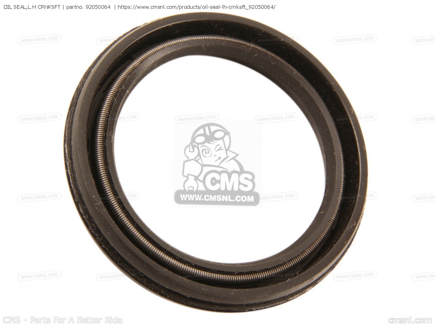

18 Nov 2019 12:08loudhvx wrote:
For some reason, I can't find that crankcase oil seal on any fiche, not even for the 2nd gen Kz400 motor cases. Sometimes there is a note next to an oil seal which says whether the cases have to be split to replace a seal. I was actually looking for that note, but I can't even find the actual seal on the fiches.
Maybe someone with more coffee on hand can find it.
part# 92050-064
www.cmsnl.com/kawasaki-kz400d-1975-canad...050064/#.XdL3DrmWw_w

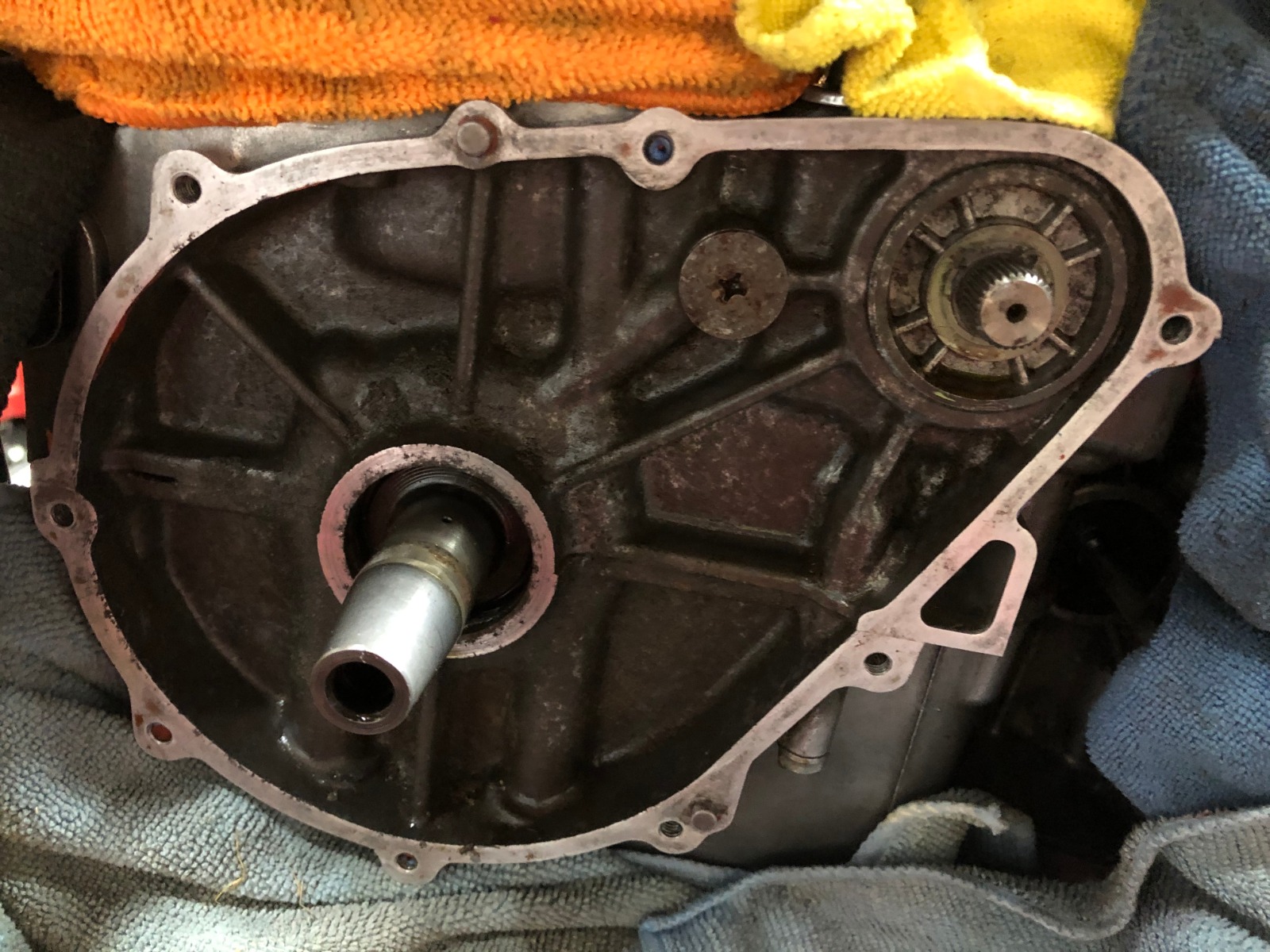

Started the seal job and realized I didnt have the proper puller, so I ordered one. When I took the left side dynamo cover off, it was full of oil. Looks like it was leaking at the wire rubber and there mustve been so much oil in there that it was pushing through the starter area and dripping out of the bottom of the starter drain above the sprocket. Thanks for the link to the inner oil seal...Im pretty sure that requires the bottom end taken apart and Id rather have a little bit of oil leaking than to tear this motor down again haha!

I wonder if a drain hole or two could be drilled in the earlier cases without damaging any thing? I reckon the cases would have to be split in order to remove drilling debris.

Also, beware, that bolt holding the rotor is left-hand thread. The bike I was working on had the bolt sheared off in the crank since the previous owner obviously didn't read the manual.
(The puller is right-hand, normal, thread.)

19 Nov 2019 16:44TexasKZ wrote: I wonder if a drain hole or two could be drilled in the earlier cases without damaging any thing? I reckon the cases would have to be split in order to remove drilling debris.
The hole can be drilled right in the center directly below the crank.
This is where the later engines have it. But the hole WILL be a two-way street.
That should not be a problem thou.

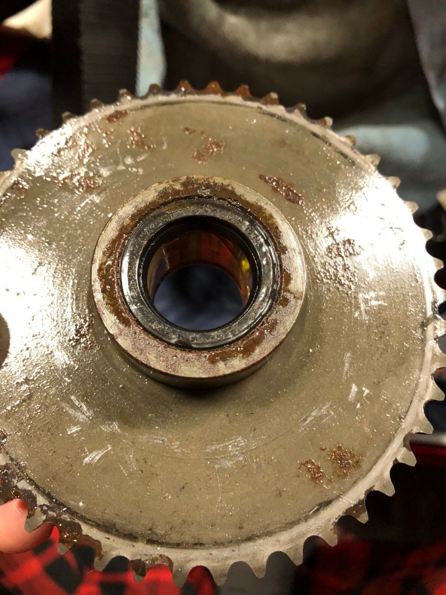

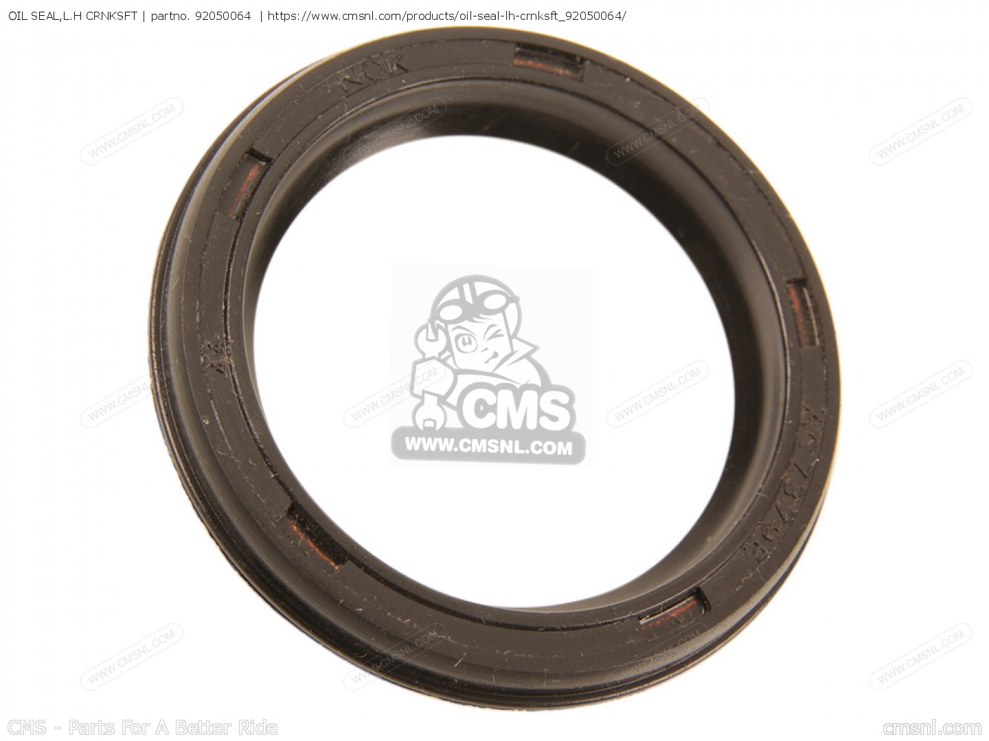

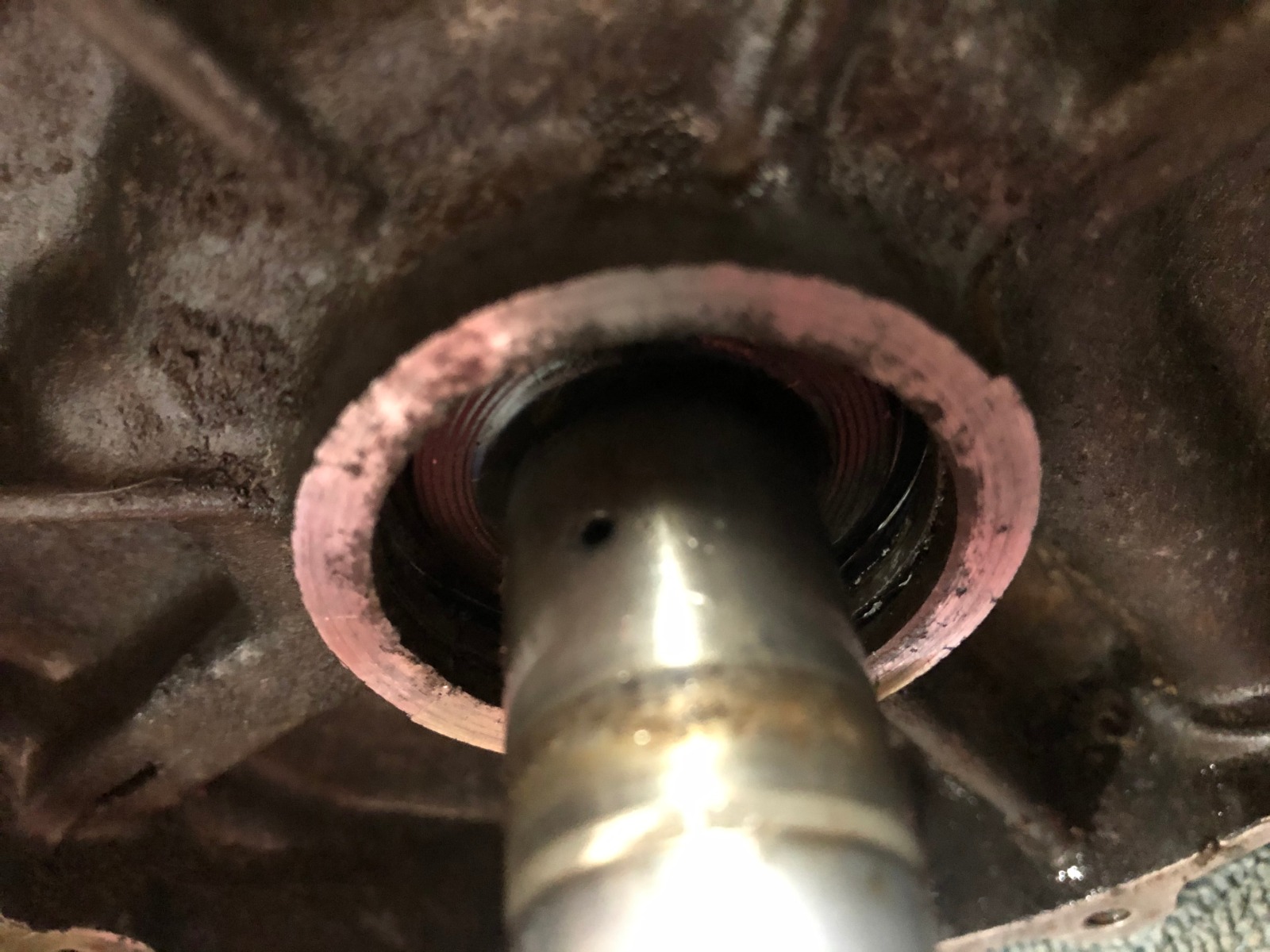

So Ive got the left side torn down. Comes to find out there are 2 seals. The outer seal was ok but the inner seal was totally shot.
The outer seal (which is mounted on the front starter sprocket) is Kawi # 92050-066
The inner seal (which is mounted on the inner case) is Kawi # 92050-064
Both seals are accessible without tearing the motor down.
Ive gotta clean the area up here in a bit, and wait for the other seal to arrive. Have a good day!
