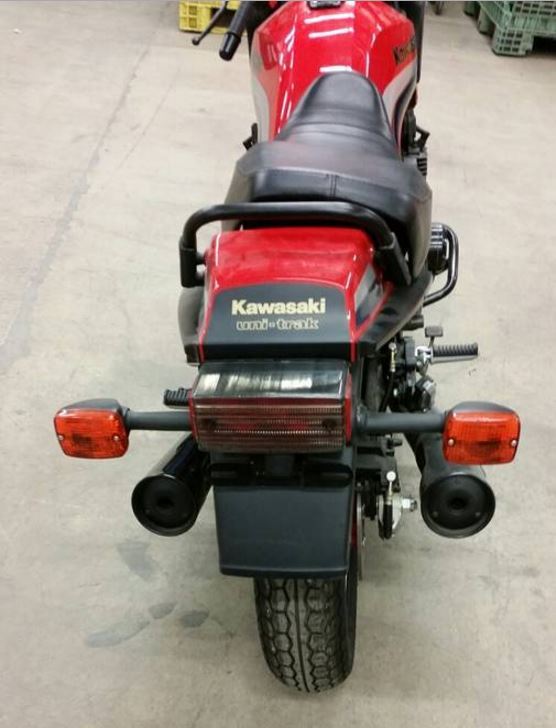

I'm thinking to paint bike like the mk2 in this picture, although mine probably never was this color originally. As you can see, now it's a lovely mix of black and burgundy
Gonna paint the engine too, so guess I'm taking it apart. The top end is already in pieces so what's to keep me from getting the engine out and splitting the cases.
I still should have original airbox somewhere, it came with the bike. Although I already have bought expensive K&N Pod filters for it, maybe for original look I should go with the airbox?

I like the red. You can get the pin stripes. I'd keep the air box and sell the K&N's.

Yeah that red is really gorgeous with the yellow flake pinstripe. Just need to get some more reference photos so I can nail the correct color for it. I doubt I can get that same paint anymore
Did the original mk2 have 4-2 exhaust? I currently have 4-1 Vance&Hines on it and it might be that there's no budget for new exhaust system at least for now, but I'm not in a hurry with this project so I can get parts every now and then.

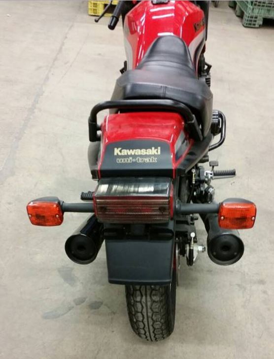

Another nice red mk2:

Stick with the Vance & Hines as a start. Original exhaust can be pretty expensive.
