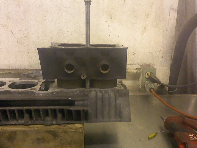

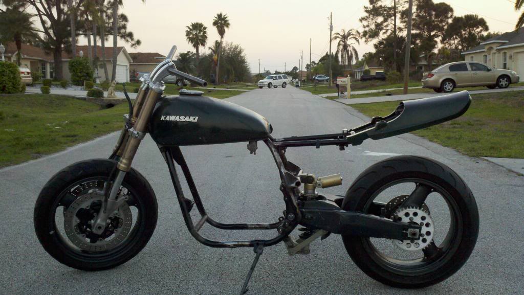

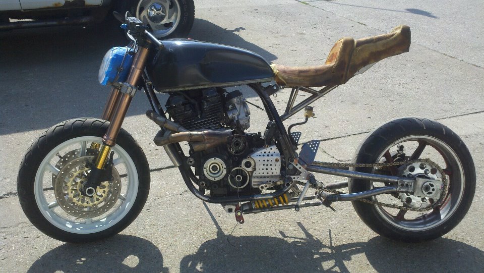

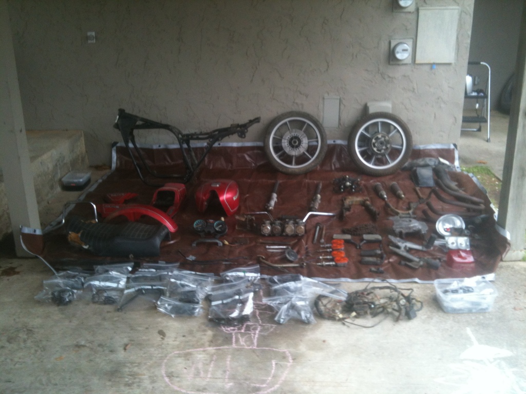

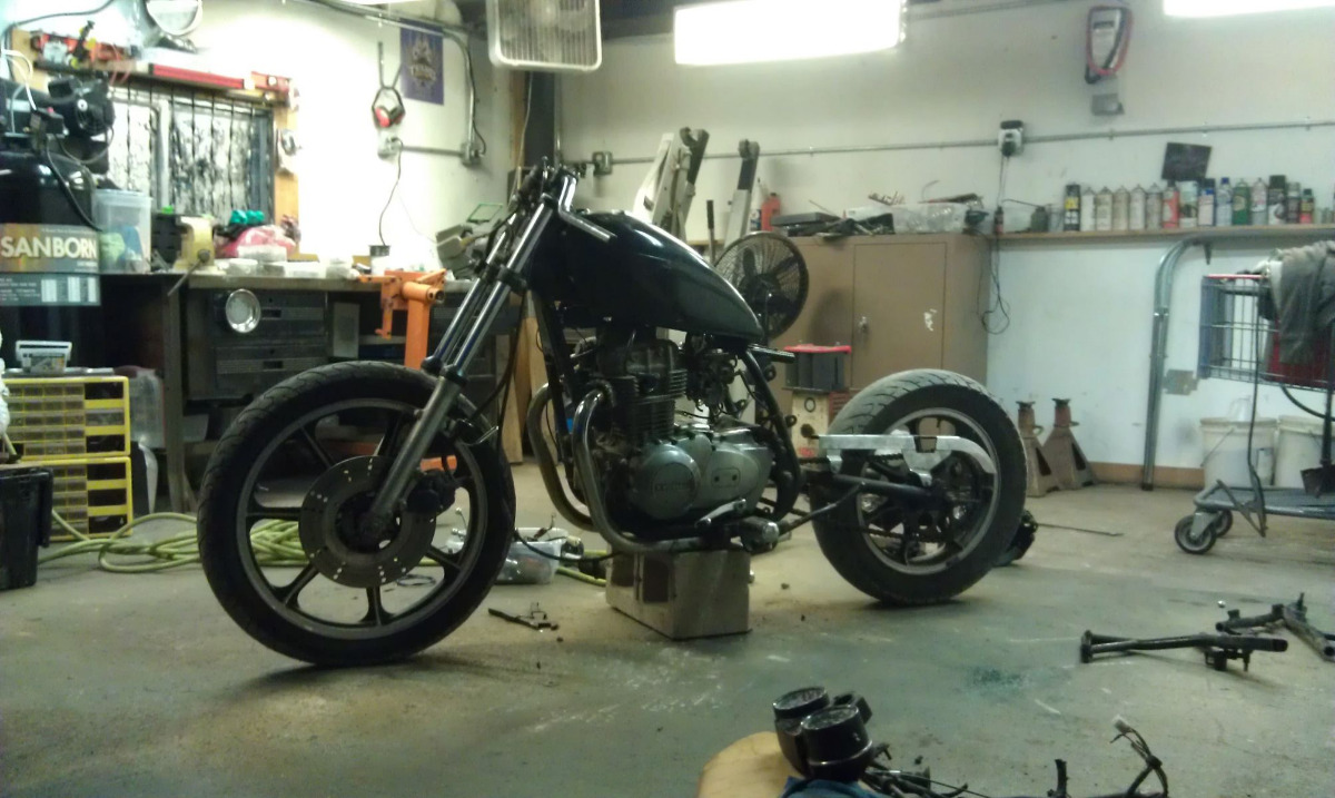

EXACTLY! Below are just 4 examples out of dozens I have seen on this site over the years. In each case the new owner was positive he was going to make his dream bike, but you can see the results. It's very, very easy to get in over one's head because every change made causes issues that then require more changes. BTW, the very worst case was the guy in Norway who totally destroyed a totally stock Eddie Lawson Replica before he even bothered to find out that it was a very valuable bike. When he was done it ended up being scrapped - motor and all was ruined. UGH! Ed
...and then there's the guy who was going to blend a water cooled Suzuki engine with an air cooled KZ engine! Hardly a big success!
