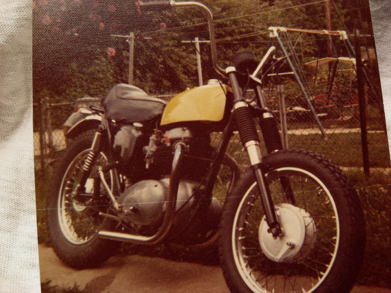

My goal is to look something like the attached. It looks like he's running a taller rear tire on the stock 16" wheel? Any guess on the rear suspension setup? Are front forks/height stock?

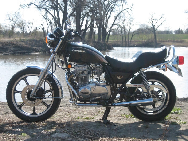

I've also included a pic of my bike.

I notice the bike in your picture is missing the front fender. That's good idea too. That fender only helps stiffen the front forks (as would a fork brace) to improve handling and keeps road slop off the rider and engine. You won't need it.
