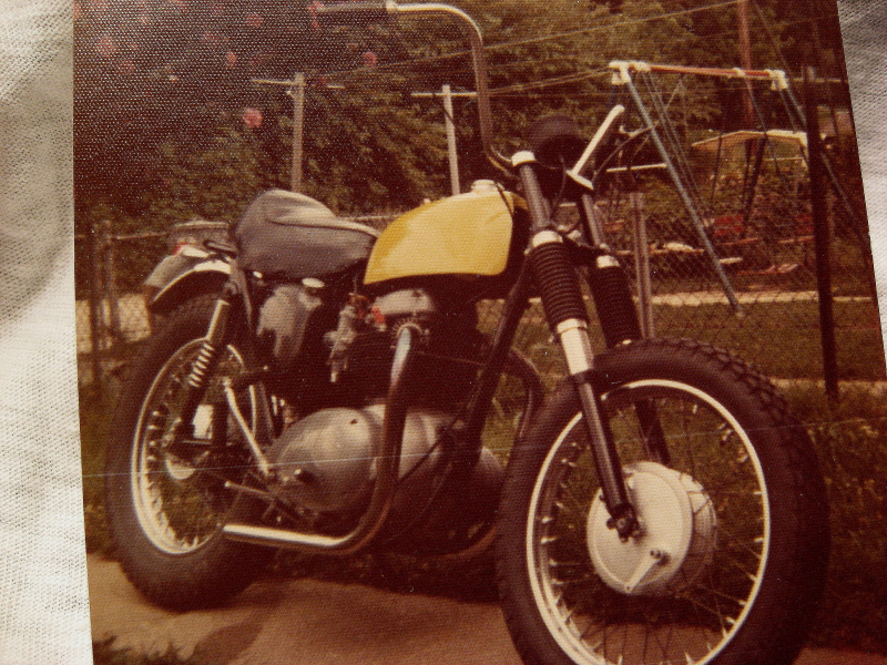

My goal is to look something like the attached. It looks like he's running a taller rear tire on the stock 16" wheel? Any guess on the rear suspension setup? Are front forks/height stock?

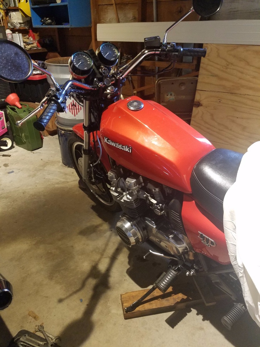

I've also included a pic of my bike.

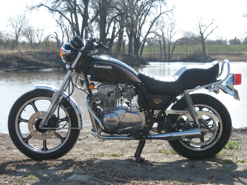

I once had a 440 ltd similar to your bike, bit smaller and only 2 cylinders.
I never liked the LTD handlbars, I put "Euro" style bars on and found I liked that much better. It also changed the look of the bike. It requires replacing all of the control cables woth ones the proper length.
