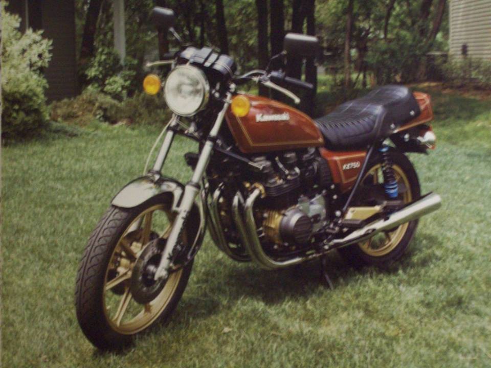

I love what you did with your KZ750E. I followed your build for a long time. Congrats on making BOTM!!!! I built a KZ750E back in the early 80's. I used many of the same parts you did. The GPz feetpegs, and the oil cooler were the same exact parts that I used on my E model. Your build brought back more than a few memories.
I road raced mine in a few WERA endurance races back then. I parked it when the Honda Interceptor came out in '83. After that it became my primary streetbike. Gold wheels were my trademark back then as you can see in the one photo.
