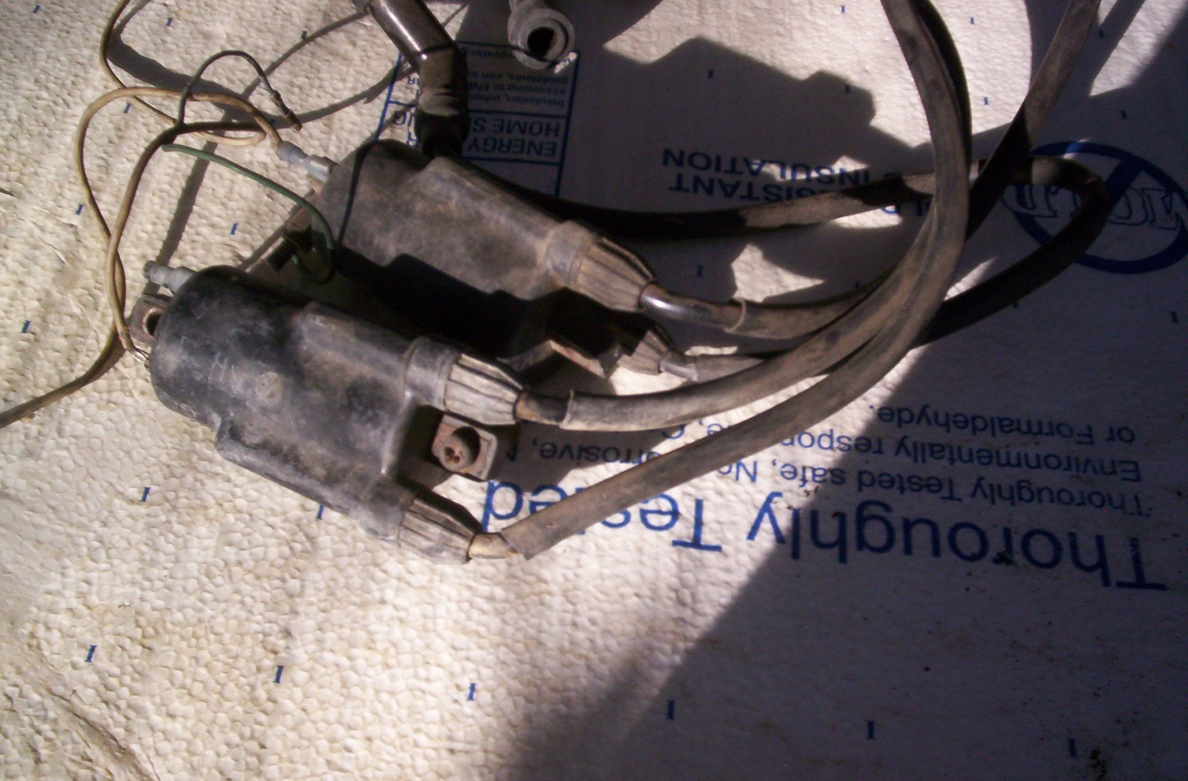

I do think coils as well as the symptom (loss of power) appears to be drooping two cylinders. To be satisfied, just get both new, that rules out that problem in the future. 2nd, you may find phosphoric acid better than muriatic as it is less caustic and easier to dispose. Also if left too long the acids will expose every rust pinhole you ever had in the old tank. I used KBS Gold Standard coating and the stuff was great. R

26 Oct 2016 11:01rrsmsw9999 wrote: I do think coils as well as the symptom (loss of power) appears to be drooping two cylinders. To be satisfied, just get both new, that rules out that problem in the future.
Man, I absolutely HATE the idea of replacing the coils in the hope that MIGHT resolve the issue.

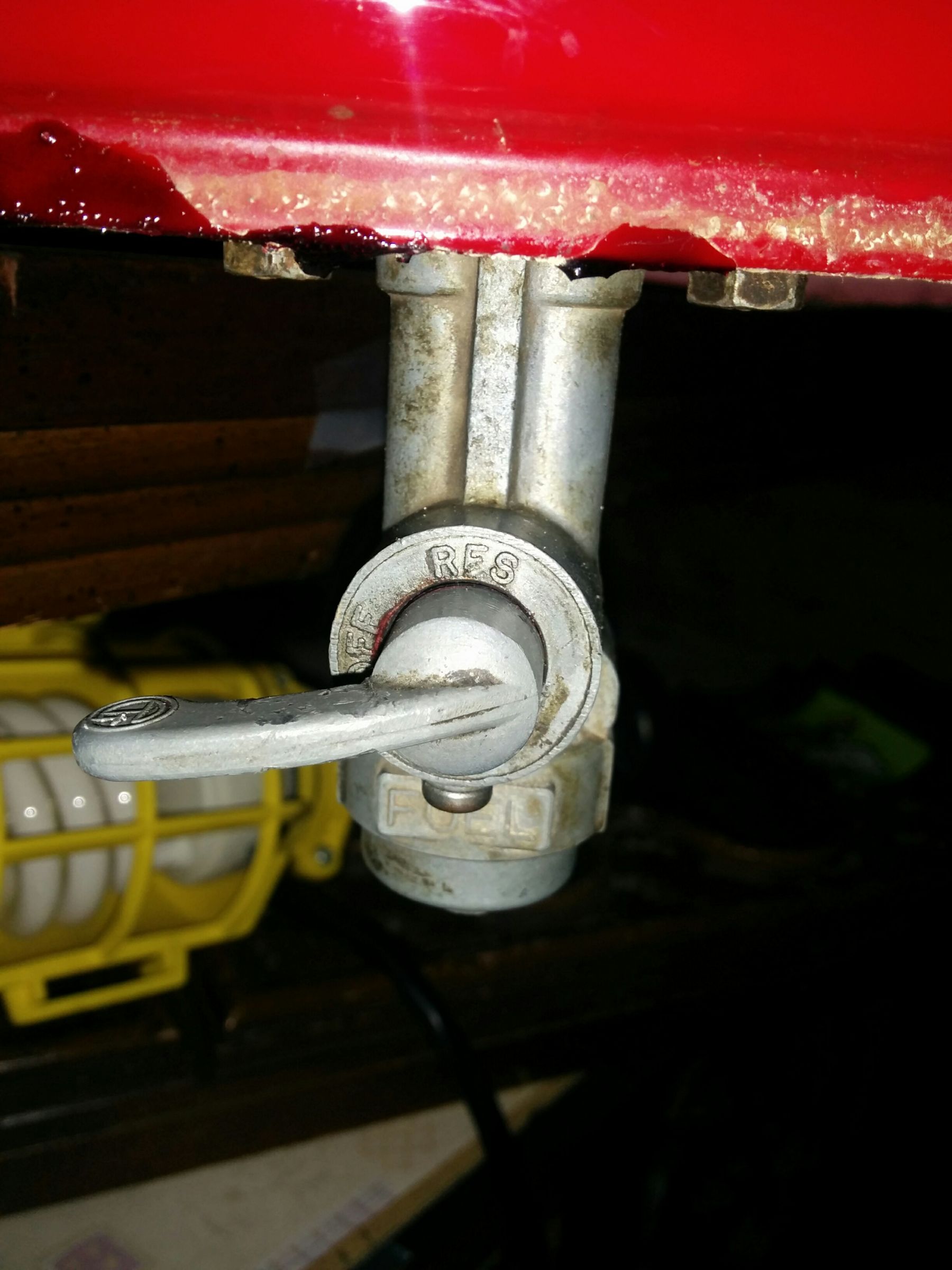

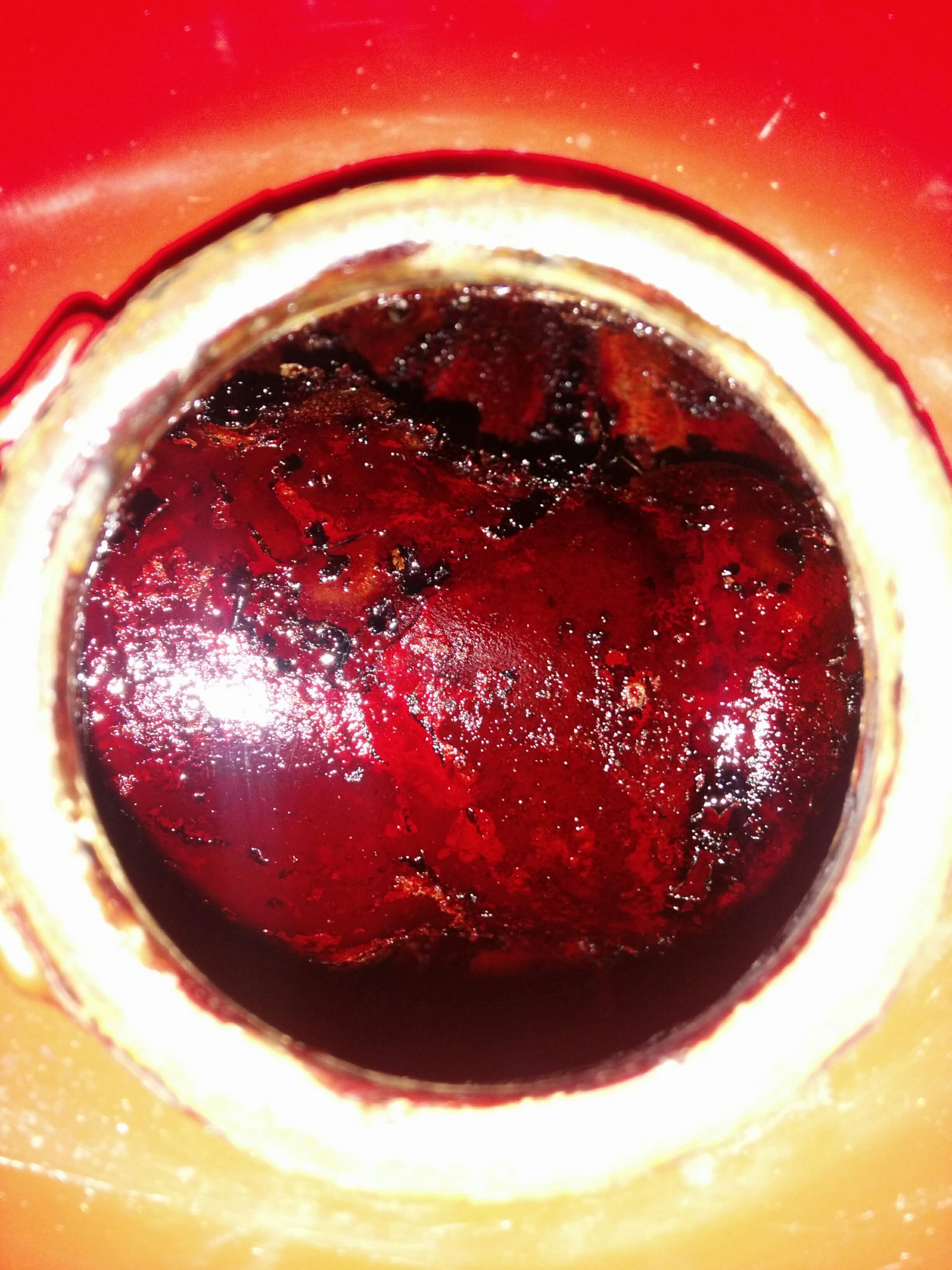

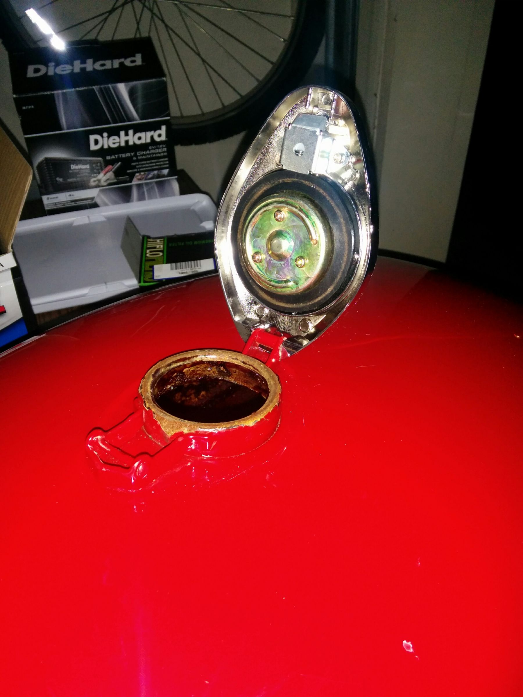

In our last episode, I'd decided to start working from the top down, starting with the tank.
I found a new cap on ebay for 38 bucks, so I got one.
Next I pulled the petcock. The strainer was all clogged up with crap. Got Turbo Rick to rebuild the petcock. He said the spring was bad. It's smooth as silk now.
The crap in the strainer was tank coating that was coming off. I needed to not only clean out the rust, but to strip off the old tank coating, too. I treated the tank with muriatic acid twice. Then I cleaned it out twice with acetone. Finally, I put the Red Kote to it.
The Red Kote directions say it should cure in a day, or so, but, if you can still smell it, it's not cured yet. I let it cure for nearly a week, setting it out in the sun every day. I could still smell it, but I figured if it ain't gonna cure in a week, it ain't gonna cure.
I put the tank back on the bike, and replaced the fuel filter. The old one was a lot harder to blow air through than the identical new one, so there was definitely a problem there, too.
