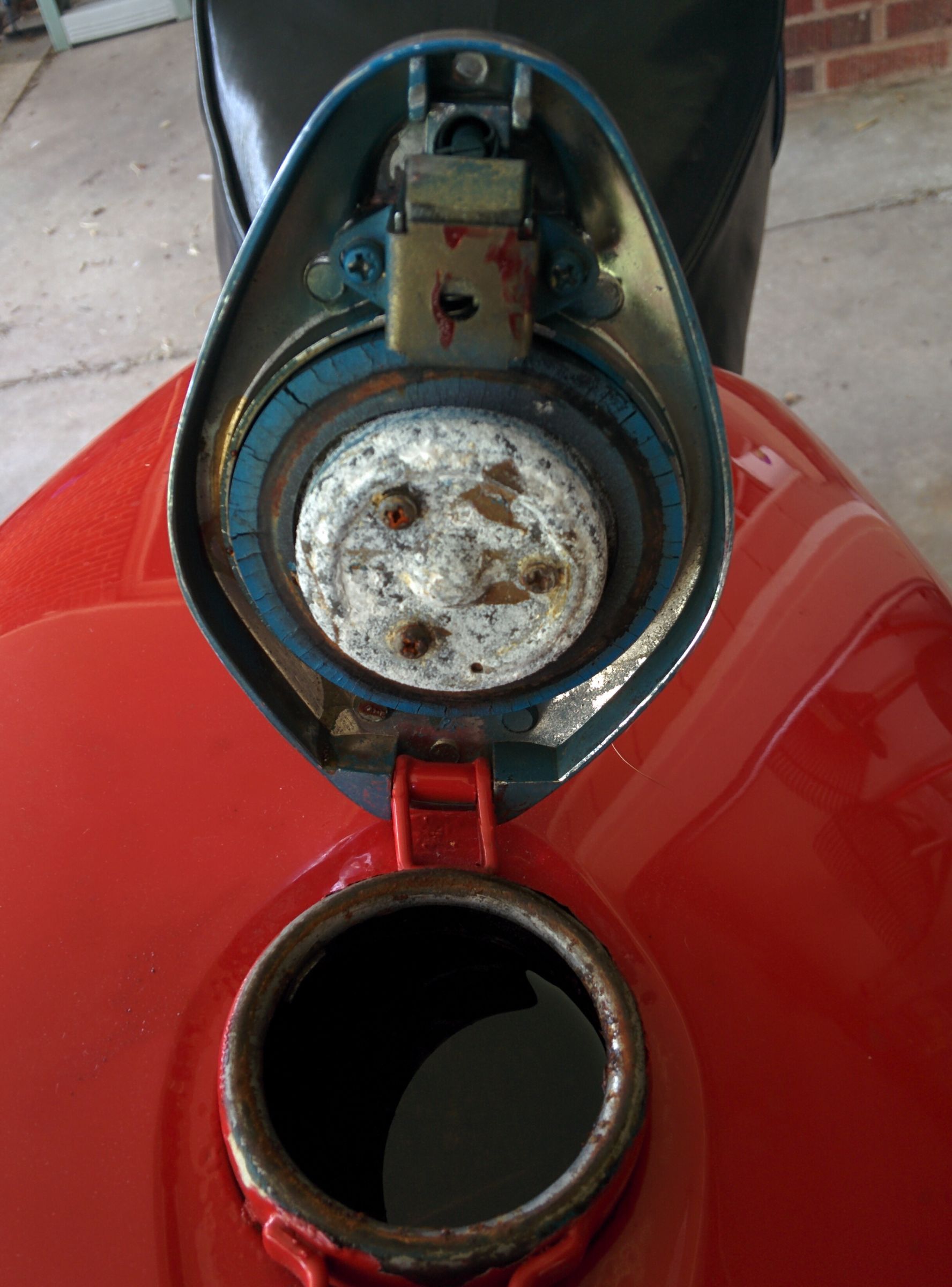

23 Oct 2016 13:00750 R1 wrote: There should be a breather in the tank cap, I'm not as familiar with these bikes but, in the old 750 Honda's this is a common problem, if the tank can't breathe properly then it starves the carbs of fuel... If its not fully blocked it will not rev out properly under load, and if its completely blocked, or close to, you'll get a few miles down the road and stop, what confuses most people is that, after waiting for a few minutes, it will run again, but do the same thing, eventually running out of fuel each time...
It looks like you hit it right on the head, Senor.
She started right up this morning. I bled the float bowls just to be sure, but there didn't appear to be any water in the fuel.
I rode for about 10 miles at 60mph. She ran perfectly, and what a beautiful day for a ride!
I opened her up. This time, she topped out at about 95, where yesterday, she wouldn't go over 80. Not great, but better.
Sure enough, after about 2 miles at WOT, she started to die. I pulled off the road and opened the gas cap for a few seconds. She smoothed out immediately.
I cruised about 10 miles at 70, and it happened again. This time, she didn't smooth out as soon as I opened the gas cap. There's a spot in the fuel line right where it goes into the filter where the bend is a little sharp. I straightened it out, and the bike started running well. I guess the suction collapsed the fuel line at that bend. I'm gonna trim it.
I rode about 75 miles. It happened several more times. Once, opening the cap and playing with the fuel line didn't help. I messed with the petcock a bit, and it straightened out. I think the petcock is janky. It is REALLY hard to turn, and working it a dozen times, or so didn't loosen it up at all.
Here's the underside of the gas cap:
What's the best way to get the vent working again?
Also, when you're 59 years old, and haven't ridden in 4 1/2 years, 75 miles on the most uncomfortable seat known to man can be tough!

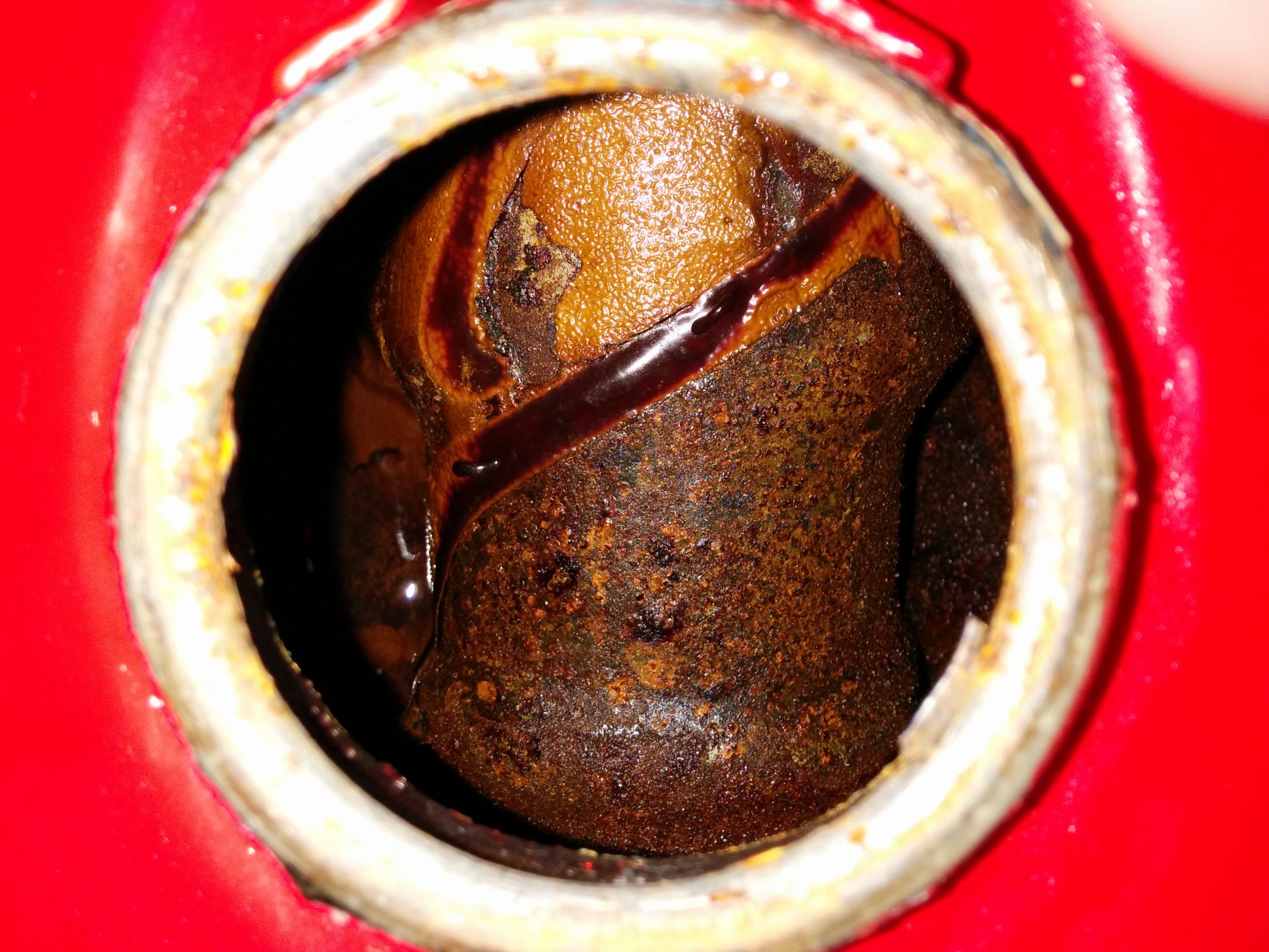

Years ago, I de-rusted the tank by putting BBs in it, putting it in the drier with packing foam jammed in all around it, and letting it spin till the BBs got all the rust out. I then rinsed it out with Acetone, and coated it with Red Kote.
The guy who cleaned the carbs for me last month said the tank had been rusty, and he'd treated it with this Metal Rescue stuff:
He said after he'd treated it, he'd washed it out with water, and blew it out with air. I'm thinking he didn't get all the water out, as in my initial post, I described the problems I'd had with water in the fuel bowls. I've run HEET through two tankfulls, and when we bled the bowls last night, there was no water, so I think that particular problem is behind me.
Here's the tank now:
Clearly there's rust, but I'm also wondering if the Metal Rescue has reacted with the Red Kote, and it's coming off. I'm wondering if the reddish residue we saw in the fuel bowls is liquefied, or semi-liquefied Red Kote.
I'm thinking I need to not only de-rust the tank, but also de-Red Kote it, too.
Does anyone have any thoughts?
What's the best way to straighten out the tank?
