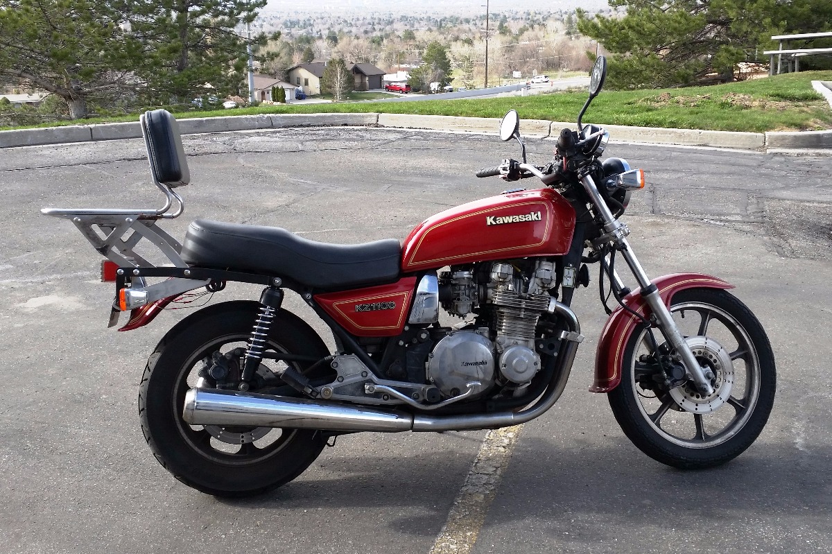

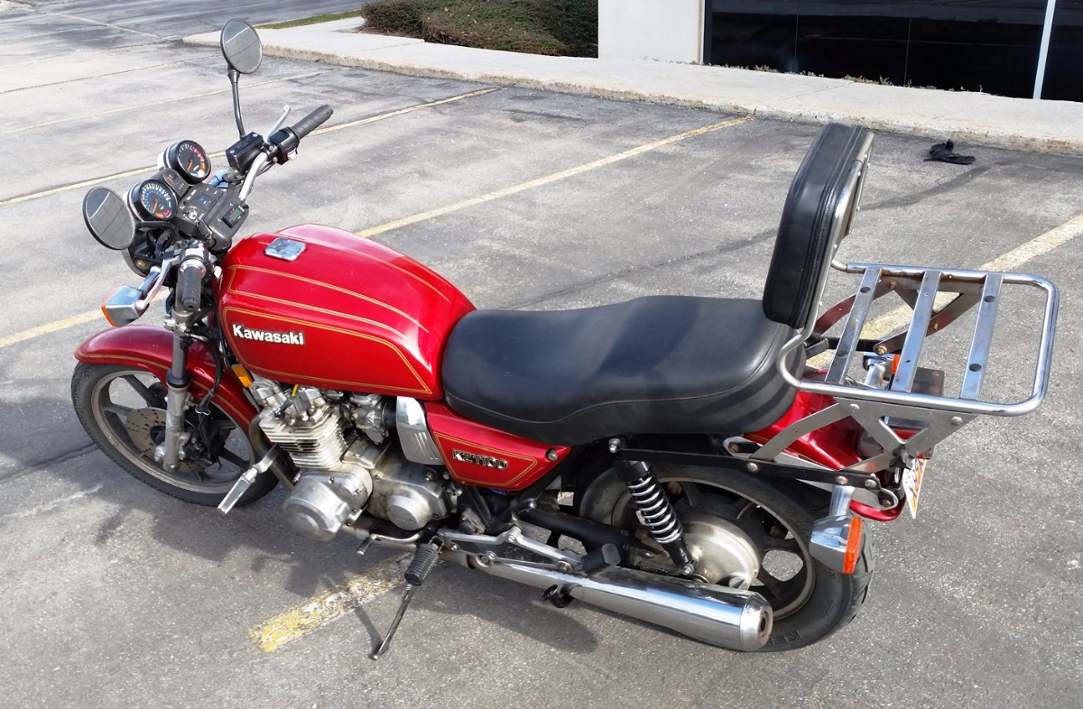

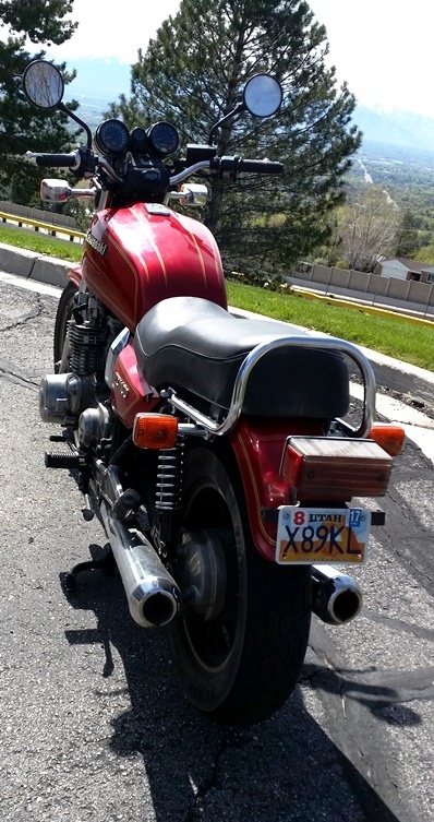

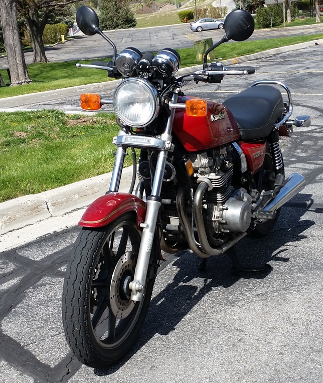

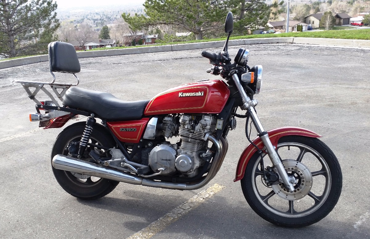

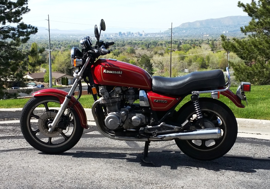

I got it running today! I took it for a 30 mile check run. Running great the only things I have to complain about is the clutch cable needs adjustment and the tach is bouncing above 6k.
I got it up to a ton. "How would you know that on a '82 Kawi?" you say.
Because I have a UK speedo on it. I didn't realize I was only in 4th until after I had started to drop speed and by that time I was out of room to take it back up.
Here's pics of it along the way. Can you spot all the changes so far?

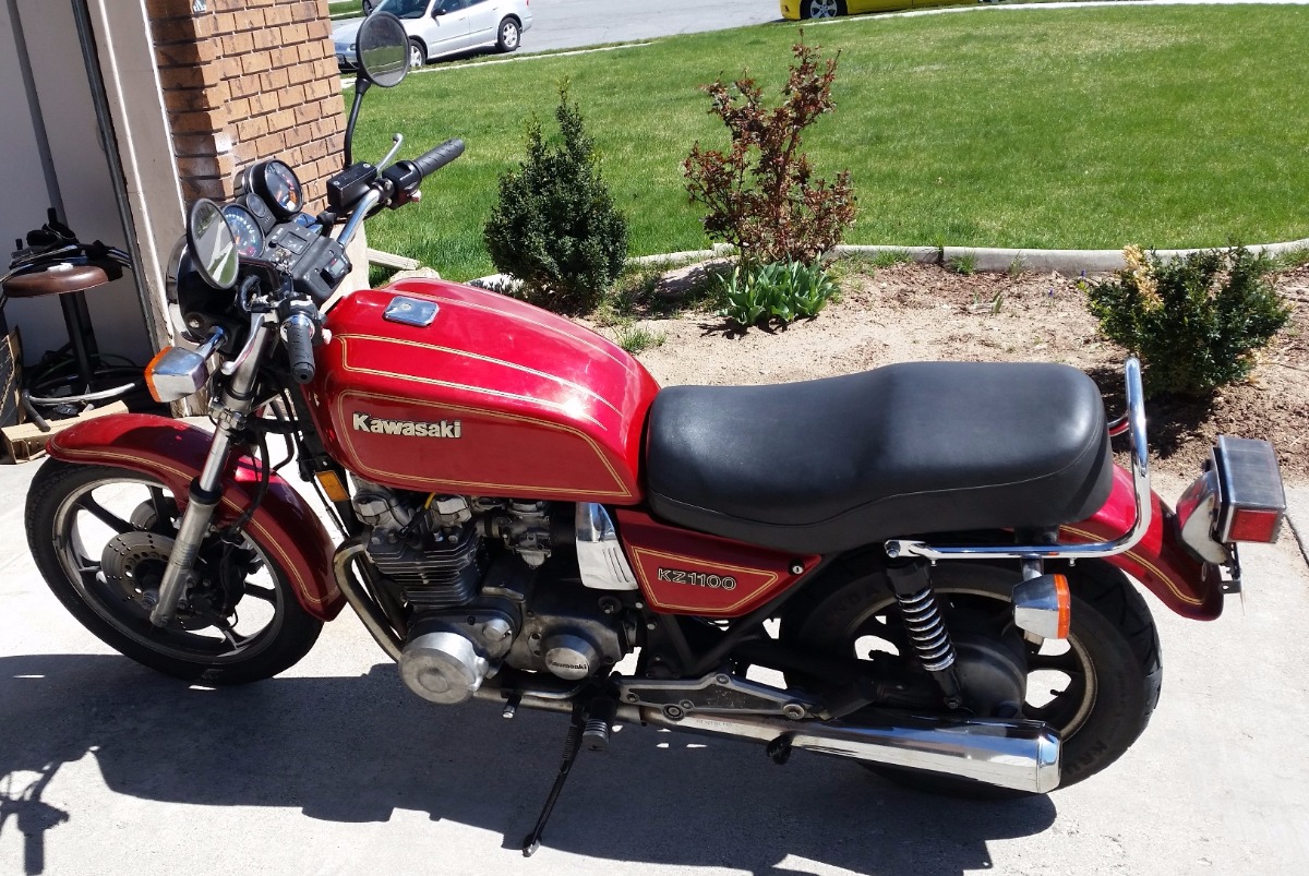

Put in a new battery, put on the grab bar and am working out some gauge issues.
I thought the clutch was slipping but it turns out the clutch cable was pulling out of the clevis. I adjusted the cable and it popped out a block down the road. I went to lunch, swung by the independent bike shop got a new cable and now it's working fine.
Pic just before the cable came undone.

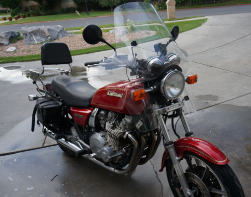

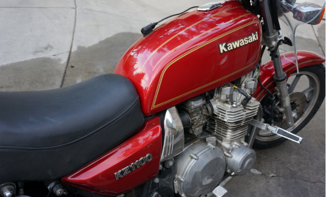

I had to put a new starter clutch In yesterday. I then took it for a nice benches run. Not a great distance but the left foot peg, I actually think it was the centerstand foot pad, got a bit of a scrape on a chicane-ish turn along the way.
This is how it's going to look for at least a year. I need to reduce the preload on the forks a little. The tach is still bouncing so I'll swap that for the uglier but more functional spare. It's seeping oil from a few places as the PO or his mechanic was a bit lax in using gaskets thinking RTV would do the trick.... it didn't. However I have other projects to give my attention so for now I'll live with it.
