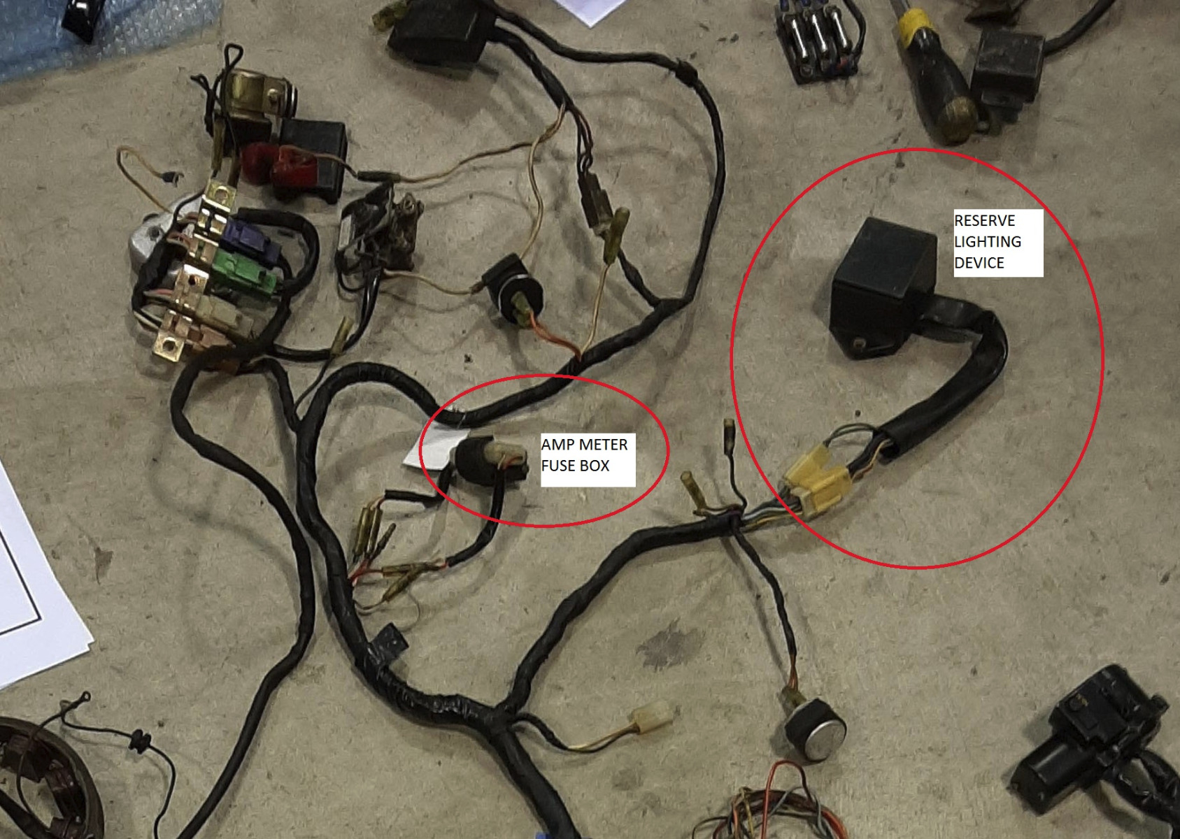

Also starting to really get into the wiring. Because I didn't have any wiring when I started this project or have a bike that I can go to look at, it's been a slow process understanding what i need. I bought a new PMC loom from Japan which is really well made and mostly lines up with wiring diagrams but I was still pretty unsure of what I needed to get the bike going. I had also bought new sets of aftermarket switch blocks too which added another level to figure out. In the end I have purchase a complete used loom from Japan that came with nearly all the bits that get plugged into it! Sorted! I have plugged the old loom to all it's various components and have matched up everything as it corresponds on the new loom. I have also decided to get the bike running with original switch gear fitted and then wire in the new lot once I am happy everything works. I think I have it mostly sorted now but still need to get shifted, fit the new loom and see what I have missed.
If anyone out there can provide more photos of the routing of the loom, where the earths are attached, etc that would be awesome. The more photos the merrier!
Also after any info you guys can give me on the resistor that lives up by the coils. From what I have figured from the wiring diagrams it is for the fuel gauge and the ammeter. The one I have has a few broken wires. Worth fixing or trying to source a NOS one, or is there another way around this? Thanks again.

I'll have to check the wiring diagram again, but I thought that resistor block was for the lighting reserve unit ( it detects a failed bulb and switches to the other filament).
Those resistors look like standard parts. I'm guessing you could pull the existing ones out of the frame and slide in new ones. I need to pull my resistor pack off to do a valve adjustment, so I can look at mine if yours is too damaged to figure out what the resistance values are.

I checked the manual. I 'm pretty sure those resistors are for the reserve lighting unit, but it's really hard to follow the diagram.
The manual (99931-540-02) has diagnostic information for the reserve lighting system on page 252, and gives the values for the two resistors. "About" 1.5 ohm and 3.9 ohm.
It looks like you might be able to solder the wire you have back on, but if you find that the resistors are damaged you should be able to find similar parts. I'm not sure exactly what size the factory parts are, but here is an example of some replacements that might work.
www.digikey.com/product-detail/en/te-con...e-product/A137076-ND
www.digikey.com/product-detail/en/te-con...e-product/A131164-ND
As for the gauge wiring, the fuel gauge is wired directly to the sender, and the amp meter (which I've never seen do anything useful ever) is connected to a length of wire wrapped up inside the main part of the harness. This wire "shunt" is then connected to the gauge through a small fuse holder with just two fuses in it. I have seen both white and black plastic versions of this holder. There is a small rubber mount that clips onto a frame tab inside the left frame rail behind the left side cover to hold the amp meter fuse box. Ah, I see it in your picture...

Thanks for your info, really appreciated. It has been a real big one getting my head around the wiring. The Z1R has all sorts of oddities to it! I am going to have a good look at the resistor tonight and see if it can be restored. Will keep you posted.
