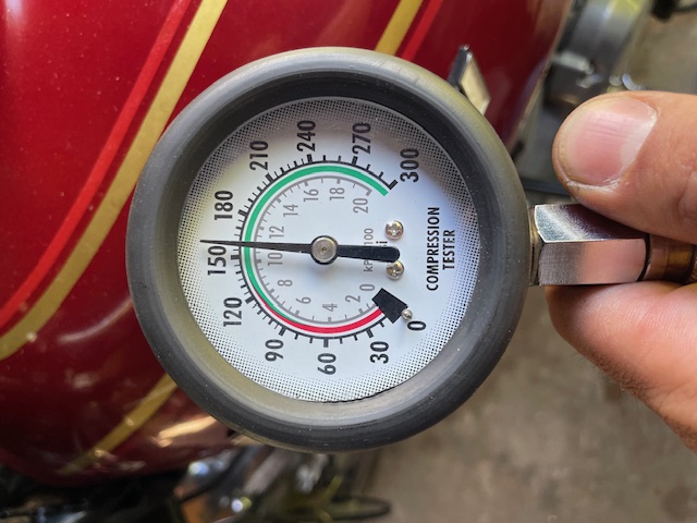

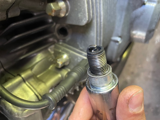

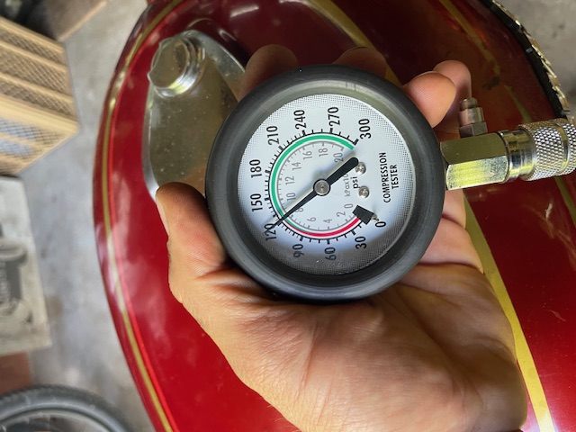

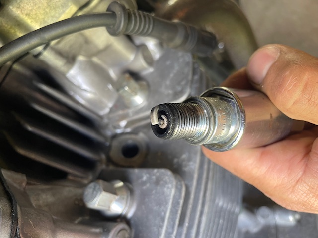

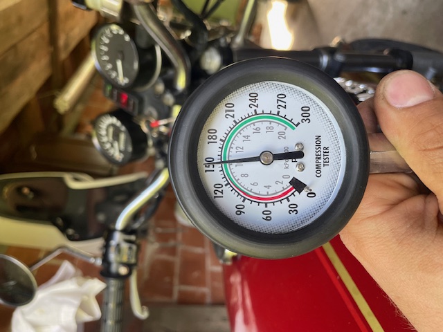

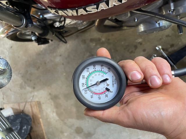

Hi guys,Hello again after a long time. After a few years' pause, I’ve finally decided to continue working on my Z's issues.
After discovering that it burns oil badly, I replaced the 10W40 oil with 20W50 (Motul 3000), but the problem remained. I also replaced the valve seals with softer ones (I think silicone ones).After a compression test, I found that it was within the service limit, but after adding some oil to the cylinder and measuring again, the compression reading increased by about 30 psi.It seems I’ll have to remove the head and re-check the cylinders and pistons.
Here is my to-do list:
Left cylinder spark plug, compression reading before and after adding oil:
Right cyl:
Right cyl:

Your "to do" list looks pretty comprehensive, a 25% increase in compression on the "wet test" suggests worn cylinders. I intend to run 20/50 Motul in my build once complete, you can experiment with different oils but they won't compensate for mechanical wear
