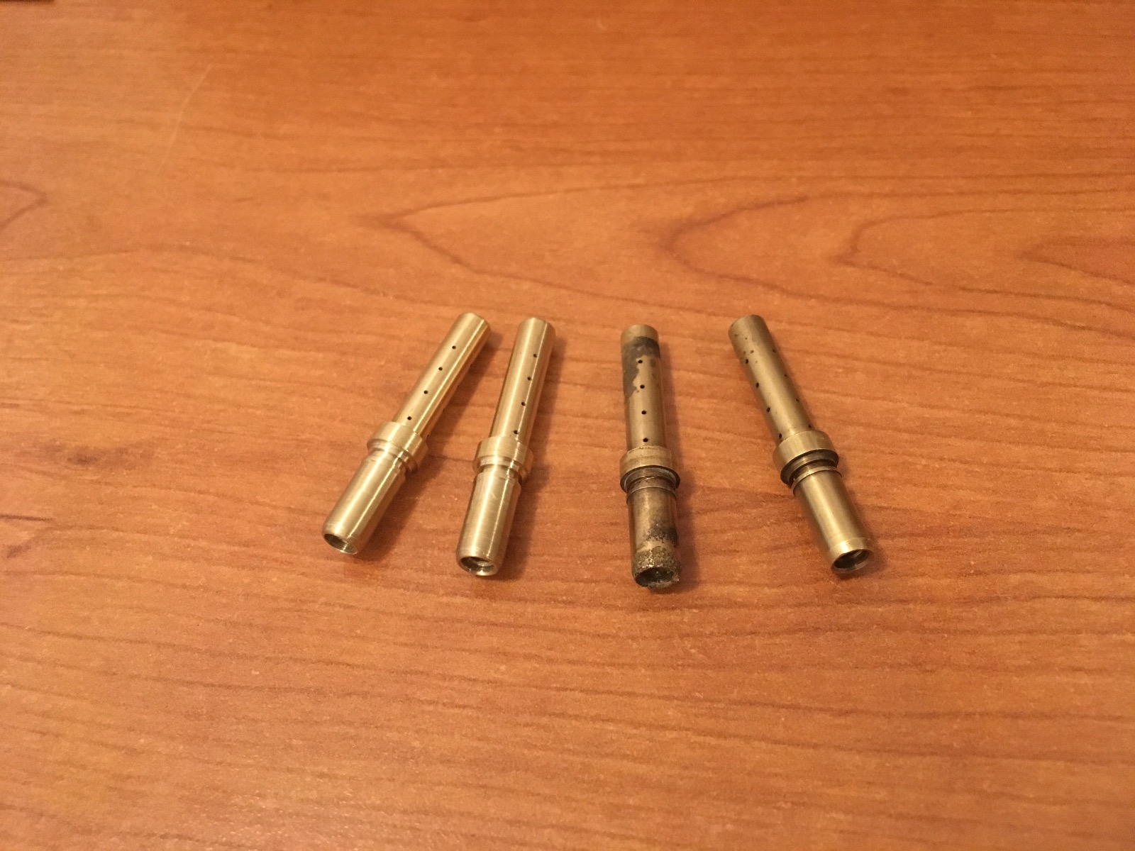

Since you can't find the z-4 needle jets, you could switch over to Z-2 needle jet and 4HL12-3 needle which was what came on the US import. both are available on ebay.
another thing to look at would be the o-ring on the needle jet. yours looks pretty worn.
what state is the float bowl gasket in? if it leaks at all it can mess with the jetting as the jets are in the float bowl itself.

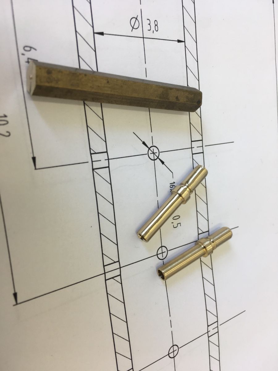

Hmm that's a good idea. But first I will make new jets on lathe. Since the internal diameter is 3.15 I will ream the pre-drilled hole with reamer 3.1 mm (I can't find 3.15 mm reamer and I believe it doesn't even exist) and if needed raise the needles. Then I will report back to you
I bought new O-rings. The gaskets are new.

I realize this is a different bike and that this info might be a bit late, but on the early Kz550's, the needle to needle jet clearance is very close.
The OD of the stock needle is 0.099" and the needle jet ID is .102". That leaves roughly 0.003" clearance.
The OD of an aftermarket needle is 0.100". That leaves roughly 0.002" clearance.
0.002" is about 0.05mm.
0.003" is about 0.07mm.
A defective/unusable needle from a "counterfeit" kit had a needle with shaft measuring 0.098". No matter the amount of shimming etc, the needle was way too rich.
These measurements are on the parallel portion of the needle shaft.
The needle jet bore was measured using a round shaft that fit with a light interference-fit, then shaft was measured using the same micrometer used to measure the needles. (Measuring multiple positions to confirm roundness.)
Very nice looking jets, BTW.

Hmm here the old jet (the good one) to needle clearance was 0,16 mm (0.006").
I reamed the new jets with reamer 3,1H7 (so if we assume that the reamer is actually in the middle of tolerance field, the actual diameter is 3,105 mm), so it leaves a clearance of 0,115 mm (0.0045"). In both cases the clearance is larger than in your case.
Nevertheless, I will give it a try. Ordered new diaphragms though, just to be sure. The old ones are a bit tired.
