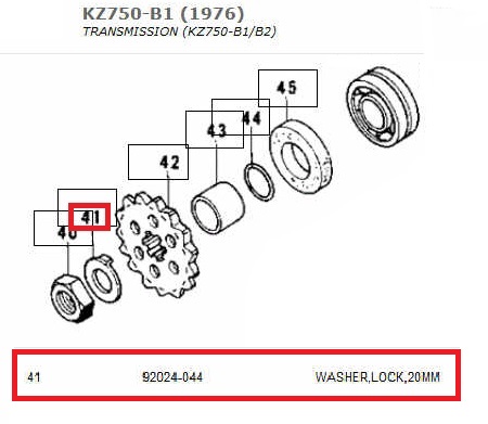

Be SURE to use a new, correct lock washer on that engine sprocket so the problem never happens again. Ed

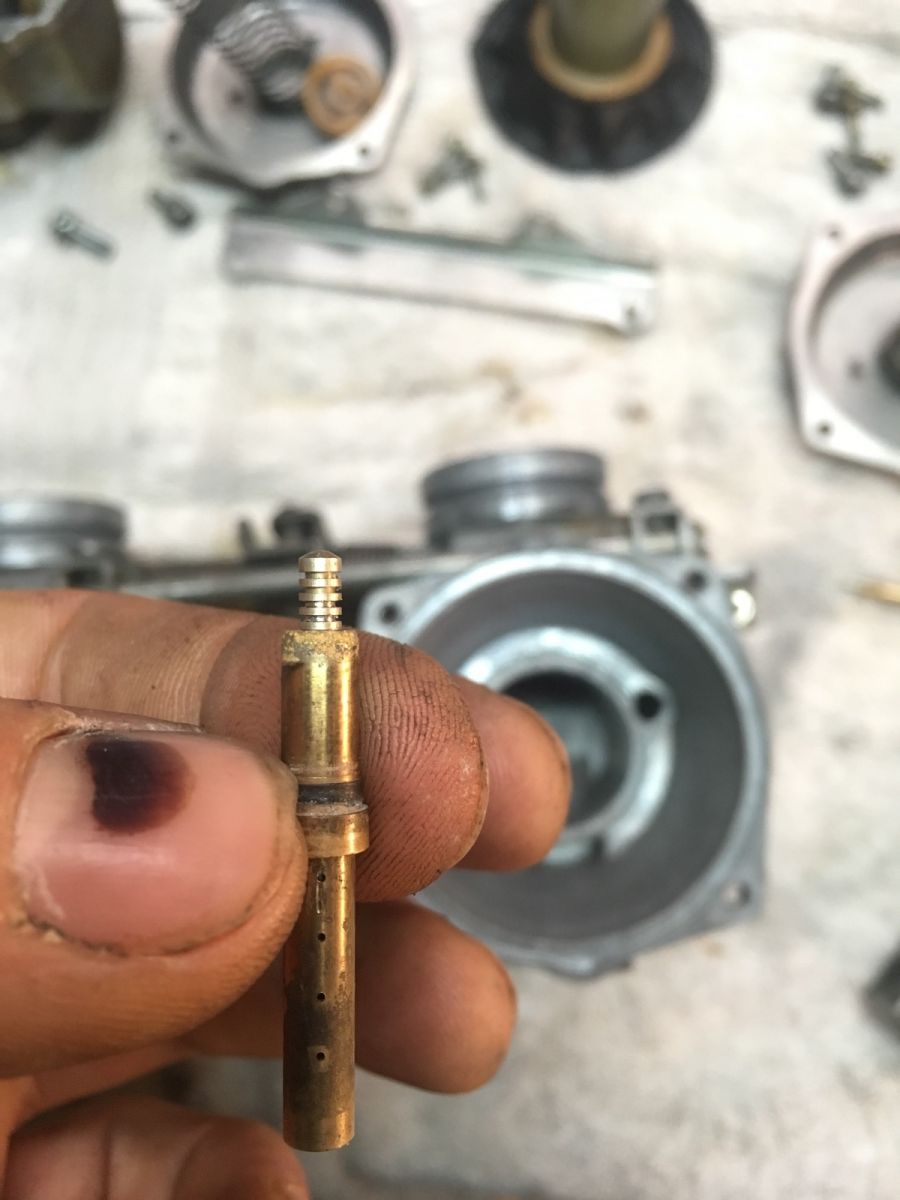

Hi guys, I think I found the problem. Today I removed needle jets and one is considerably more worn than another. How much play should the needle have in the jet? Should the needle completely close the needle and prevent flow of the gasoline?
Here’s a photo of needle inside the jet.

if the needle jet or needle are worn they should be replaced. what state are the diaphragms in? Did you figure out your ignition problem? is your advancer rusty?

Is that a pic of the needle and seat or the needle jet and jet needle?
Post a pic that is 90 degrees of the one you posted.

27 Dec 2018 00:04DoctoRot wrote: if the needle jet or needle are worn they should be replaced. what state are the diaphragms in? Did you figure out your ignition problem? is your advancer rusty?
Yes I know but I have problem finding the correct one (Z-4), but I do have machines to make new ones.
The diaphragms are in good shape, they are not torn or damaged.
The ignition works fine, breaker points and capacitor are new, advancer cleaned and lubricated.

That is the emulsion tube and jet needle. The tube looks worn, corroded and maybe the needle is worn too... I seems like it should be nearly perfectly round inside so the emulsion tube operates correctly at different manifold pressures and throttle settings.

Yes, the tube is in pretty bad shape and you can feel play of the needle inside. But does (when new) needle completely closes the hole in the tube and seals it?

is the internal bore of the needle jet worn? is the needle worn?

28 Dec 2018 03:46
The needles seem ok. I measured them, they are both 2.99 mm in diameter, the inside diamter of emulsion tubes is 3.15 mm, but since the inside micrometer has 3 spindles I can't measure roundness...
