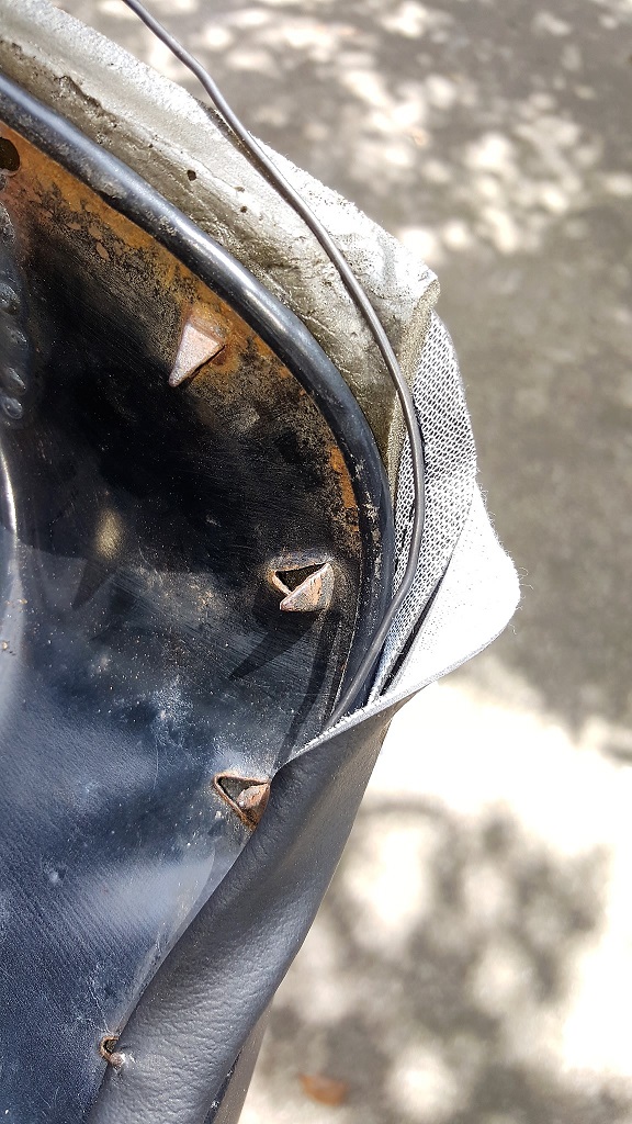

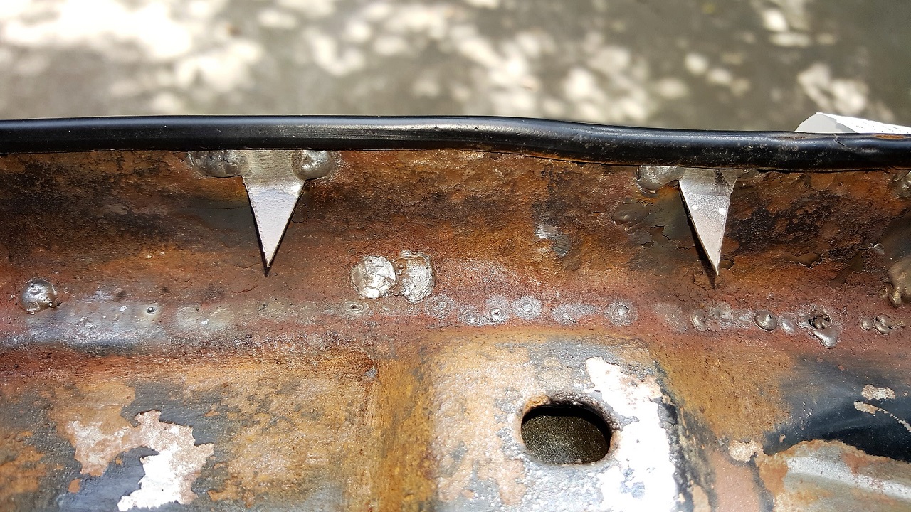

It seems like this may be the last or close to last post for this thread. I was working on KZombie today and put the last of the puzzle pieces together. I know there will be more fine tuning or even not-so-fine tuning to do but she's pretty much fait accompli now.
I started early again to try and beat the heat, by cutting small points from steel for the seat pan's upholstery anchors:
I know they're not pretty but they're not going to come loose ever. I still have to dress-up the lower pan side with some rust inhibiting paint and was thinking of using POR or KBR since UV light won't be an issue here.
So that was one of the last delays as I couldn't find my shears all week and it was just Friday I stumbled upon them in another moving tub stacked in the corner.
Next was to finally get the new seat cushion and cover installed.
During the week, I had test fitted the new foam and cover and discovered how much tension would be on the vinyl once it was installed and showed the situation to my darling better half. She didn't think the vinyl would hold up to such stress and could possibly tear out or tear away from the cleats or points. It was her idea to put a strain relief in place as the seat was being installed. I just happen have a small role of bailing wire (you know, on the shelf next to the bubble gum for all major repairs in life; right?) and she thought it should be good enough.
Here's the seat being installed onto the pan:
The idea here is that the vinyl is sorta' wrapped around the wire and tucked inside before the vinyl is pulled snug and pressed down over the points. This means the stress or tension of the cushion foam is held in check by the wire instead of just the vinyl.

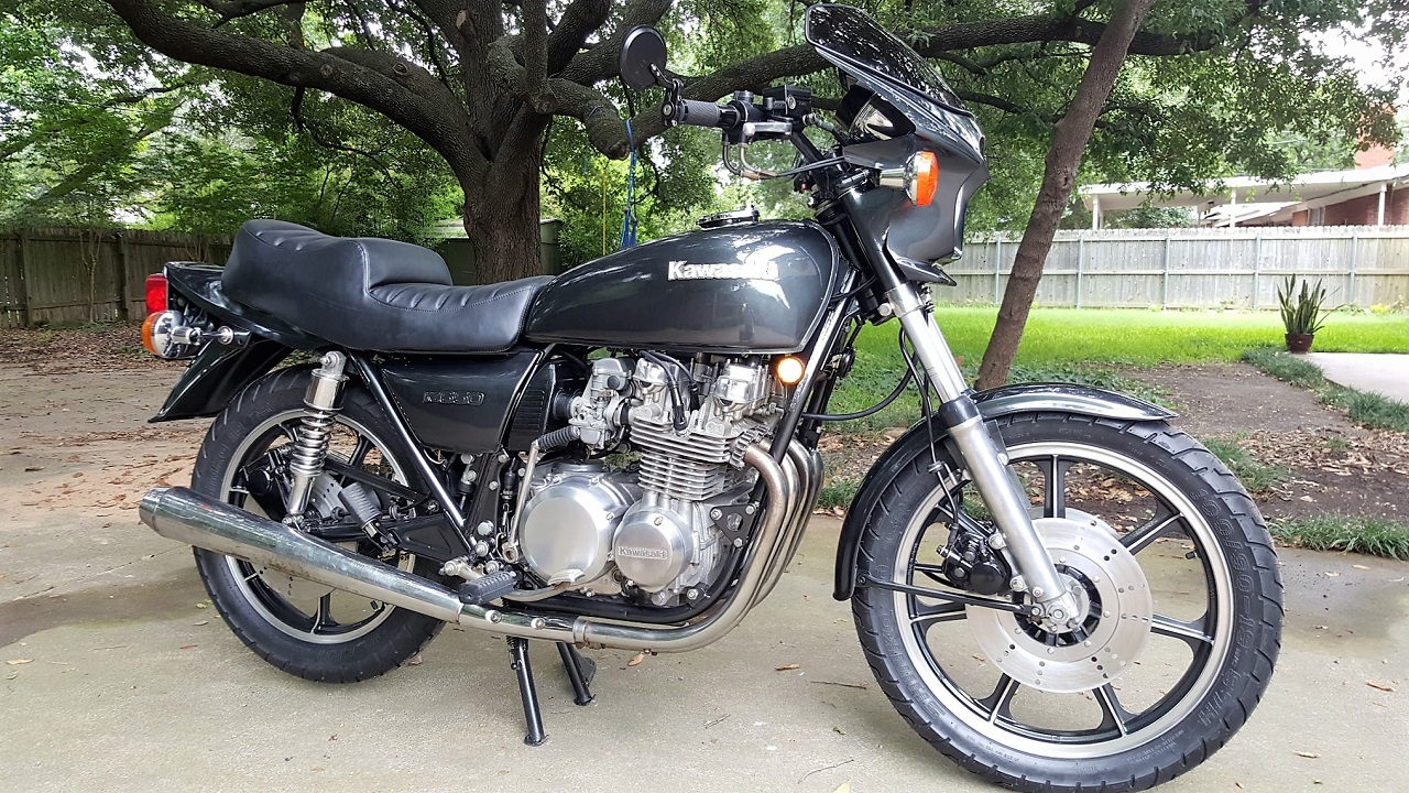

And...
It worked!
Yeah, I know... Ack! What was I thinking with that seat?
I can hear the gasping from here but frankly, I like it and it's comfortable. Not boy racer cafe style but definitely my speed and it has space on it for a passenger or a spiderweb cargo net.
So that was pretty much the final job. I installed the emblems, although the side badges remain an issue for me. I've been trying to find a printing service that can do vinyl printing in multiple colors because I designed a side panel badge to replace the stock one that is on now. So far, I've contacted a few companies but the limited run of just 2 or maybe it's the number of colors or the small size; I get no response to my queries. Here's the side emblem for grins:
and Devin, I think I'm groovin' on your idea with the red pinstripes on the wheels but it'll come down to my ability to pull off such a thing with paint that I can match instead of the wheel sticker system I've seen. On the bright side, I found a local pin stripe artist who's work looks very good so I may just suck it up and ride the bike over to his shop and leave it to someone more skilled. We'll see.
Yeah, so that's pretty much it.
And...
It worked!

Nice job on the tack points. I did a few of mine on the 550 too. Also there are full-length tack steps that can be affixed to more damaged pans after clean and repaint. R

I actually did look at a few tack strip type options and even picked up one but it seemed it was going to be just as much work to drill, rivet as to simply cut 'n weld. Ultimately, I made several sizes of "points" too, the majority were as pictured but there are a few that are custom sized and shaped to solve issues - such as being an additional anchor between the new steel pan and the old steel pan or like the front corner where it kinda' wraps around from side to lateral. Again, I probably made it into rocket science when it wasn't needed but it's done now and it worked beautifully, in fact, my new points were sharper and slightly wider so they poked through the seat vinyl easier and then had more width to grip the wire.

Wrench! That seat looks sexy! Good job on the upholstery- that's not an easy task. My dad does custom work on mikes, cars, and home upholstery on the sidelines of doing his aircraft work. Looks wicked!
