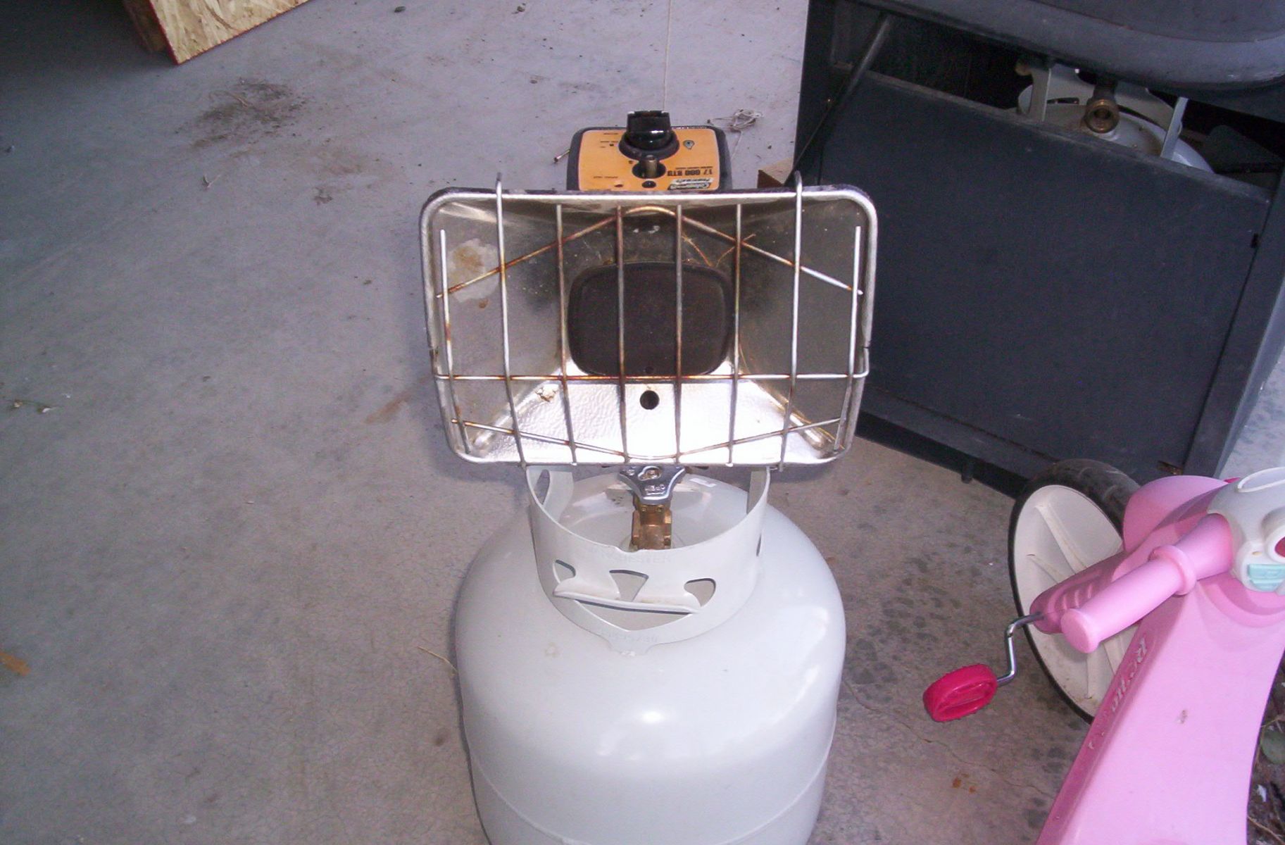

Tearing into it I see. This is the kind of heater I was talking about. It CRANKS. I left it at my daughter's place last year. Sitting in front of it you'll cook.

Is that heater safe to run in an enclosed area?
Today was an easy dismantle. The more careful part is upcoming. I'll wait for some better weather and it's coming next week. February Jan and Dec all average below frezzing for a high temp here. I am gonna check that out. I've used some ice fishing propane ones, but was unsure if the BTUs would be there. Also don't want to blow up the garage. :blink:

17,000 BTU's. As long as the space isn't air tight like in a garage, it isn't too much of a hazard. I'd keep a window cracked and of course no open flammables. During the summer in 13, I brought it inside and worked on it at my leasure. :whistle: The dirty stuff I did outdoors, cleaned them and brought them in. By the time my parts arrived, everything was clean, painted and ready to go. In my case I left the head off and rolled the case out to the shed on a dolly. In my 20/30's I'd puck up that engine, not now, a strained back would only set me back more time. I wanted to RIDE and I did just that. :woohoo:
