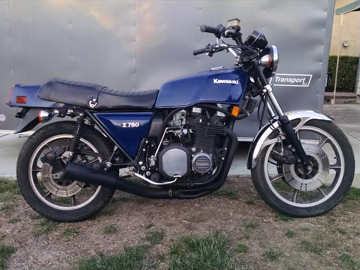

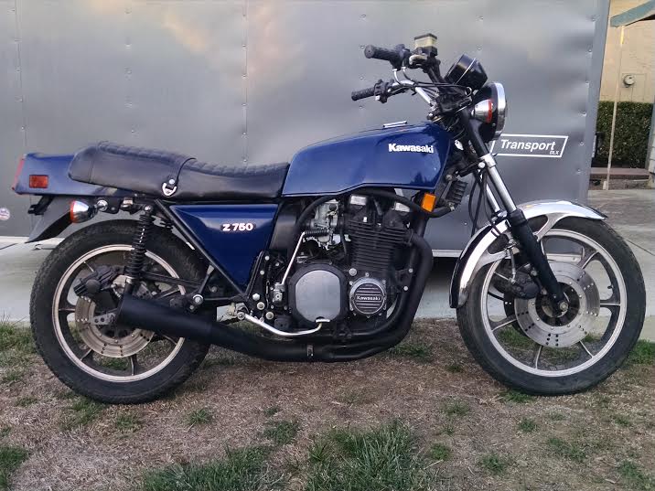

01 Nov 2015 14:54 - 01 Nov 2015 14:57I found this on Craigslist (3/4 of the way across the US) listed as a Z750, which allowed it to slip through the cracks in the Z exporter searches. It's a 1980 Z750fx, which is basically a 750 version of what we got in the US as the '79-80 KZ1000mkII. It's mechanically unrelated to our KZ750, and is a debored/destroked 1015 based motor.
It's been sitting an unknown number of years and will need all of the typical resurrection work, after which I may paint it back the original color/stripe scheme, which was the same navy color as the US MKII
Overall, it's in great shape, almost no corrosion, hacked parts, or crash damage. I'm going to see if I can replace the tube=type wheels with something similar (same year if US has tubeless in otherwise identical wheels) or a year or two newer. I may also replace the bars with something just a bit lower, but of the same type.

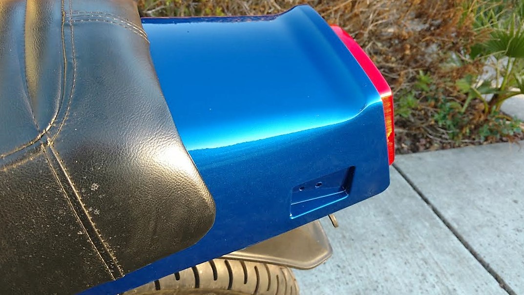

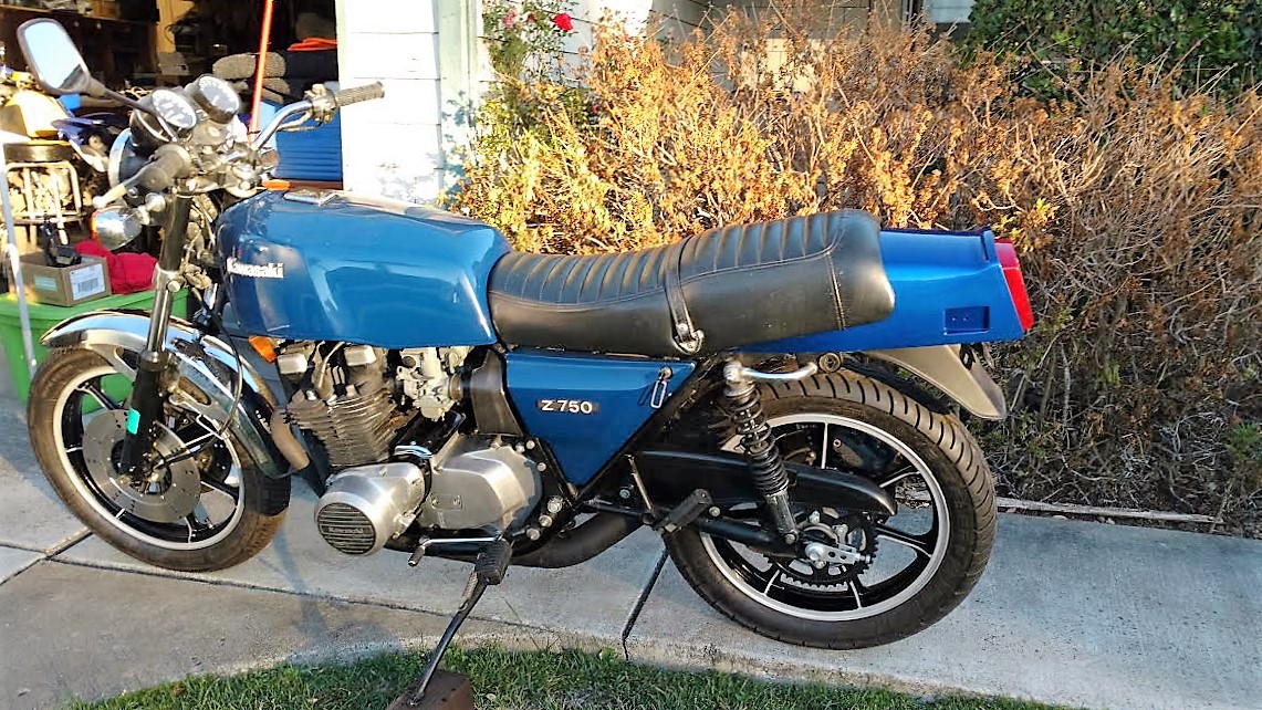

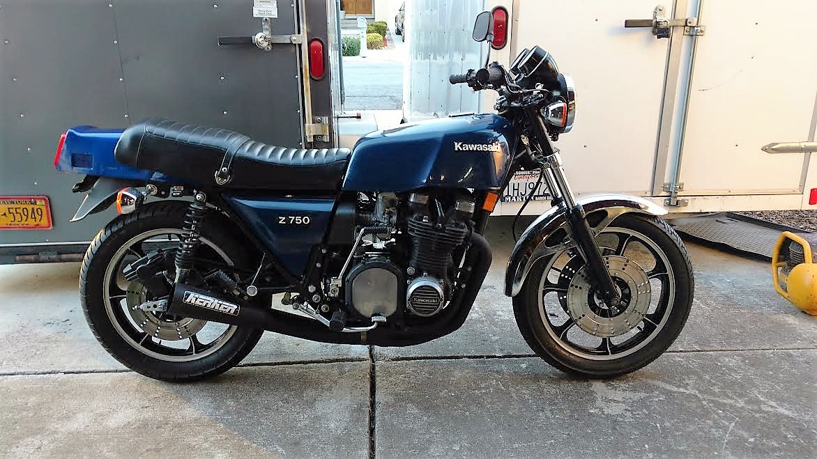

Progress has been slow, but I'm still working on it when I have some time. I've made some subtle changes. I've added superbike bars and short cables, a pair of Konis, and an 18" Z1R front wheel. I've also removed the oil cooler a,d resprayed the tail a different blue. The paint wasn't original, and was non=metallic, so I'm trying to get closer to stock. I did the tail as a quick test to see if I like the color (same as I used to match my '07 GSXR race bike). Still need to rebuild the brake system and add a 530 chain.
