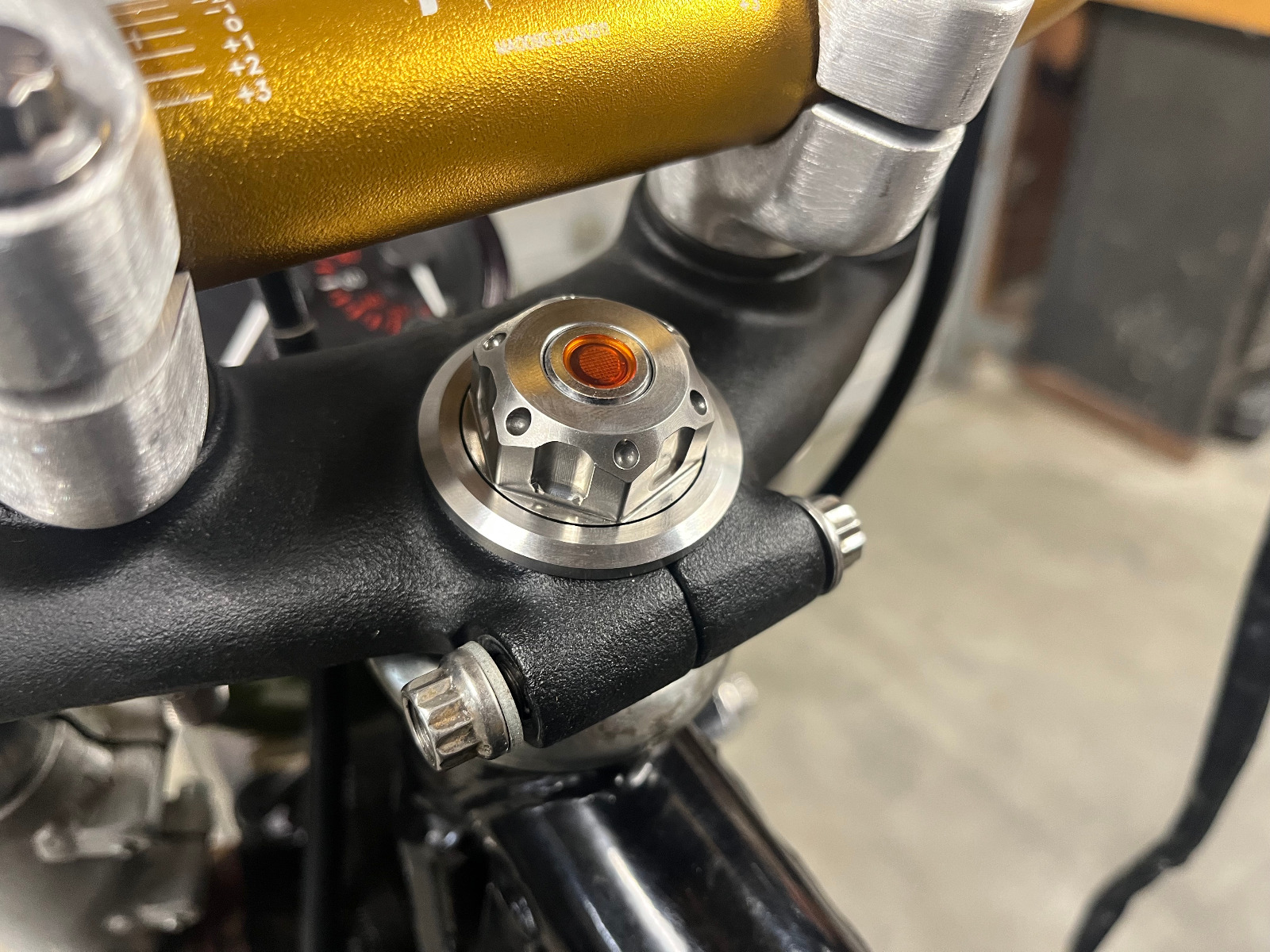

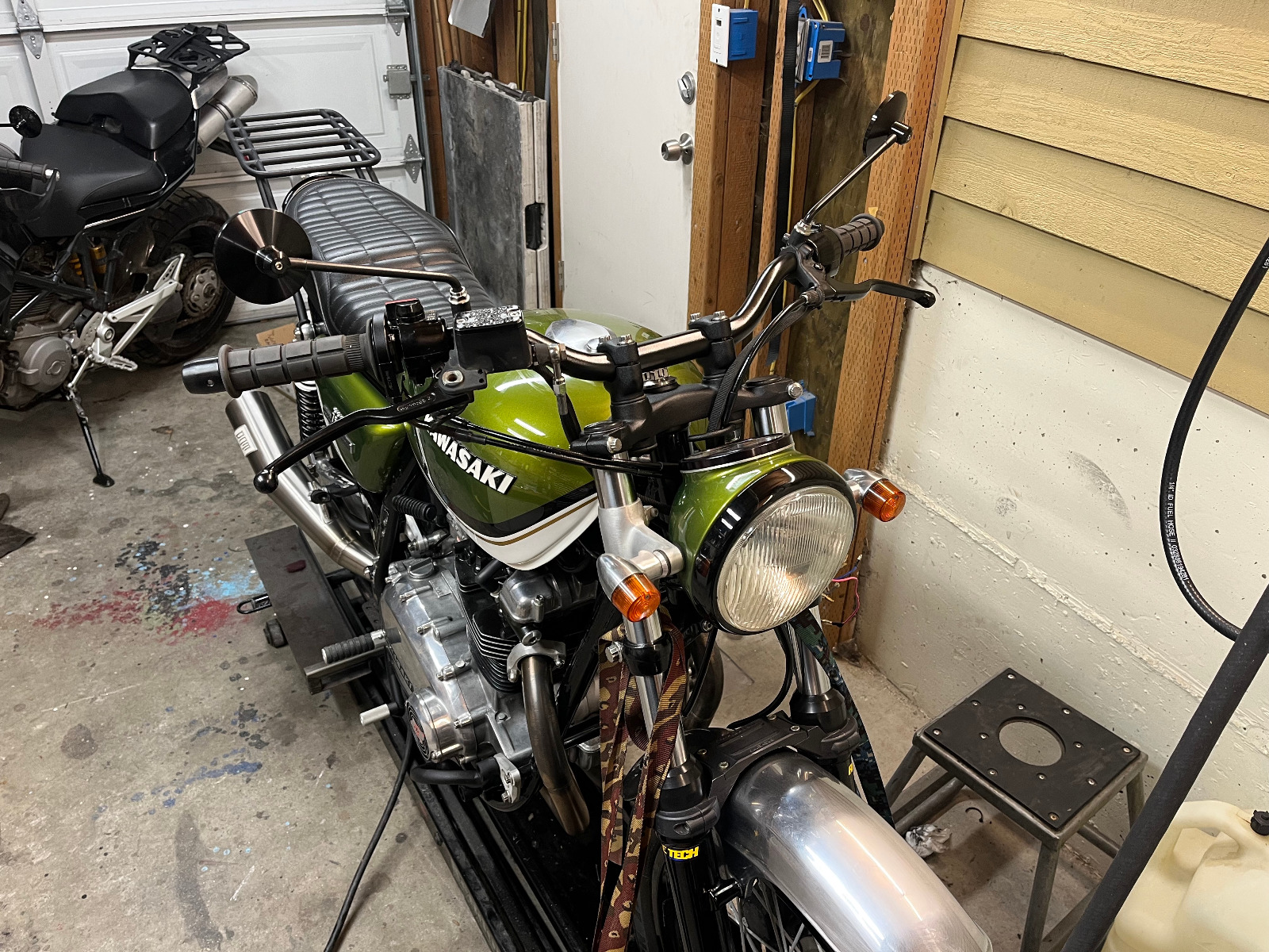

remade the triple clamp bolt and washer in stainless to match the axles/pivot nuts.

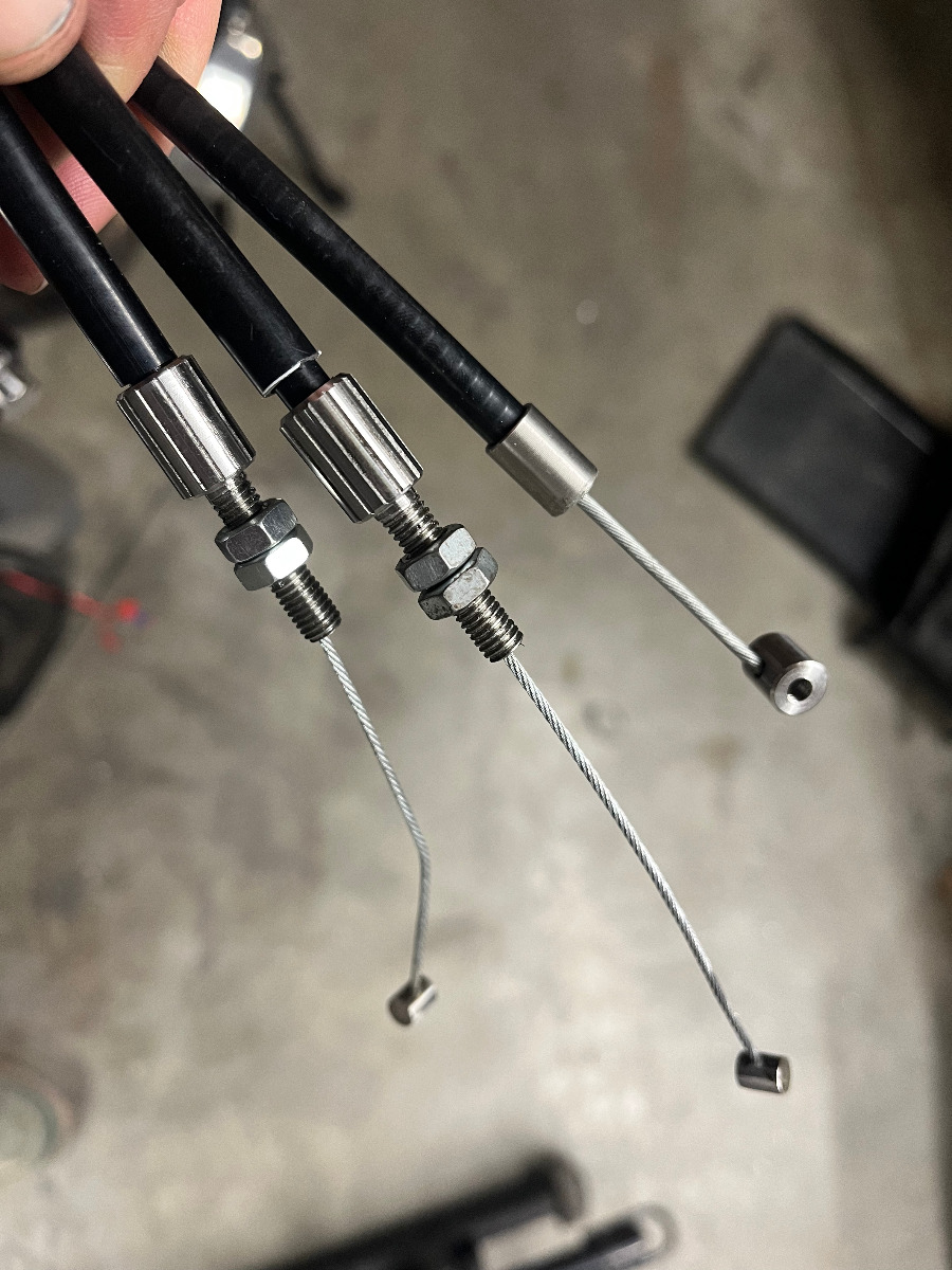

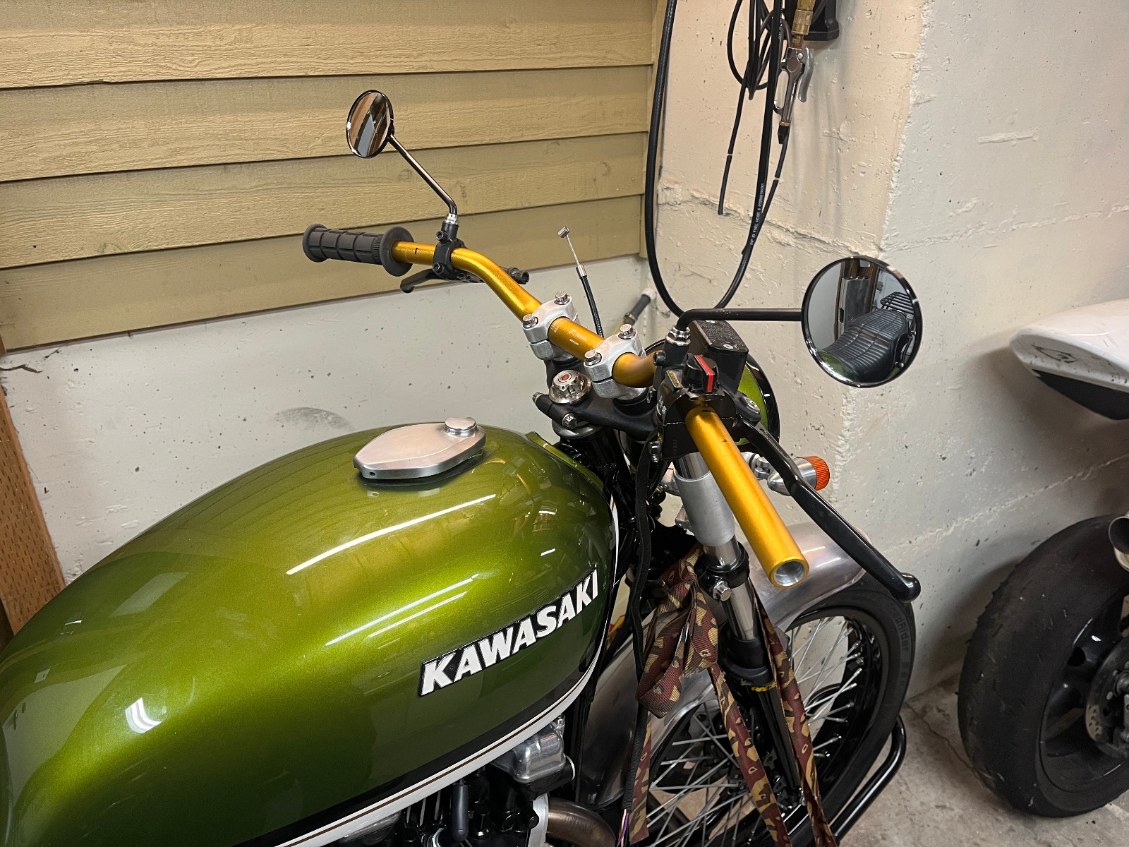

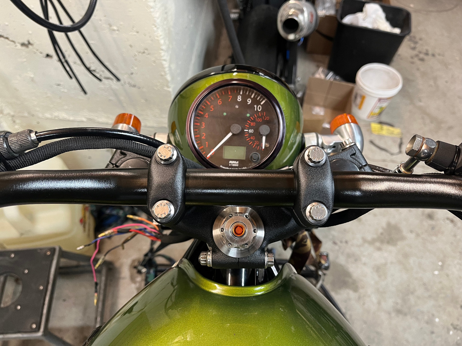

New bars came in and the owner is happy with them. These gold ones were $50 cheaper than black and I was going to paint them anyway to cover up the Rizoma logo. I went ahead and shortened the throttle and clutch cables, machined new ends and ferrules in stainless. Soldered with stainless specific solder and flux and its good to go.

I would keep the gold color bar, looks more attractive on your bike.

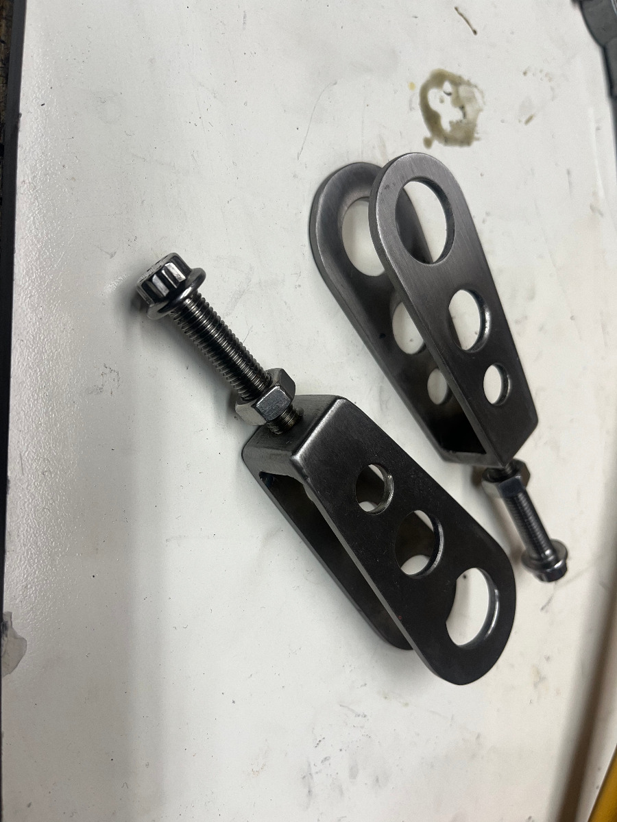

The gold is too gaudy for this bike.

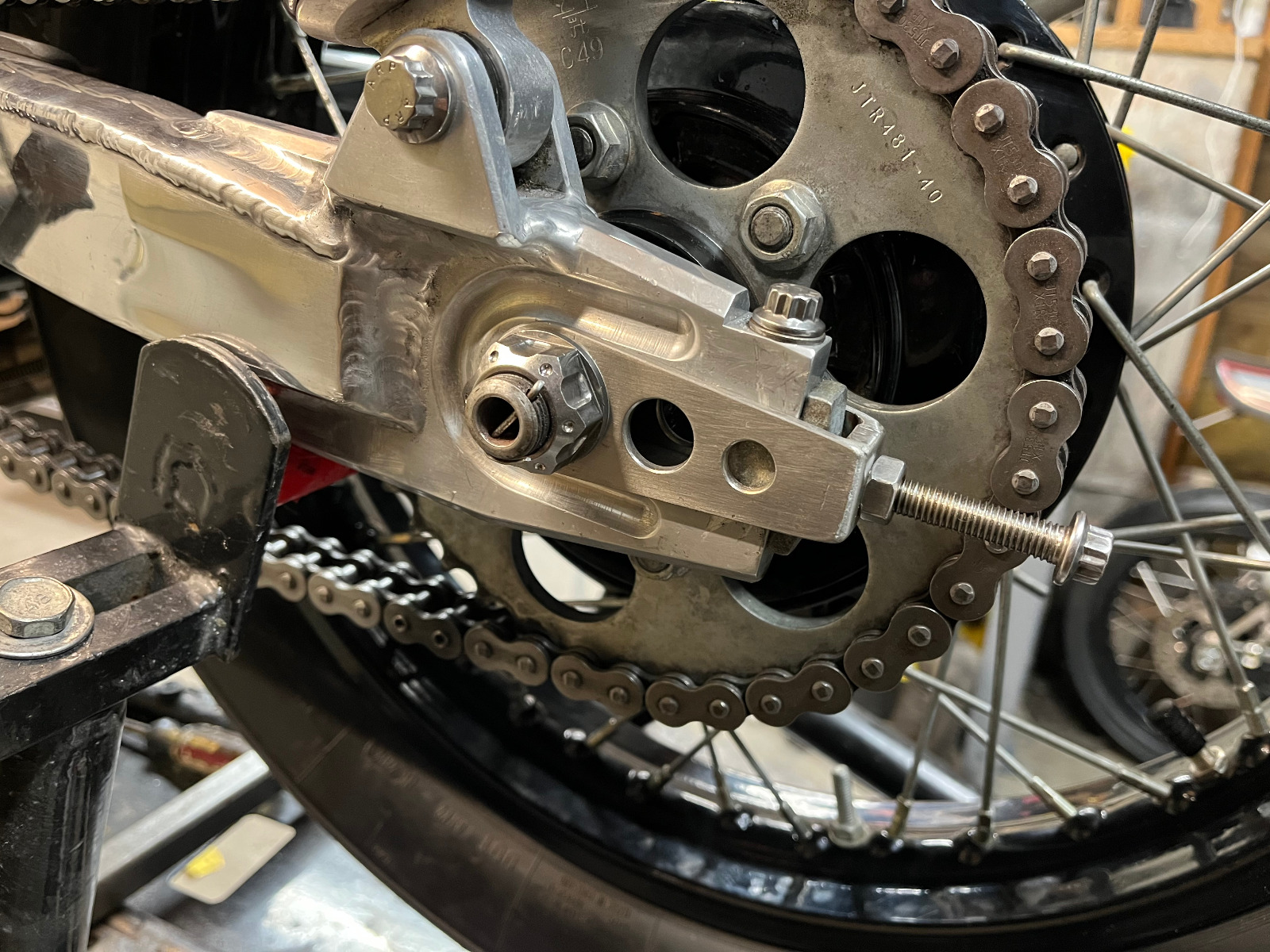

attempting to reign in my OCD... its not going well. I didn't like the black painted axle adjusters so I remade them in stainless.

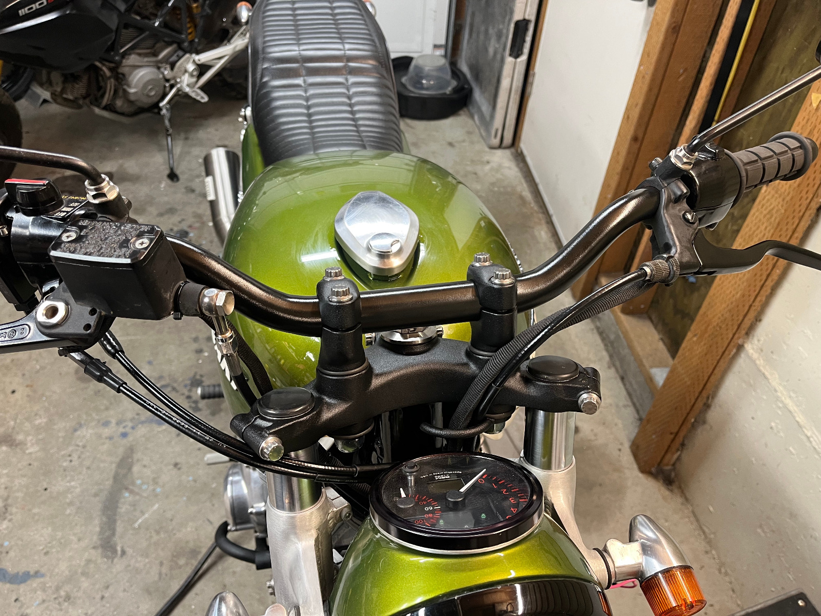

#909336
Clamps powder coated and bars painted. Also added some Woodcraft bar end sliders, installed shorter brake hose and fresh brake fluid. These handlebars have a really thick wall so there was no way I was going to be able to internally route the wires even if I wanted to. I put on some fresh woven heat shrink and routed them along the brake/clutch lines. It looks OK, but not my favorite. Just needs an oil change and a shine up and this suckers ready for some better weather.

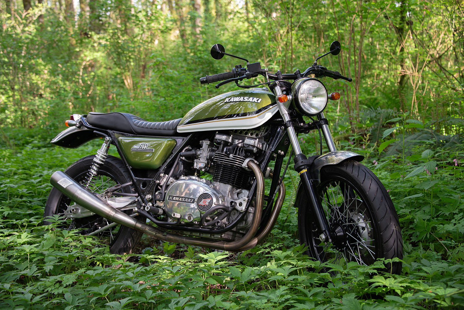

Got some new photos and a write up over at Pipeburn.

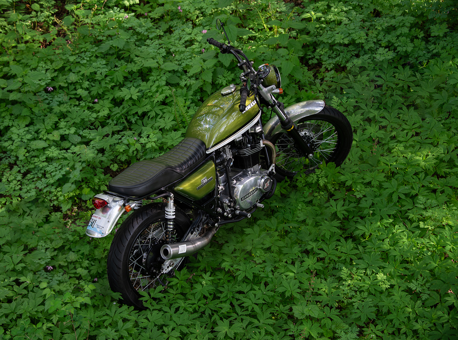

thank you.  Heres a pic they didn't use for some reason. I crawled up a tree to take this.

And that is the best photo of them all 👍👍👍👍
