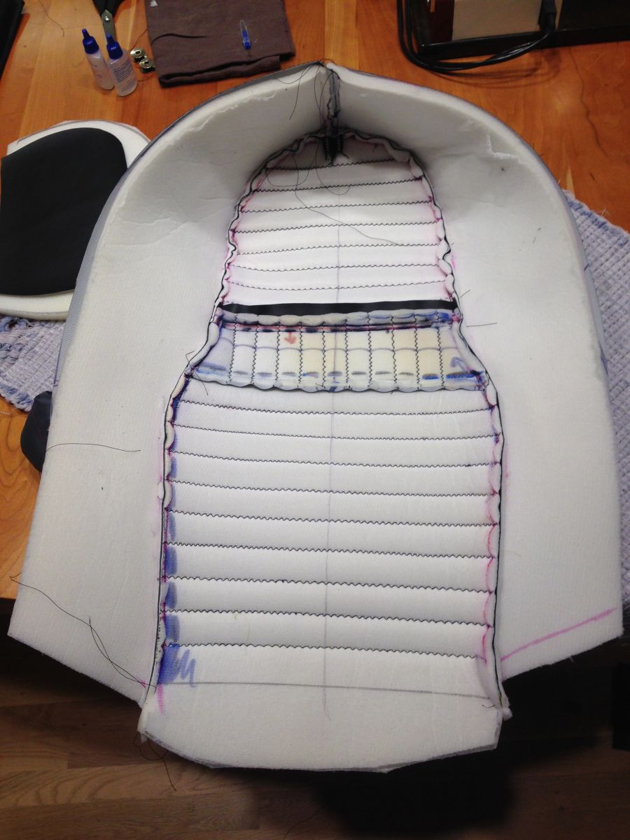

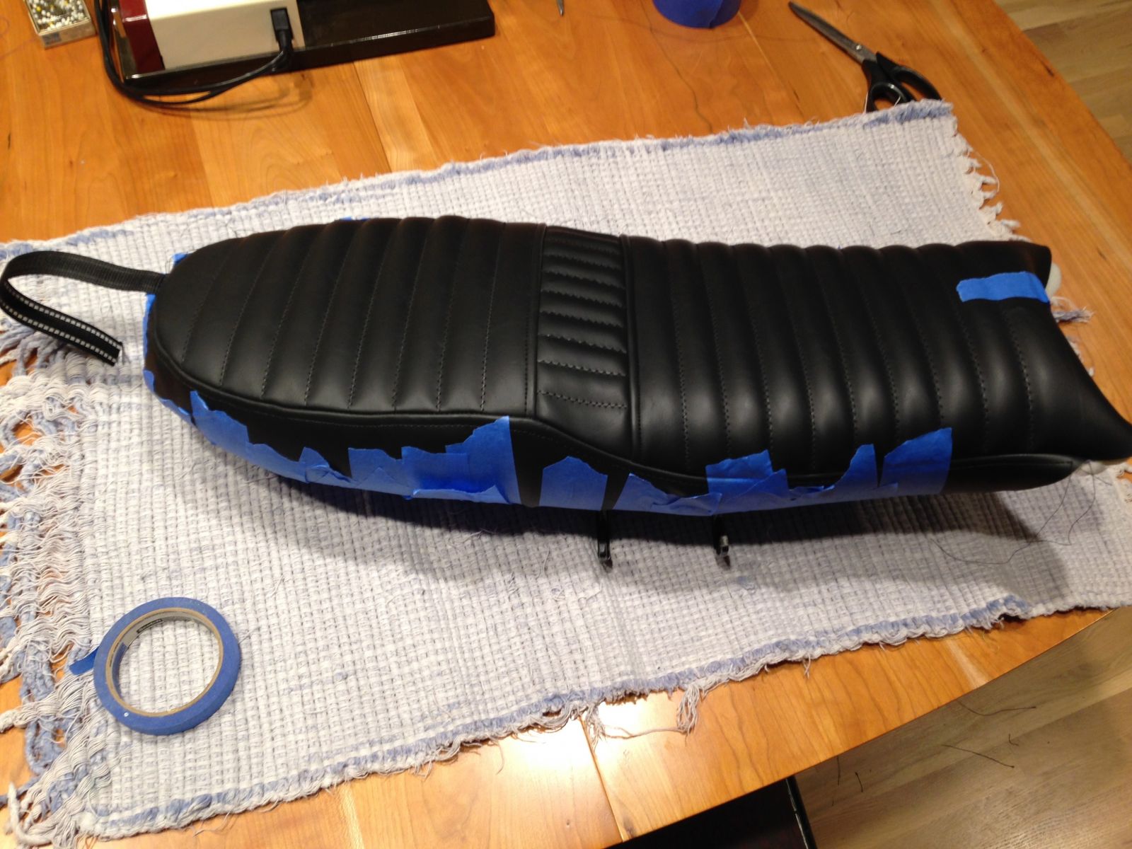

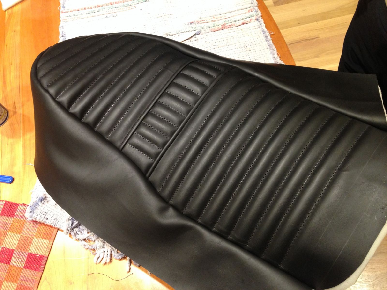

did the first pass on the side panel but almost out of thread . Im sweatin doing the final fold seam where the quilted part meets the side, that seam is over 4 ft long.

seat cover looks badass!
i'm picky about straight seems and yours looks real good.i know why your sweating the long seam.because if it's not right you won't be happy and will have to start all over because you won't let it slide :whistle:

Too true Leon, too true.... thats partially why i went with the zig zag stitch for the quilting, it really helps hide the unevenness of the seam, unfortunately this is just slightly too much material for this sewing machine to work as intended so i can't rely on the advancer alone but have to manually push it through at a constant speed, it makes things a bit...organic.

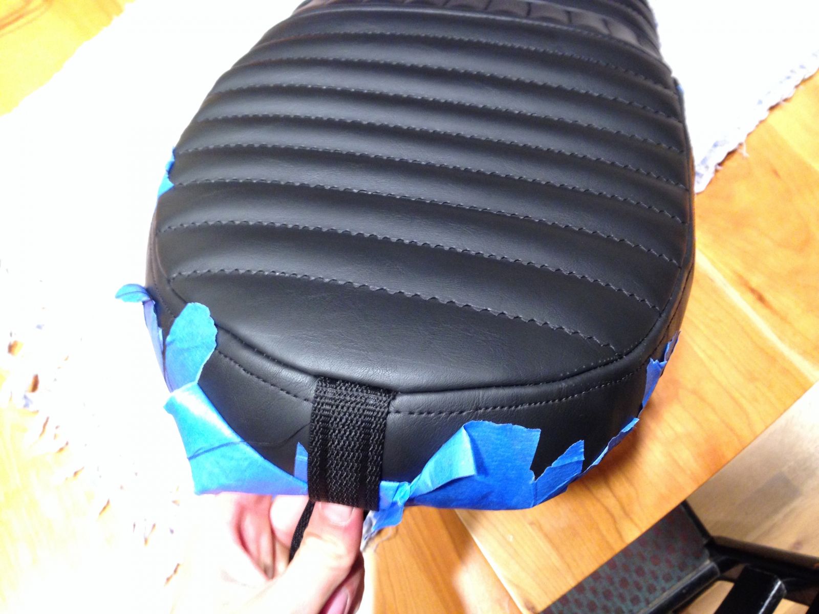

Tonight I finally mounted the courage to attempt the fold seam, had a couple beers and went for it. It came out pretty good, not as nice as i would have hoped but i'm cool with it. I ended up splitting the seam into two chunks, and undid the rear seam to insert some webbing to cover up where the two sides meet. I cut the excess out of the cover and stretched it on the pan with tape so i can make sure that my pattern for the boxing section at the front is still good. In the pic of the webbing on the back you can see some small holes where i removed a seam, i thought i sewed inside those but guess i didn't. i have some vinyl repair stuff that will make them virtually undetectable. :whistle: I don't want to ever make another seat, they stress me out too much, some things are better left to the pros.

Vic, I haven't done a seat yet myself so I am curiously watching your build here with that in mind! Am I understanding that stitching the leather to your underlay is what is encouraging those classic ridges to form width wise as well as in that middle transition section where your pattern changes for an inch or so? I'm loving the detail and craftsmanship and especially the design that is showing because of how you have stitched across the seat. What would you do differently next time? Looking forward to your finished product! Also, what kind of foam are you using for your seat?

30 May 2015 12:52 - 30 May 2015 12:56Jbosh wrote: Am I understanding that stitching the leather to your underlay is what is encouraging those classic ridges to form width wise as well as in that middle transition section where your pattern changes for an inch or so?
Yes I use 1/2" sew foam which has a nylon backing so the thread does not pull through the foam. This is what gives it the quilted ridges. i also use it on the sides as it smoothes out inconsistencies in the foam base.
Jbosh wrote: What would you do differently next time?
Pay a pro!
Jbosh wrote: Also, what kind of foam are you using for your seat?
2" closed cell foam for the initial layer, then 1/2" gel foam over that. followed by the sew-foam sewed to marine grade vinyl using a 92 weight polyester thread. i did the exact same process for my kz1000 seat
