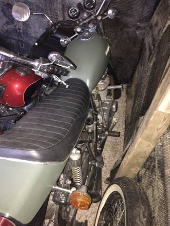

Very nice Doc! Looks just like something I would build! Don't beat me up, but, what about paint on the fenders too? I always painted my fenders the same as the body parts.
Back in about 1990, someone gave me a 1978 KZ750 for free! I took the guages and head light bucket off. Same as the KZ900.
Then I sold it for $100 bucks No Title though. That gut turned it in to a dirt dragster.
It will be very cool when done! Make sure the pipes are loud!
This one keeps popping up on craigslist last couple of years $999.
rochester.craigslist.org/mcy/5379720816.html
