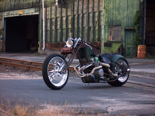

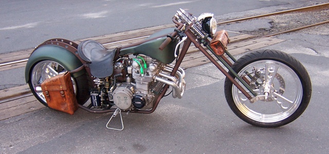

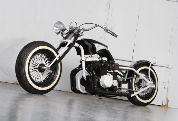

here are some other rigid chops built by
hotshoecustoms.tumblr.com/
using cycleone's frames.
it's not red's first rodeo for sure .material failure? design flaw?long as nobody got hurt and he makes it right.
these are custom bikes and anyone that builds or rides it needs to understand what they are doing and act accordingly.
what size material was used in the cracked backbone?
can't wait to see the next version.
