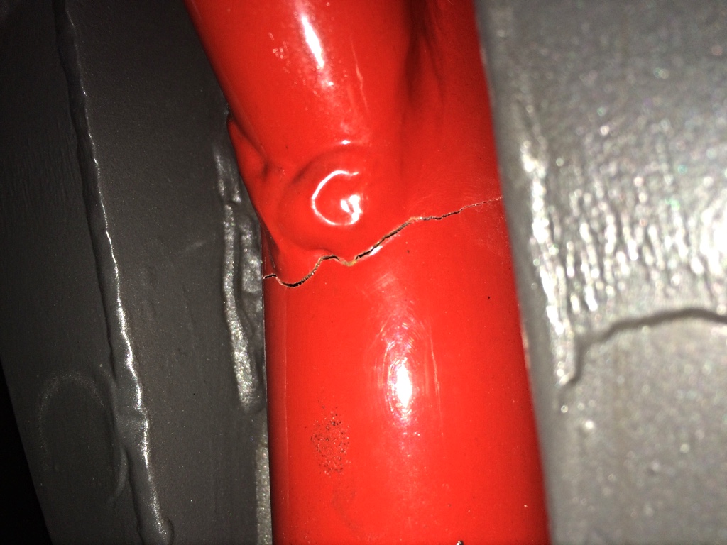

10 May 2015 06:31 - 10 May 2015 06:33Three things I see that concern me that I would change.
1) that weld looks like #$%&.
2) the wall thickness of the tubing is really thin.
3) a gusset is needed on that joint.
The weld is fine- it's bonded so well that the station pipe is actually taking a chunk out of the backbone.
Agreed- already discussed this with them.
It's a good idea in theory- but the reality is, that area would be difficult. The angle ~155*

It wouldn't have left my bench like that but that's not the problem. From time to time we would have to put one of our parts in a vise and try to break the welds. This one passed. The material failed. With a little beefing up it might be good to go as long as the metal is sound.
Nonsense, no amount of engineering or fabrication is to difficult when your neck is on the line.

That glob of weld is from pulling away at the end of the weld. Poor form. It should have been reversed at the end.

11 May 2015 05:10Let's say you're right...Nebr_Rex wrote:KzChop82 wrote:Nebr_Rex wrote:
Pretty sure my frame is still fuc%€ed.

I don't blame you. Your life was depending on the quality of that frame. If you don't mind my asking, where did you get it? Foreign or domestic?

Personally, I think it's asking a lot to have a single downtube / single backbone frame handle the weight and power of a KZ1000 engine. I'm not saying it's a physical impossibility, I'm only suggesting that if it is not designed by an engineer who thoroughly understands the dynamics and forces that will be applied the chance of failure would seem to be pretty high. I notice Kawasaki did not build them that way even though it may have been cheaper and lighter. Ed

When I first saw the bike I thought, that can't work. I didn't say anything because I didn't want to belittle his bike. Judging by the lack of quality of the weld, makes me question the quality of the metal. :dry:

11 May 2015 07:11
Domestic, cycle one manufacturing.
