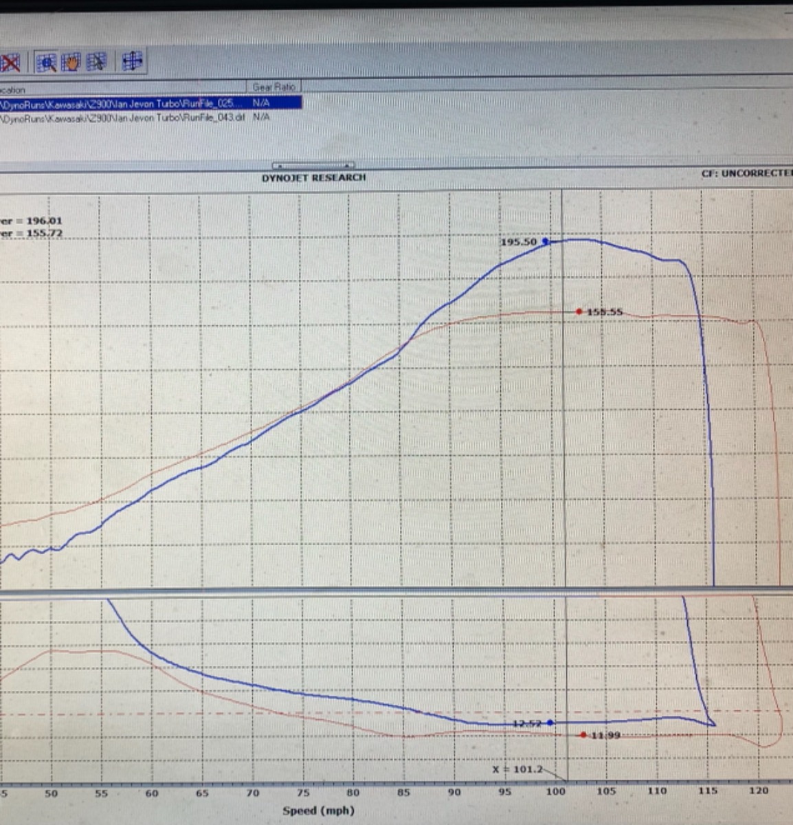

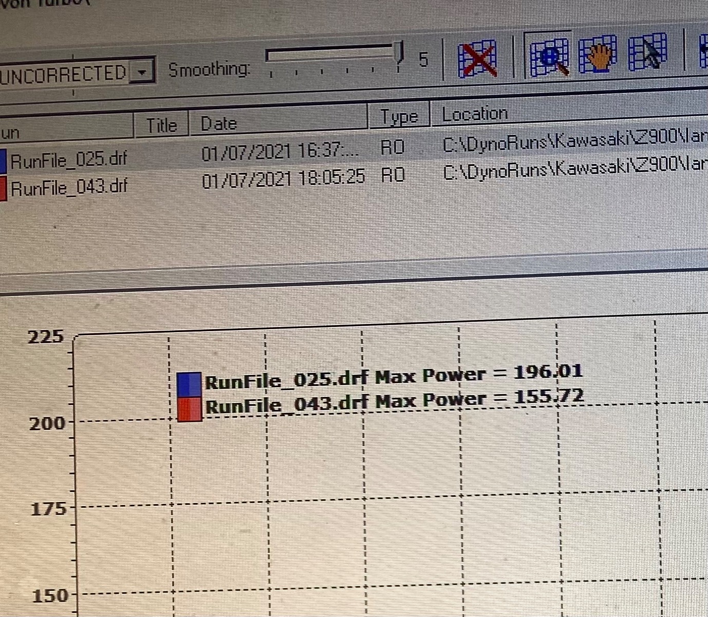

16 Jul 2021 20:19That's a good number. Can you post the curve so we can see where the power is. How much boost were you running?First Dyno session! Still some work to do

Re: I found a old turbo drag bike
17 Jul 2021 02:13 - 17 Jul 2021 05:50
10psi on the 196 with the old F40 Rayjay with the original bendix zenith. Some work to do on the fuelling bottom end and mainly want to figure out where I am with the ignition timing as this was an initial “ guess” Got no plate on the vertex so unsure of advance at the moment. Will set the initial static up and take it from there

17 Jul 2021 05:52
Good numbers.

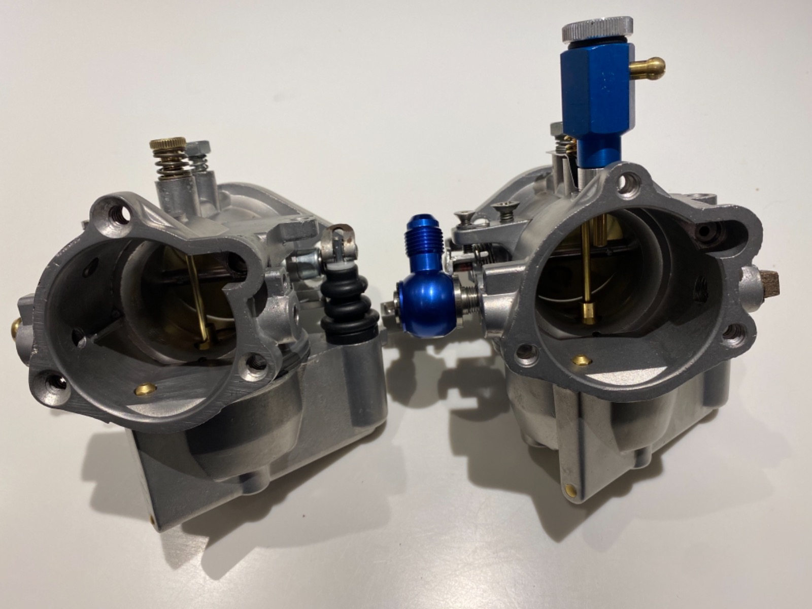

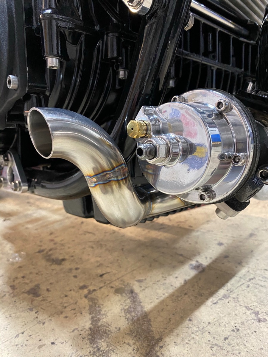

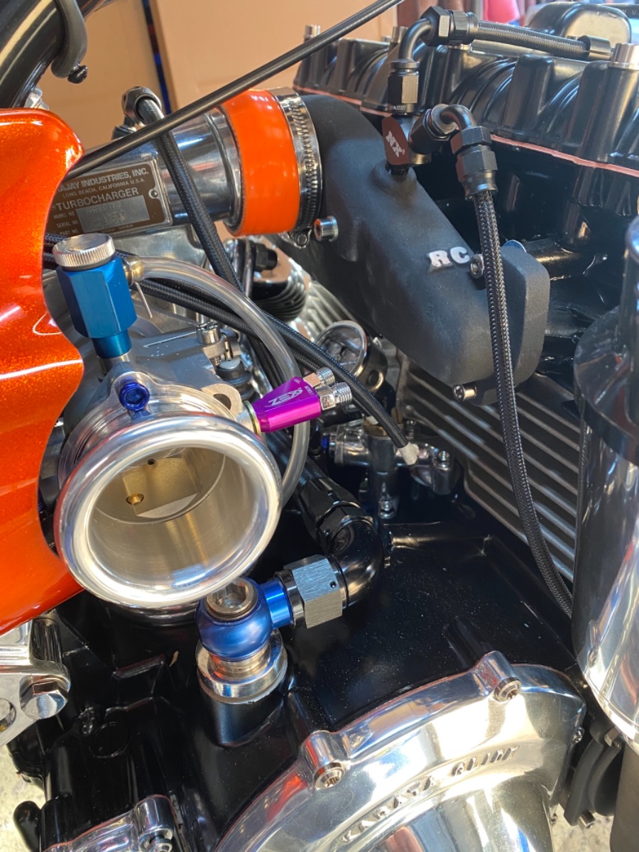

Running original RC engineering turbo plenum, headers and wastegate with a Rayjay F40 turbo. Carbs an ATP Bendix with added Thunderjet circuit running 4psi fuel pressure
No water or Alcohol injection but have a vintage ATP unit I might fit
Sunoco Maxnos 119 fuel
Stock 900 hollow cams with flowed head standard size valves
Plugs are NGK B9ES
Nitrous is fitted and ready to go!

Looks like you are well on your way to having a real runner.
250 HP is a very easy safe bet. before the nitrous hits
I changed mine over to the Mikuni 42mm flat slide some years ago and I find it to be a winner.
