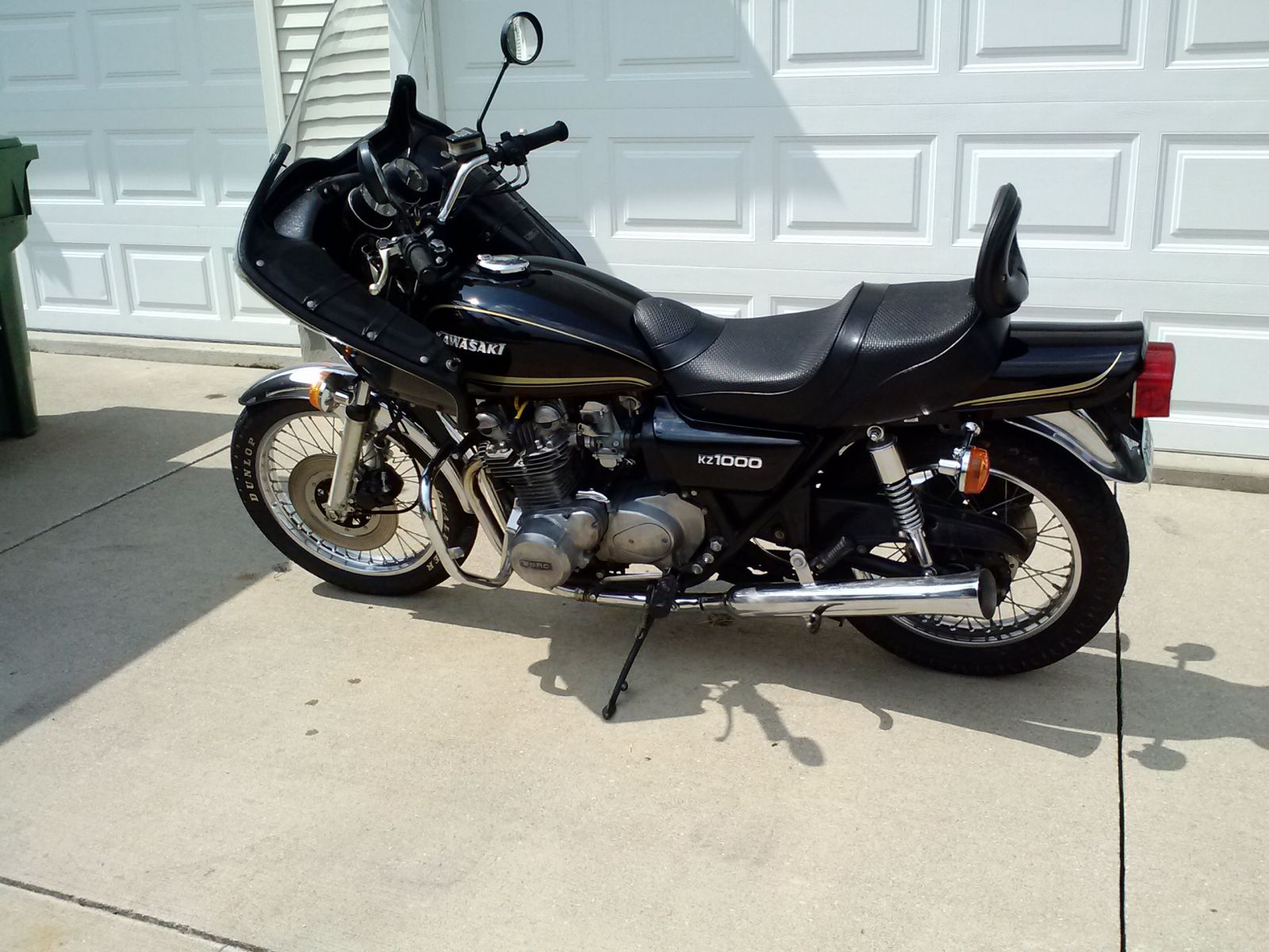

I bought this '78 last fall and haven't had much time to work on it. I was hoping to have it together for this summer but I don't know if I'm going to make it. Anyway, I wanted to document my progress in a thread so here we go...............
KZ as purchased:
KZ as purchased:

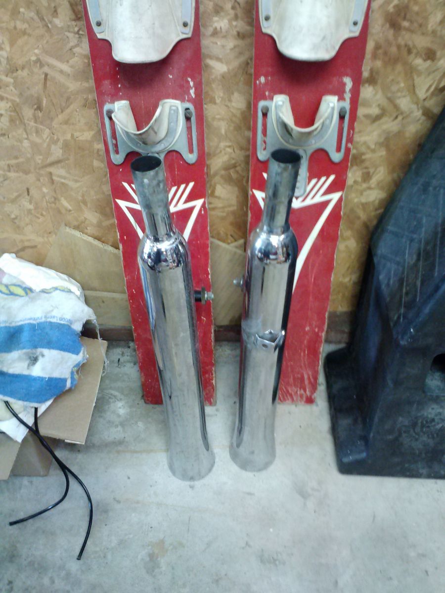

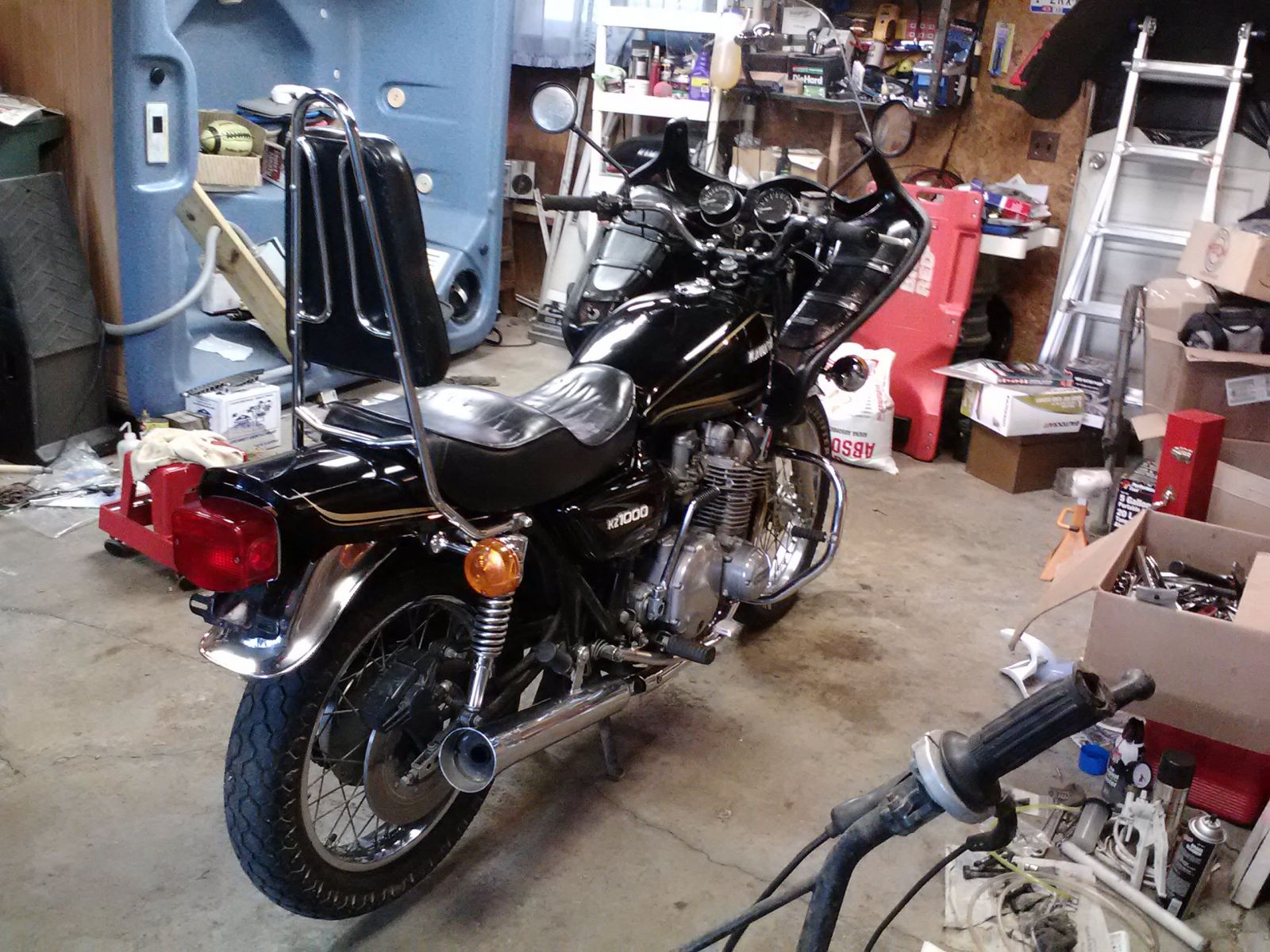

So the bike has aftermarket slip-ons installed on the stock head pipes. They pulled off very easily.....does the stock exhaust have removable mufflers or were they cut off? I'd like to have a stock system for a factory restoration one day. I've never seen just the mufflers for sale though....

Man, that is really nice. Are those Jardines? They look so stockish. I can't remember if my LTD pipes were bolted on like that. There are several pics that have those same pipes. Must have been a popular alternative I guess.

I was thinking Jardine too...I'll have to look to see if there are any brand markings on them.
I've seen a lot of these mufflers over the years. I think they were used mainly to replace rusted mufflers instead of replacing the entire exhaust system, but I'm not sure. Maybe for looks/ sound too?

That bike looks clean! And set up for comfy X-country riding..what's the plan with her?

Well I already pulled the fairing and the sissy bar! I'd like to get something a little smaller and sportier for it. I couldn't get used to how heavy the front end felt with the Windjammer and it really traps the heat on summer days.

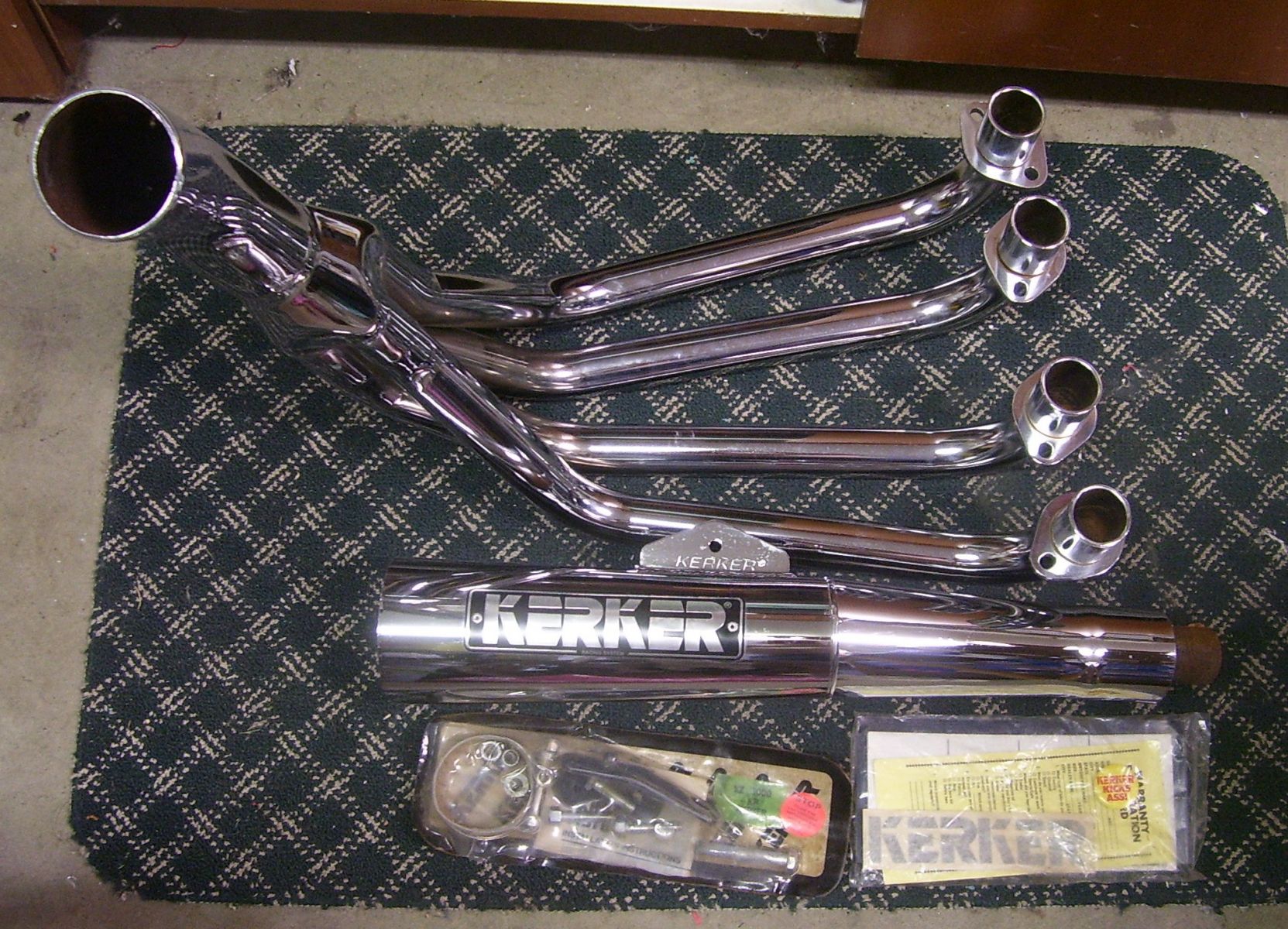

I haven't posted pics yet but I've started working on a GS1100 swingarm conversion. I also rebuilt the carbs, replaced the intake and air box rubber and switched the points over to a factory KZ electronic ignition with Andrews coils and new plug wires. I also have a nice NOS Kerker racing system for it and a 3.5" rear rim with a 150 tire. I want to get new progressive front springs and a good fork brace. I also plan to do a 530 chain conversion and replace the front tire, along with a brake upgrade front and rear. For now, I'll probably just rebuild everything and go with EBC rotors and SS lines. Probably have a few other things in mind that I can't think of but that's the plan.

That pipe will look real nice on it. Nice looking bike!

Yep, that's the pipe!

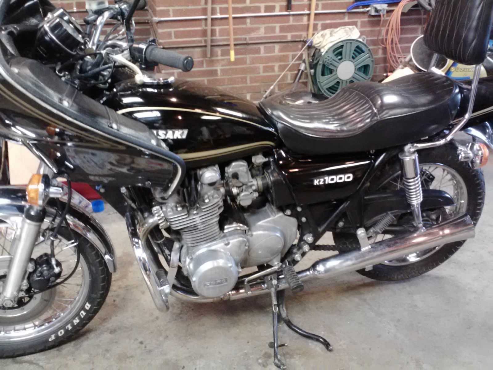

Here she is with the sissy bar off, Corbin GFL seat on:
Transition period before removing the fairing.
