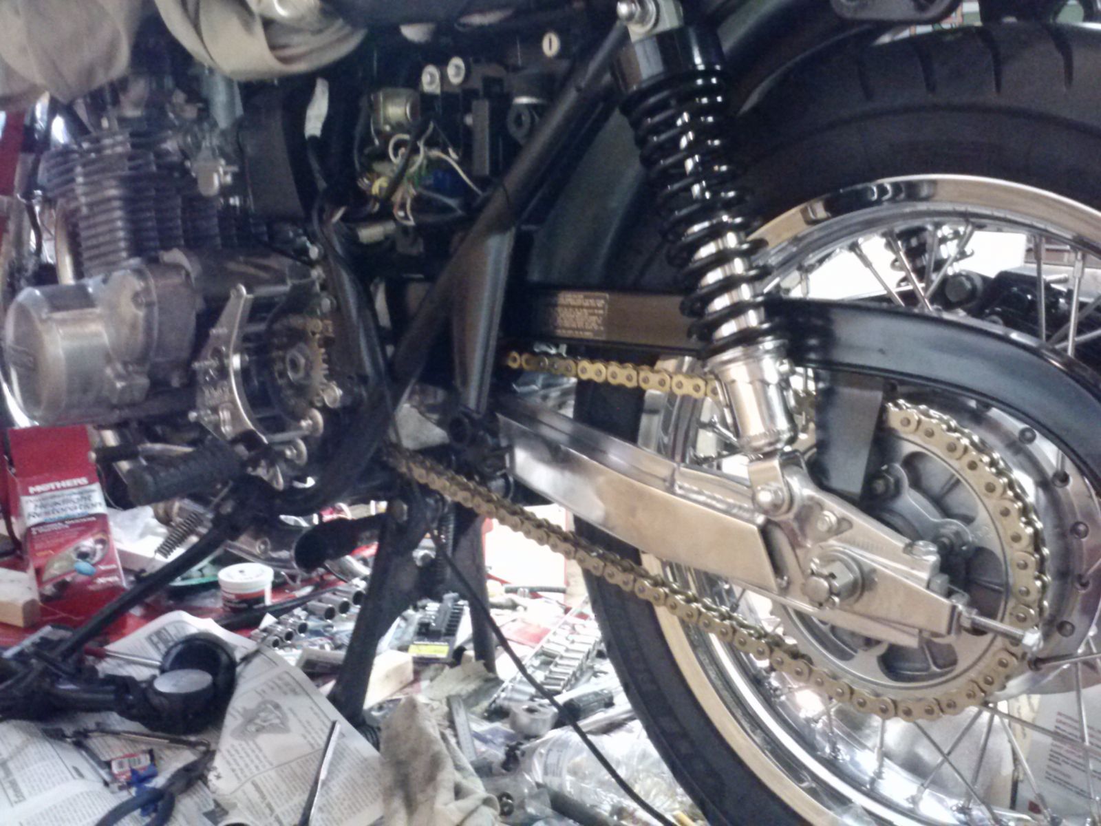

Thanks Les. So we know a 1/2" offset will need some clearance. Did you remove the insulating foam from inside the sprocket cover?

I had to remove a bit from the inside of sprocket/clutch actuator (or front chain" cover") in order to have it clear my 1/4" offset sprocket on my '73 Z1-900. Plus I added washers to the inside of "engine sprocket cover" so that it too would clear the 1/4" offset sprocket.

I put mine on a diet, not needed, gone so I really couldn't tell you if the sound deadening would have been in the way. The ZZ2 drag chain I'm running is wider than most o-ring chain and my chain just touches the frame on occasion. To be honest it's a 12mm offset so it's less than a 1/32 of an inch closer to the motor. .472 vrs ,500 of an inch. People in america can visualize 1/2" better than 12mm

i run a 3/8's offset 520 o-ring chain and had to remove the sound deadener and clearanced the back edge of my countershaft sprocket cover .

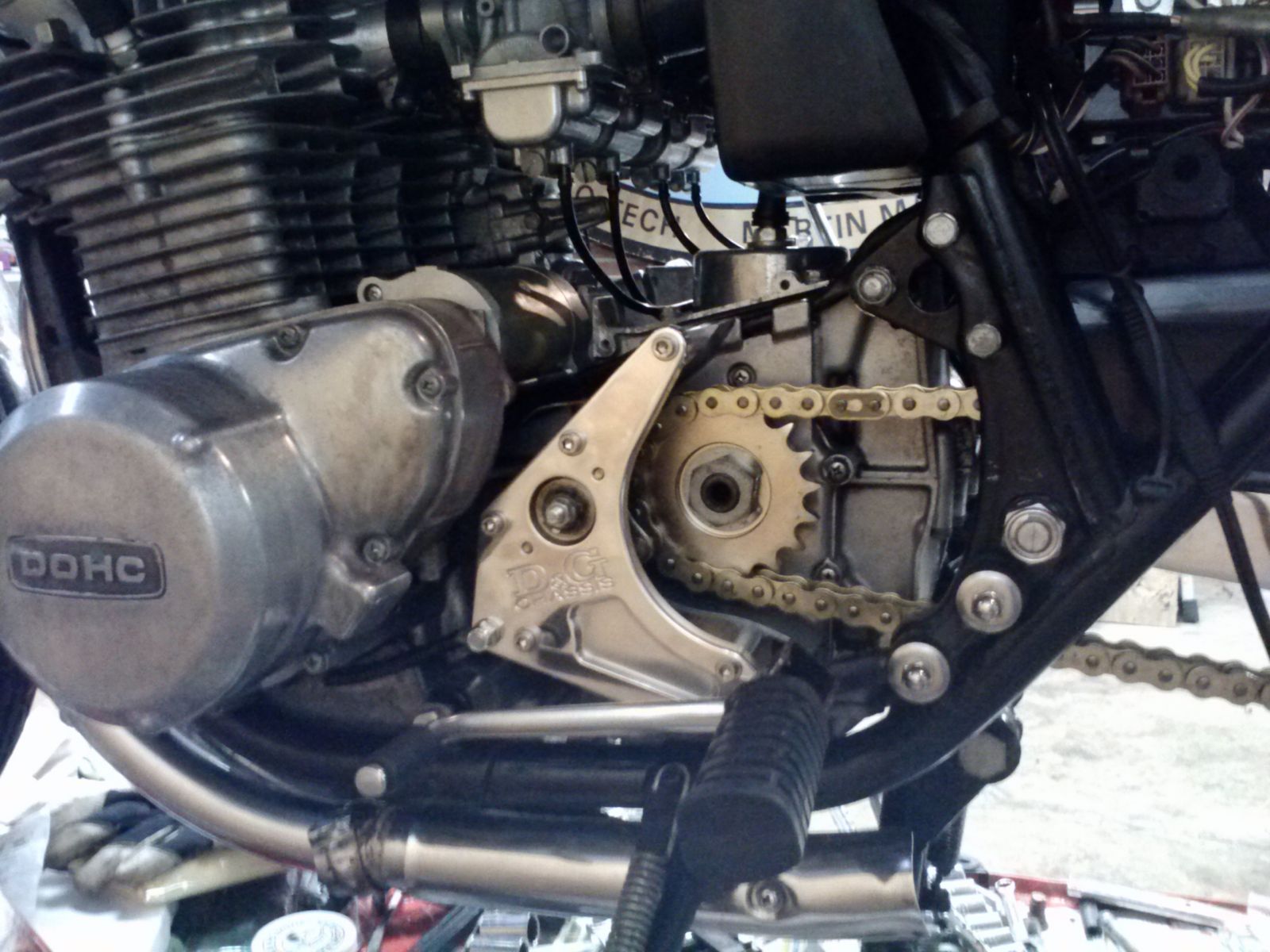

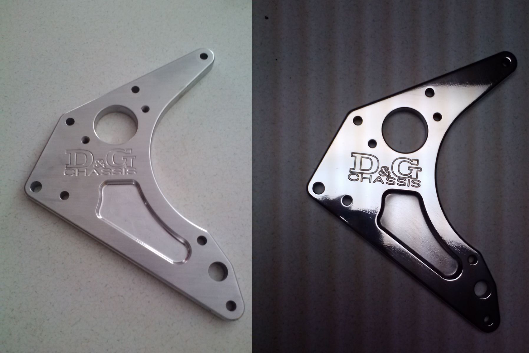

I decided to go with an aftermarket clutch release kit to get the needed front sprocket clearance. Started off by polishing it:
Got it installed (not a great picture):
Also made much progress on the GS conversion...it's buttoned up and ready to go. I'll probably mod the chain guard at some point to lower it down:

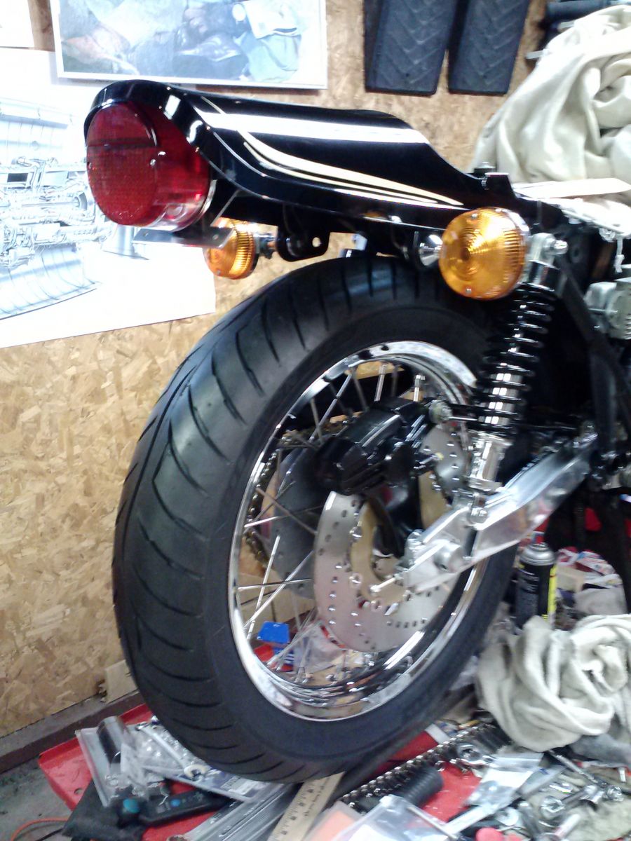

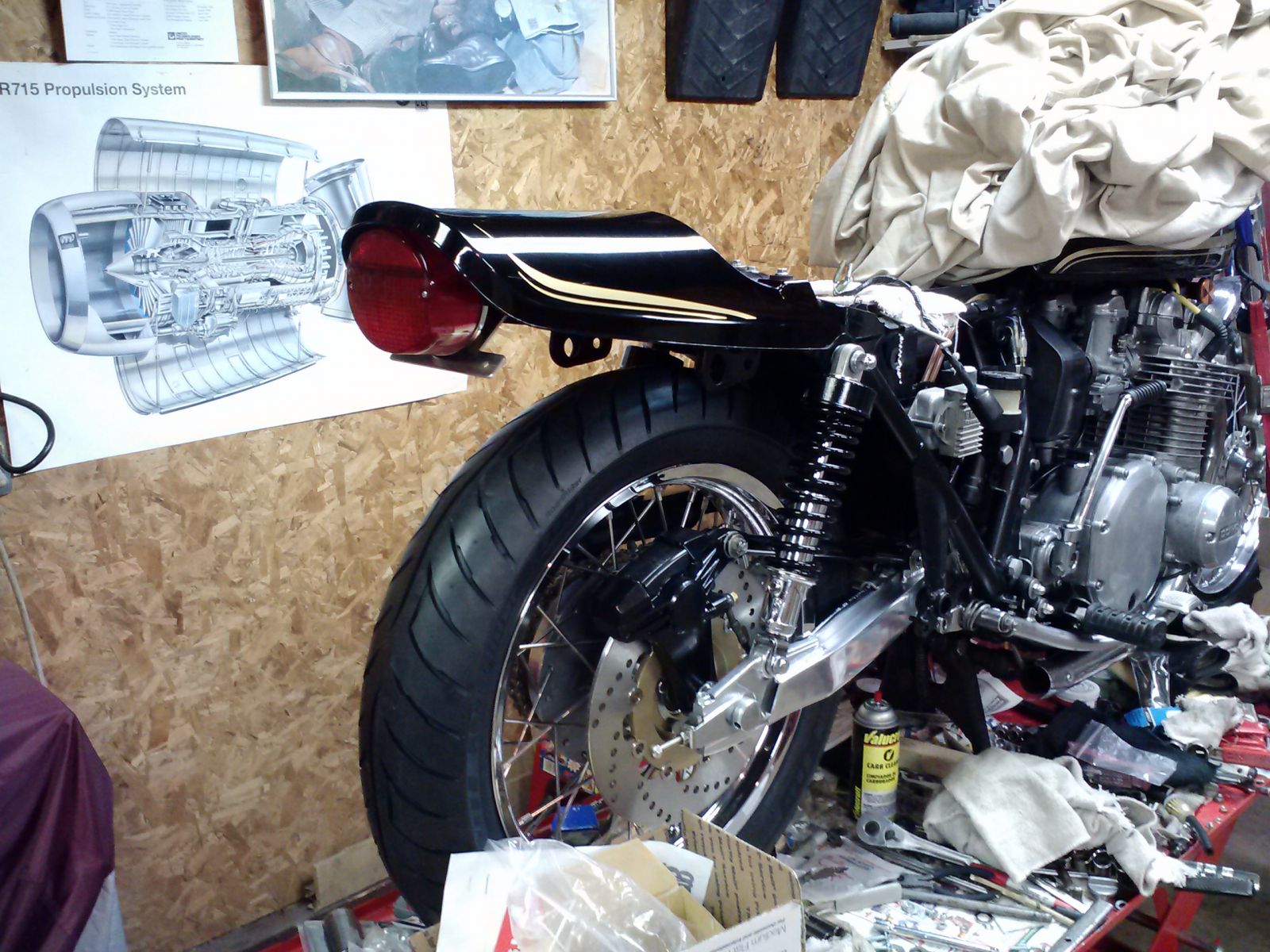

I also got the rear fender eliminator installed. I decided to go with a Z1 tail light...I like how they look when they're tucked up real tight against the tail:

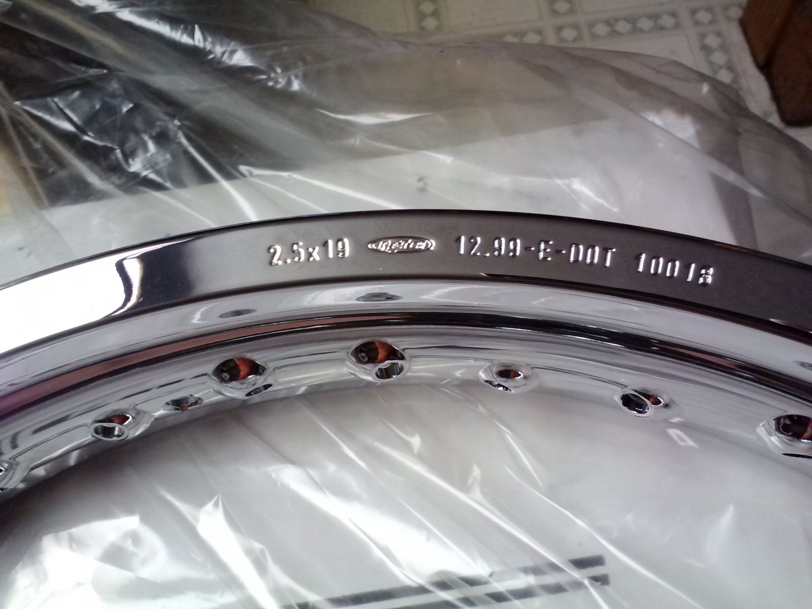

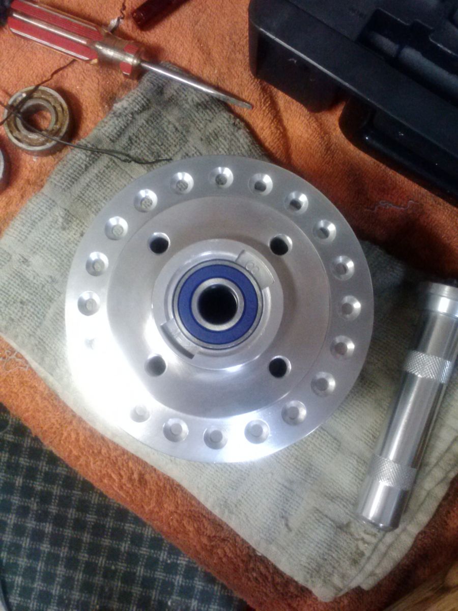

I also started on the front end project. I found a nice aluminum front rim so I'll have aluminum front and rear...it is way lighter. I started with a used hub, polished it, replaced all bearings and seals and had it laced to the rim with Buchanan's SS spokes. The front rim is just a little wider too at 2.5".
Also got the rear turn signals back on with shorter stems:

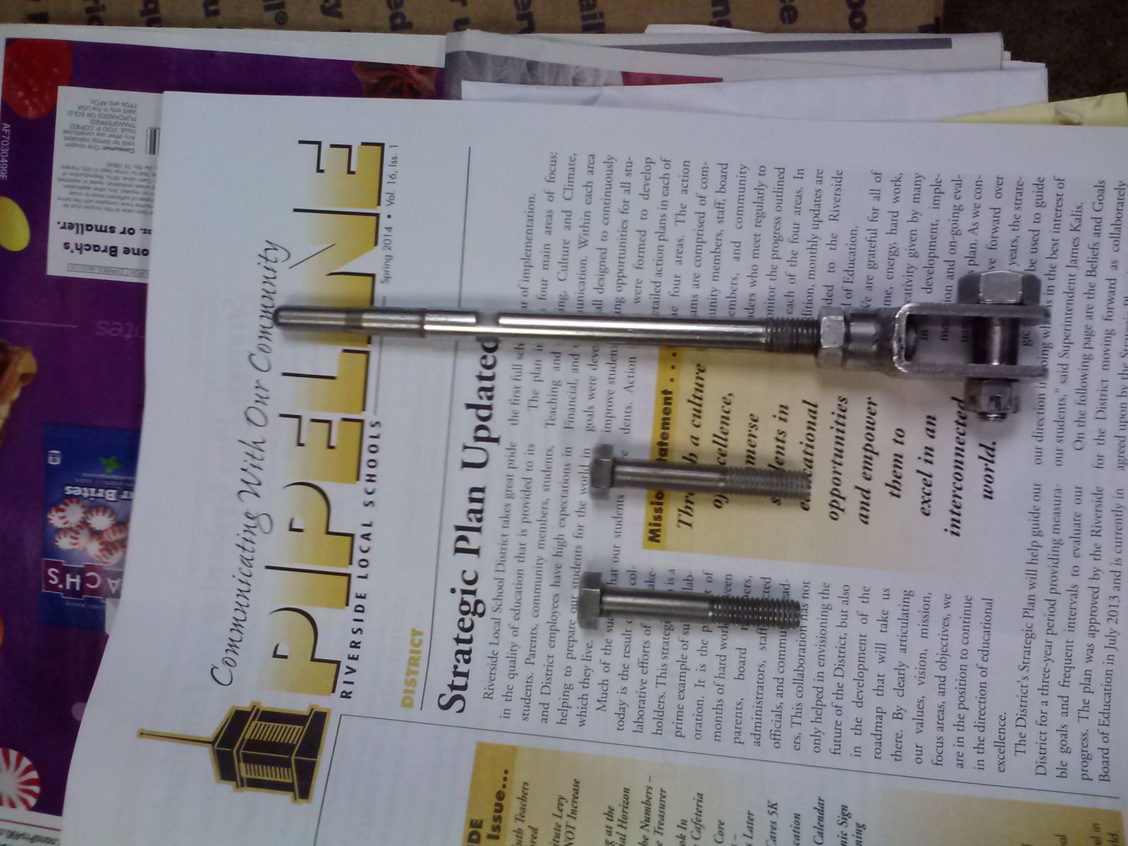

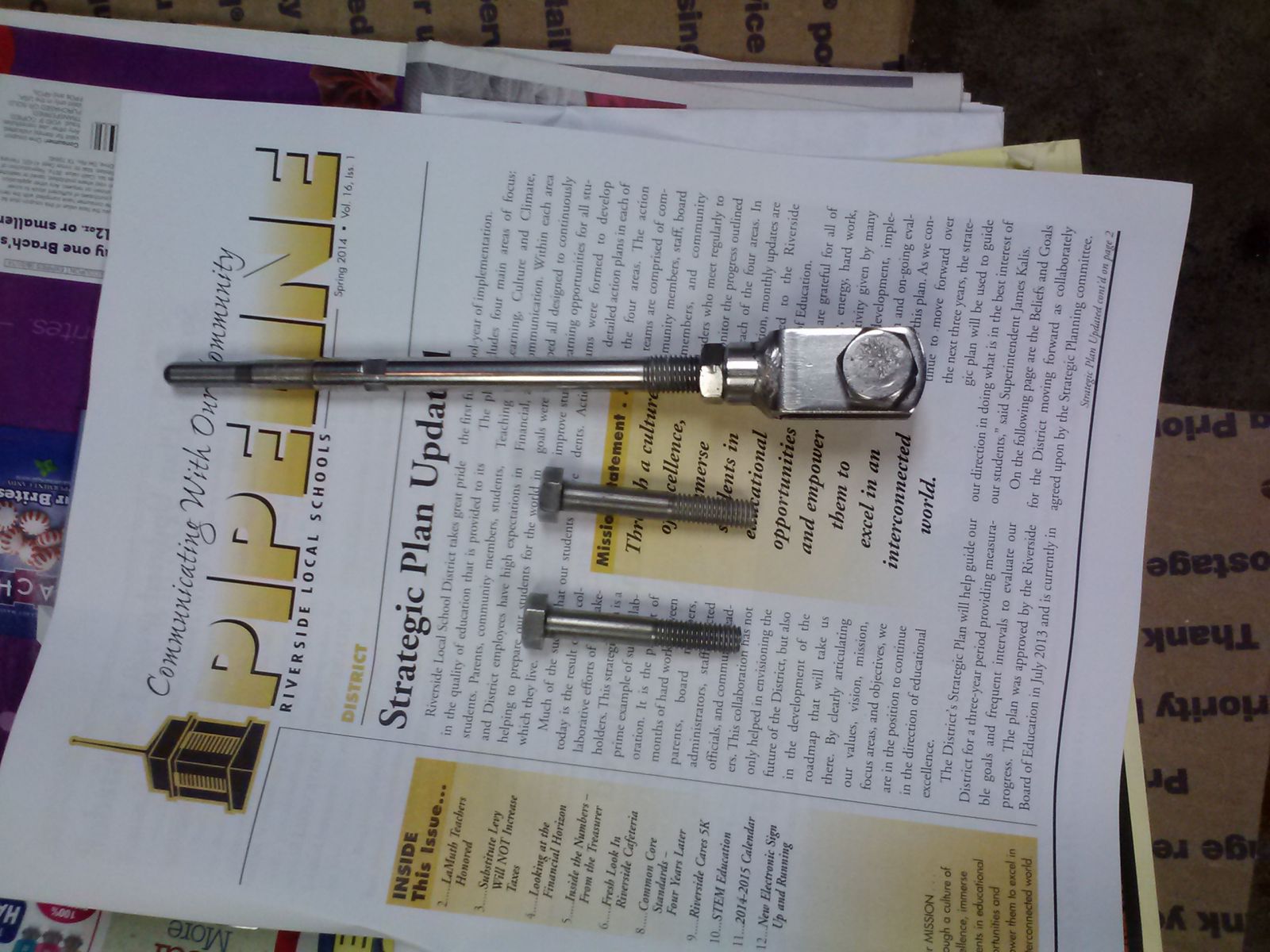

I bought one of those Eastwood tin zinc plating kits and it works pretty well. The rear brake m/c push rod and bolts look much better now:

I like that look too, with the Z1 tail light & fender eliminator !!
what did you use for the eliminator ? & how did you mount the light ?
