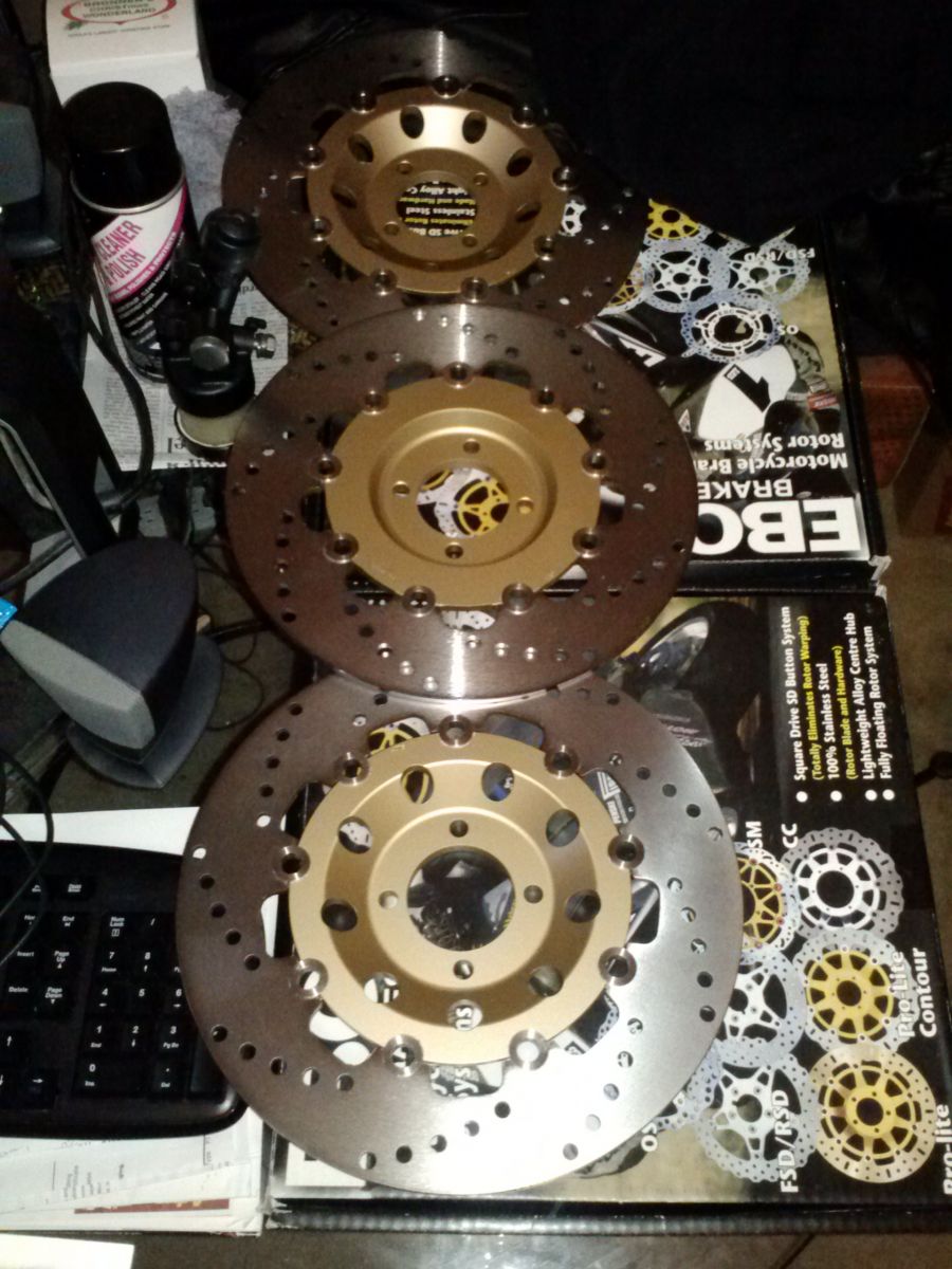

Got the brake discs painted....hoping the gold won't be too much....should match the black and gold paint pretty well and they don't really show a whole lot anyway, especially the back one.

79MK11... you using spray can to paint disks?

08 Dec 2013 18:23spdygon wrote: 79MK11... you using spray can to paint disks?
nice project...
Yes, it's engine enamel with ceramic....rated to 500 deg F. I'm thinking it should hold up to the heat pretty well. I also baked them to make sure they were fully cured.

ok.....so should of ask this on the last post...
did you take apart the disk ( if you did how do you do it ) or did you just do a great tape job?

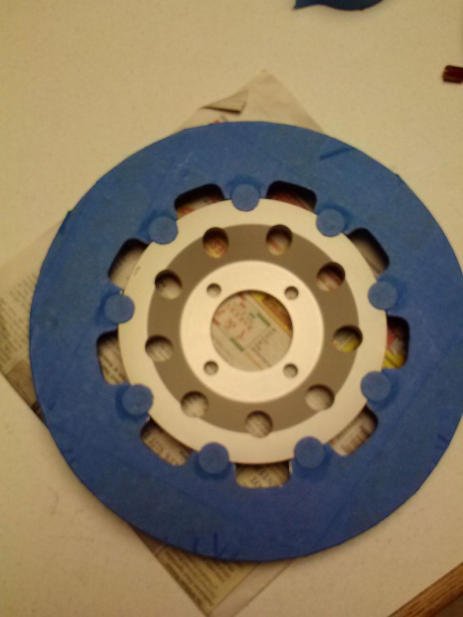

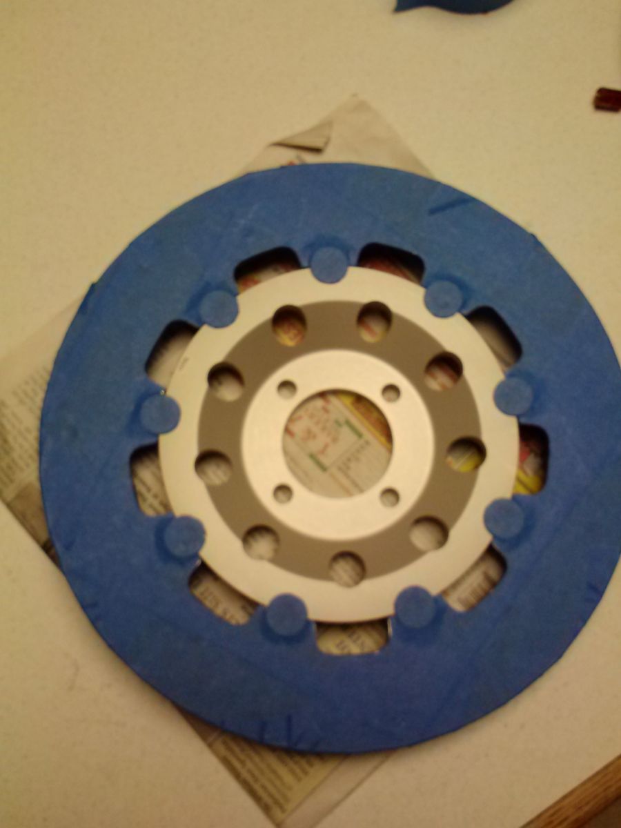

I wanted to take them apart but I think they are assembled permanently. Some floating rotors have circlips that pull off but these appear to be kind of riveted, I guess. No way to take them apart and get them back together without all new hardware and a special tool. So, I spent a lot of time masking:
