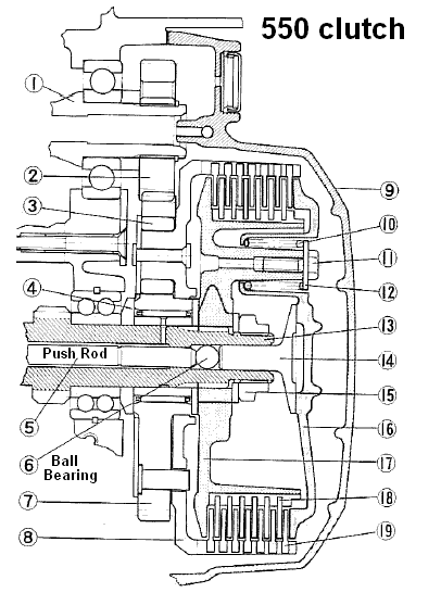

3. I took the clutch cover off and the push rod had slid out a bit. now nothing will go back together correctly. someone said there might be a ball bearing that fell out. I have the clymer manual but dont see anything about the push rod.

No, you will not be able to push it in with your hand. Lot of pressure on the clutch pressure plate. Have a look at the manual and parts fiche. You'll see there is the Arm in the sprocket cover. That has balls/ bearing under it and needs to be positioned correctly, cleaned re-lubed. Also adjusted by the worm gear screw and lock nut.

The ball bearing can't come out through the pushrod hole on the chain cover side. It only comes out if you pull the clutch cover, remove the clutch hub and pusher mushroom.
As Topper and Motorhead said, the rod won't feel springy or be push-able by hand.
As Motorhead said, there are a bunch of manuals and other 550 info in my signature.
There is also a description for the pushrod adjustment in my signature, BUT there is a good chance your 1980 KZ550 does not have the ball-ramp type actuator. Yours is morelikely the large helical actuator. The manuals will describe that type.
The helical actuator is described in the white base manual starting on page 22 (29 of the pdf).
The ball ramp type is described in the white base manual on page 319 (326 of the pdf).
