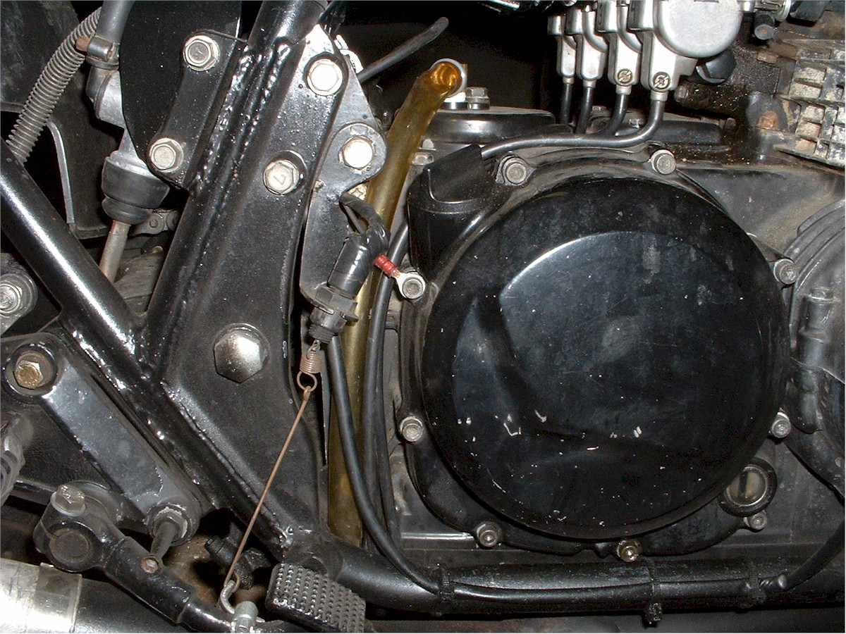

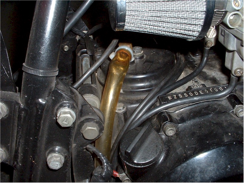

Other options include:
JBWeld;
Snugly fitting plastic hose fitted over the cracked tube.
JBWeld;

I am convinced it is alcohol laiden fuel, or some other new additive, that is cracking these brass tubes. It was unheard of 15 years ago. Also about 10 years ago, I started seeing more and more bikes with brass floats that were just cracking and crumbling. Luckily the 550's don't use brass floats, but the tubes are still problematic. It may be better to replace them with stainless steel. I wonder if that would hold up?

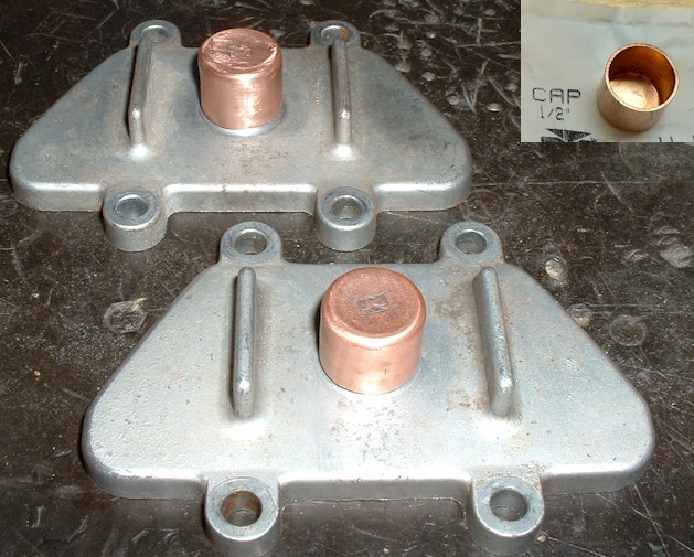

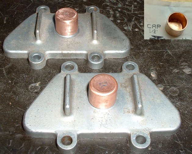

As long as the airsuction stuff is capped off, it should be fine. If it needs to be capped off, this is the least expensive way: Heat the 1/2" copper cap to red hot, then press it on. Support the casting from the bottom so you don't crack it. Leave the reed cage in there as that forms the seal.

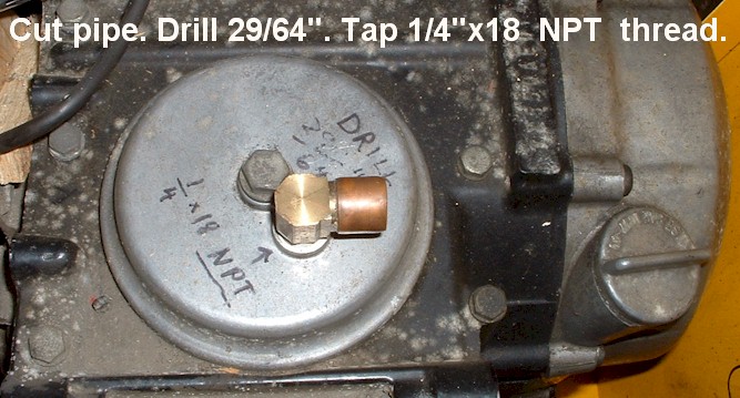

Here's what to do on the breather:

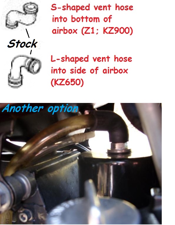

A non-drilling option for the crank case breather could be a snug fitting rubber "L" hose connected to the nipple, plus the longer hose routed for exit to open air underneath the bike.
Be sure to keep the interior diameters of the L-hose and extension hose large enough to allow unrestricted air flow, ideally as large as i.d. of the syock nipple.
