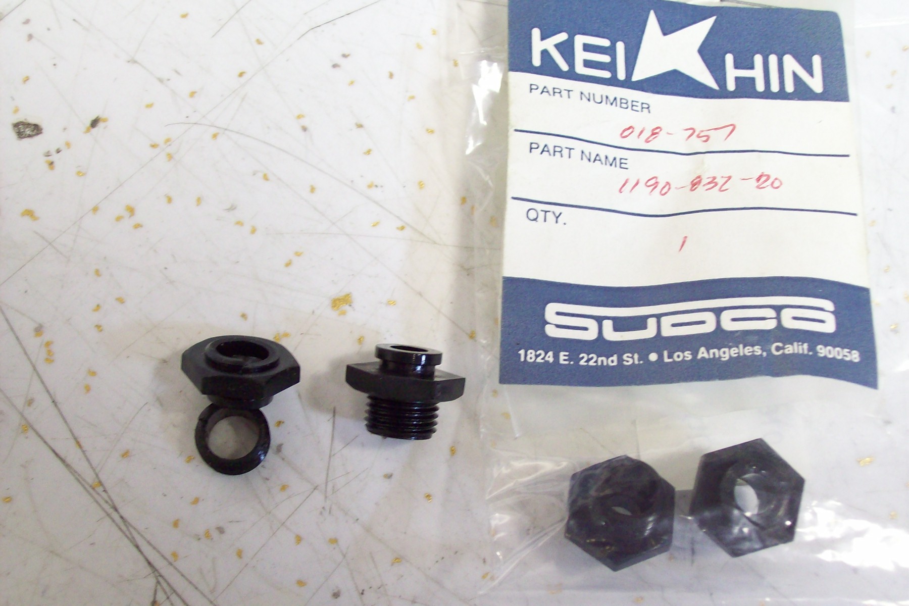

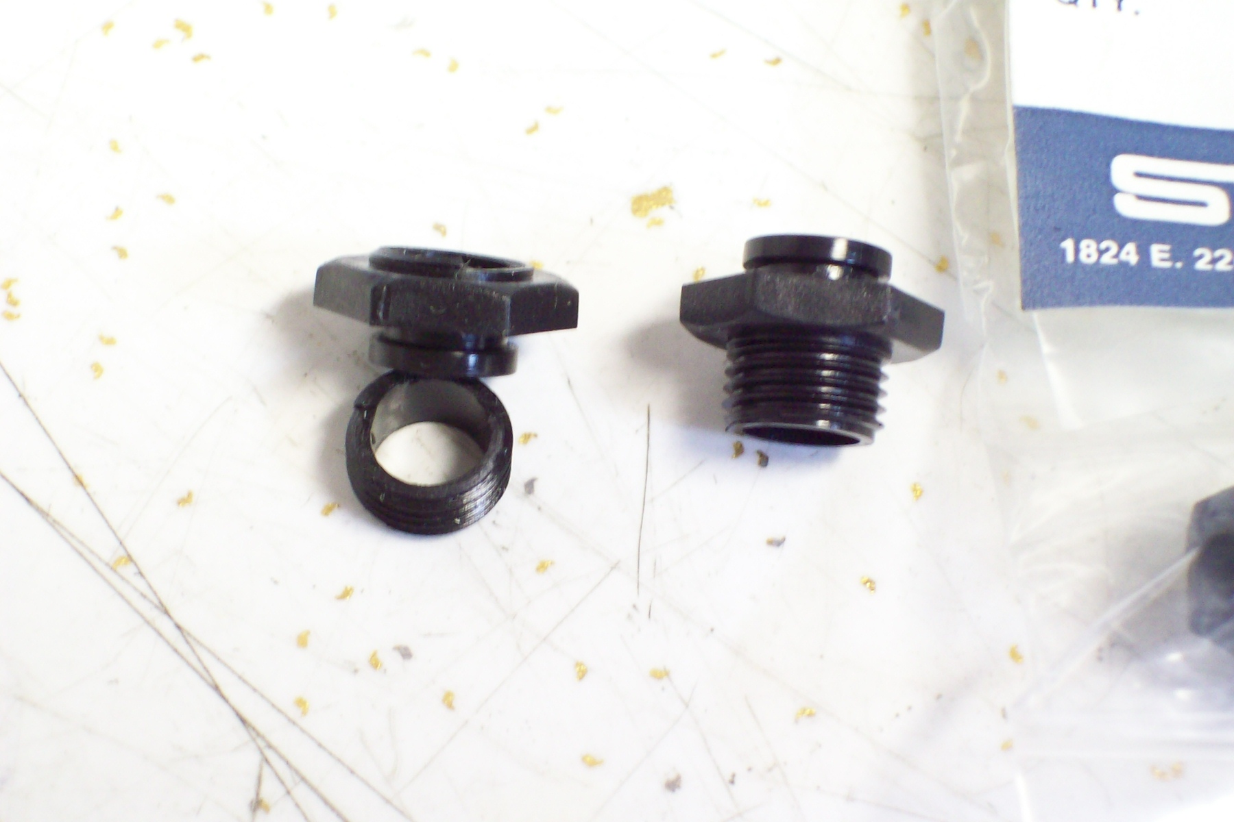

One of the joys of owning a nearly 40 year old motorcycle is how perfectly good parts just seem to break from just sitting there!!!! I went to fire up the Superbike to take a few quick trips down the deserted roads near my house. As I was gently warming it up, I noticed one of the enrichment plunger plastic nuts rattling around on top of one of the outer carb enrichment plungers!!!! What the hell!!! I found that the plastic piece broke into two pieces. GREAT!!!! I had to disassemble the choke rod and the pieces that fit around the end of the enrichment plungers just to get to be able to replace that plastic nut!!! Its really nice having all the spare parts I need right in house!!! Thank God I didn't have to order ONE STUPID LITTLE PART. Two years ago I did have the carbs completely apart, and did have all the enrichment plungers and nuts out of the carbs. I must have over tighten that one nut just a bit more than the other three. Its really amazing that 2 years later that plastic nut decides to break into two pieces!!! Like they say, $hit happens!!!
