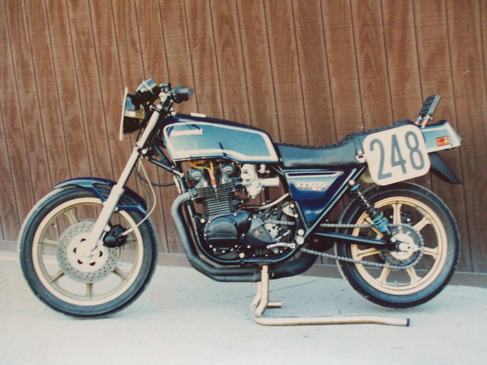

What it looked like in its final season of road racing.

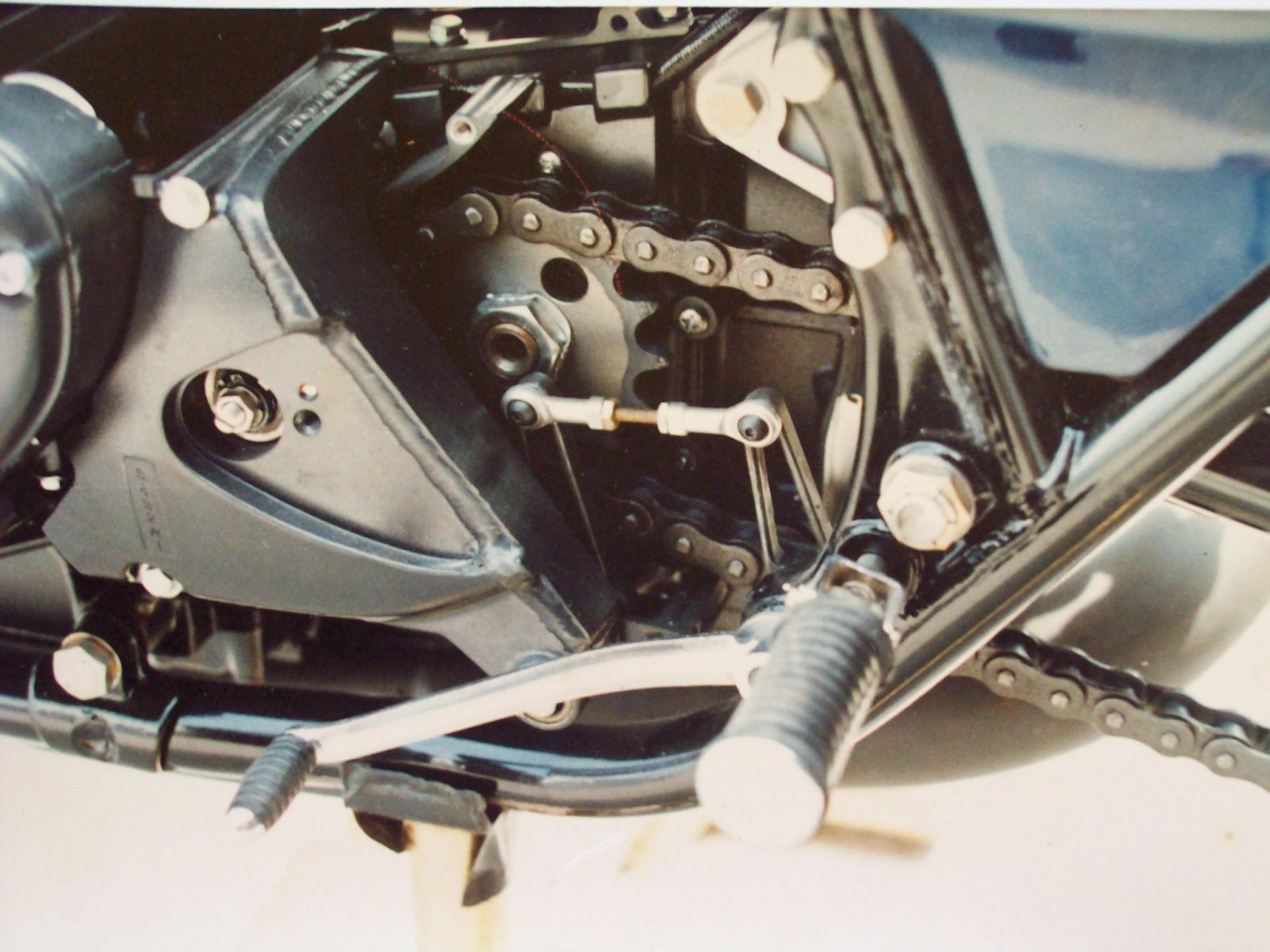

Do you have any detailed pictures of the sprocket cover and foot pegs?

Thats the only picture I have right now of the cut sprocket cover, and feetpegs. The feetpegs are just old H2 triple buddy pegs mounted in the upper hole where the two studs go for the stock feetpeg bracket mount. Now the shifter linkage is a true work of art in my book. I put a bronze bushing in the lower stud hole for the stock feetpeg bracket. I had a stock shifter shaft cut down, and those triangle pieces made at my old machine shop I used to use back in the late 70's. Those shifter parts were changed to something like what came on a KZ1000R back in 1982. That shifter setup you see in picture is sitting in a parts box some where in my Superbike parts collection. I was mounting all the KZ1000S1 feetpeg brackets, pegs, and rear brake setup when I packed it all away to work on my GSXR750 back in 1986.
Thats one of the projects I have to finish to get the bike ready to ride. I just hope my handmade tuckup Bassani pipe clears the righthand S1 bracket.
