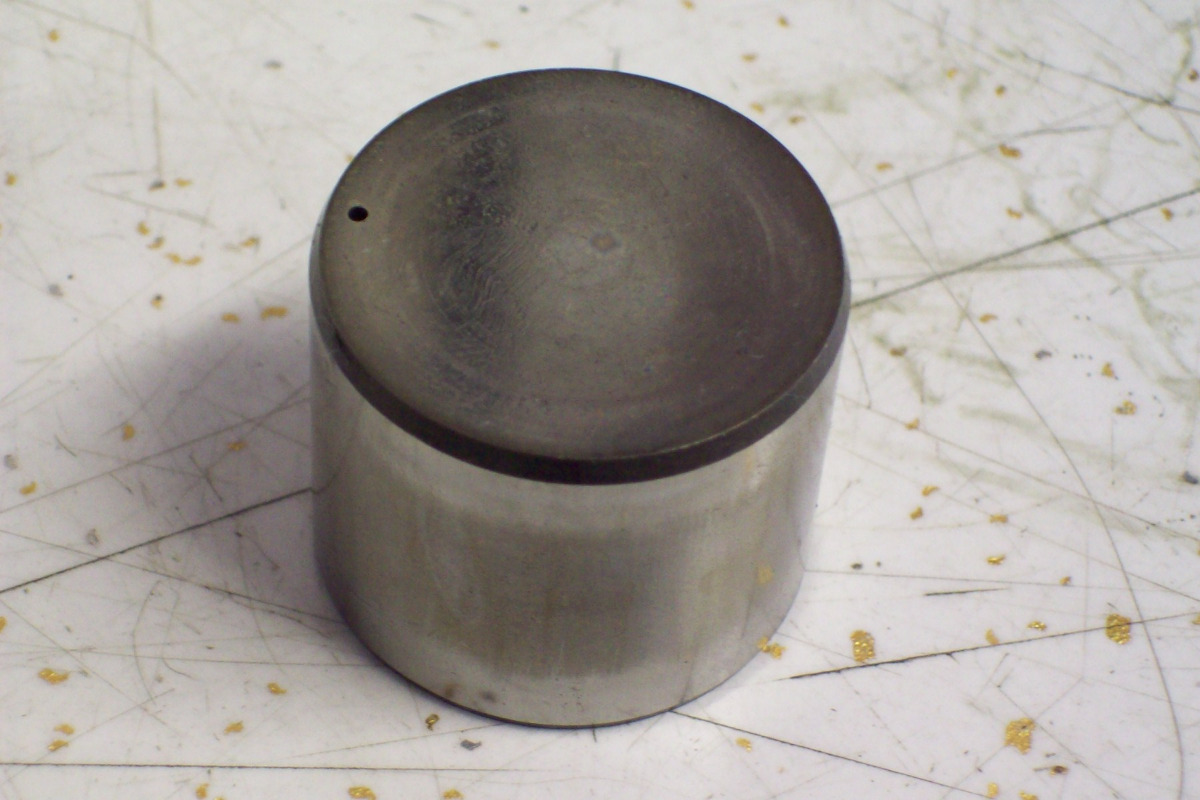

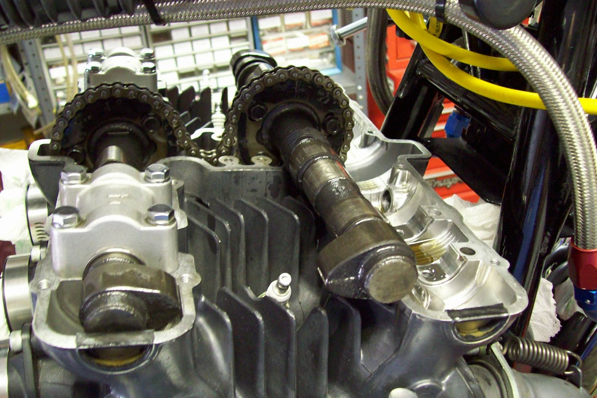

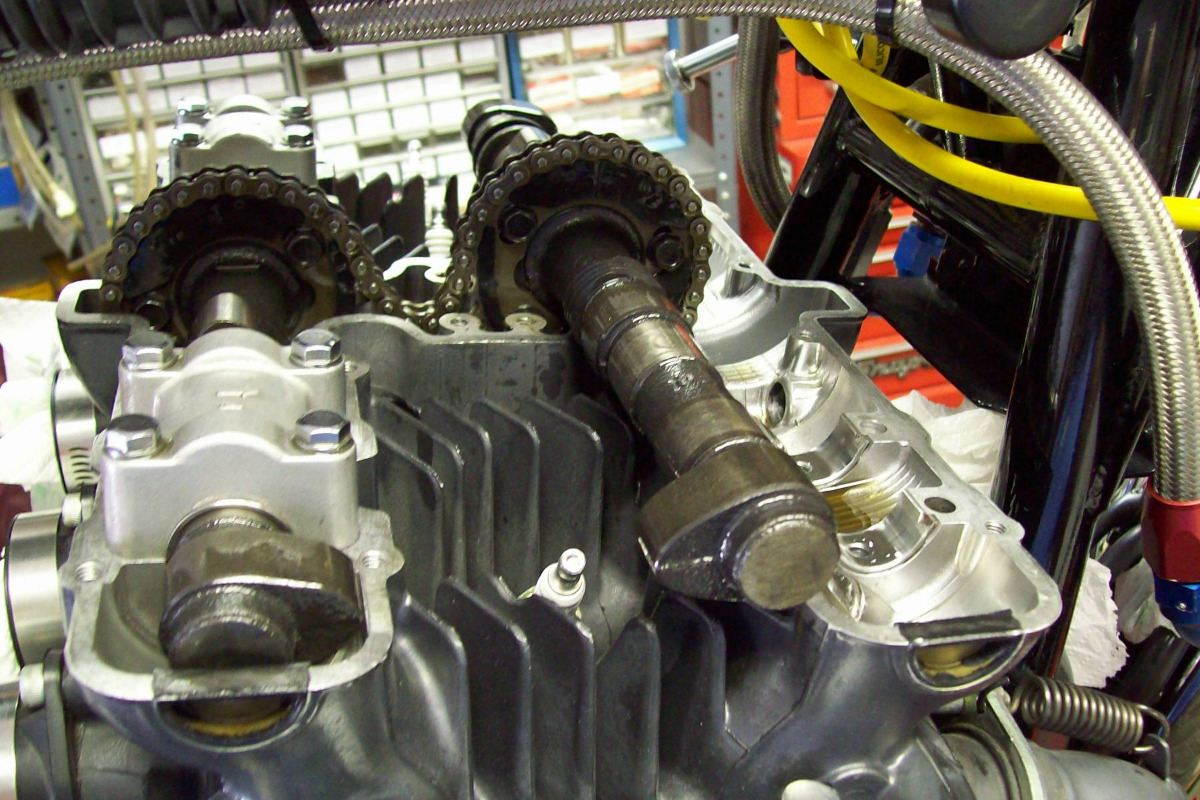

03 May 2017 16:12 - 03 May 2017 19:10Luckily they were all on the exhaust side. Here's a little trick. The shop manual won't tell you that you can pull just the exhaust cam, but if you follow a few important steps. You can!!! #1 remove the top center tensioner if your motor has one. #2 Back off your cam chain tensioner. #3 Remove cam caps. #4 Now roll exhaust cam off of shim buckets keeping the cam chain taut on the front side of cam sprocket so cam chain does not come off crank. And make sure all the slack in cam chain is between the two cam sprockets!!! Reverse steps of disassembly and you can now check your new clearances!!!!! Pretty trick huh!!!!!

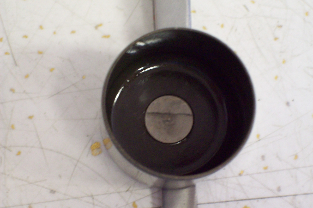

Found what I think is the starting of a crack in one of my fancy shim buckets. Its only on the pad where the shim rides inside of bucket. If you run your fingernail over it, you can feel it. Can't see it on the top side of bucket. In all my years of working with 650 style buckets, this is a first. Got to find someone nearby that can magnaflux it and see if it is a crack just starting. Glad I caught it before the bucket shattered taking my fancy head with it!!!!
You can see and feel crack on the shim pad.
Nothing visible on top of bucket yet!!!

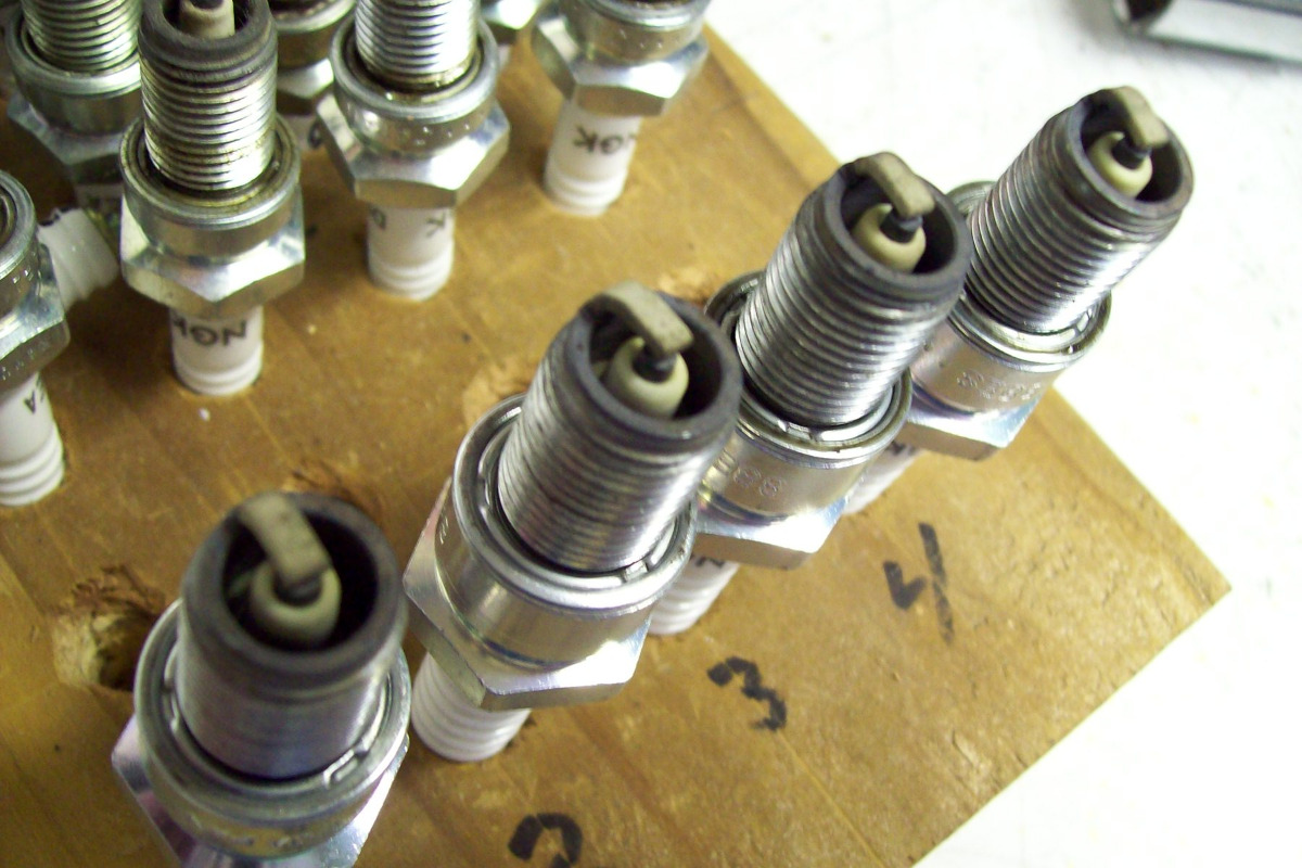

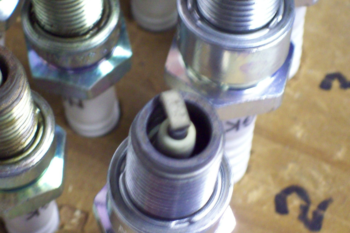

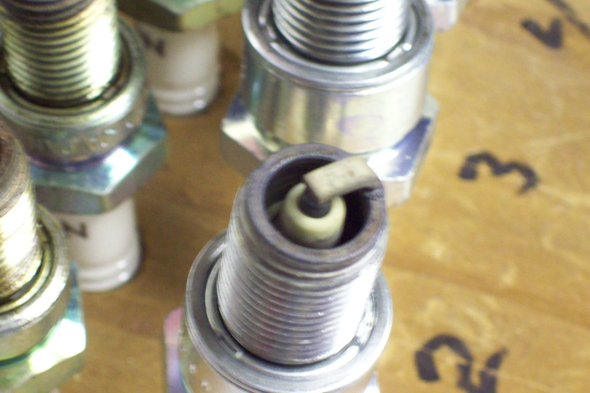

Got to do some real plug chops to see what my jetting really was like. I think I am real real close to being right on with the overall jetting. No little balls of aluminium on the porcelain on any of the plugs so the timing is real close too!!!! Have a look at the plugs. Looks pretty good to me.
#1 PLUG
#2 PLUG
I put enough miles on my fresh motor to start running it to its redline, 10,500RPM on a good tach. I forgot how hard that motor pulls!!!!!! It will set you back in the seat all the way to near redline in 5th!!!! No wobbles at any speed even after hitting some big bumps at speed. With hockey pucks for tires, I really couldn't push it hard through any of the corners.
#1 PLUG
#2 PLUG

Yep!!! It gets nice and twisty just north of Wilhoit. I love it on the GSXR. The 30 year old tires on the Superbike just won't cut through there!!!! Wish I could swing for a set of Avons for the Superbike. There ain't much runoff room all the way through the twisty bits. I would be sick if I crashed the Superbike. I can't afford it either. It really sucks living on a budget. A tiny one at that.
