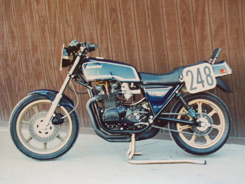

That is one beautiful KZ1000, what mods did you do at the rear to raise the seat..?

31 Aug 2016 12:01 - 31 Aug 2016 12:03750 R1 wrote: That is one beautiful KZ1000, what mods did you do at the rear to raise the seat..?
I only used the two stock front tail section mounts, the rear tail section mount I fabbed up myself. That rear mount at one time was also where I had my oil cooler mounted to until they changed the rules. I just raised the tail section up, and made the new bracket. Then I reshaped the seat pan to match the newly angled tail section. I have over 7 inches of rear wheel travel on this frame. That's the reason I had to raise up the tail section.

Thanks Gamma, I saw the pics of the frame mod but was wondering what you did to the seat, did you basically just bend it a bit, or cut stretch and weld..? I am amazed at how much it changes the look of the bike, much more aggressive... I love it...

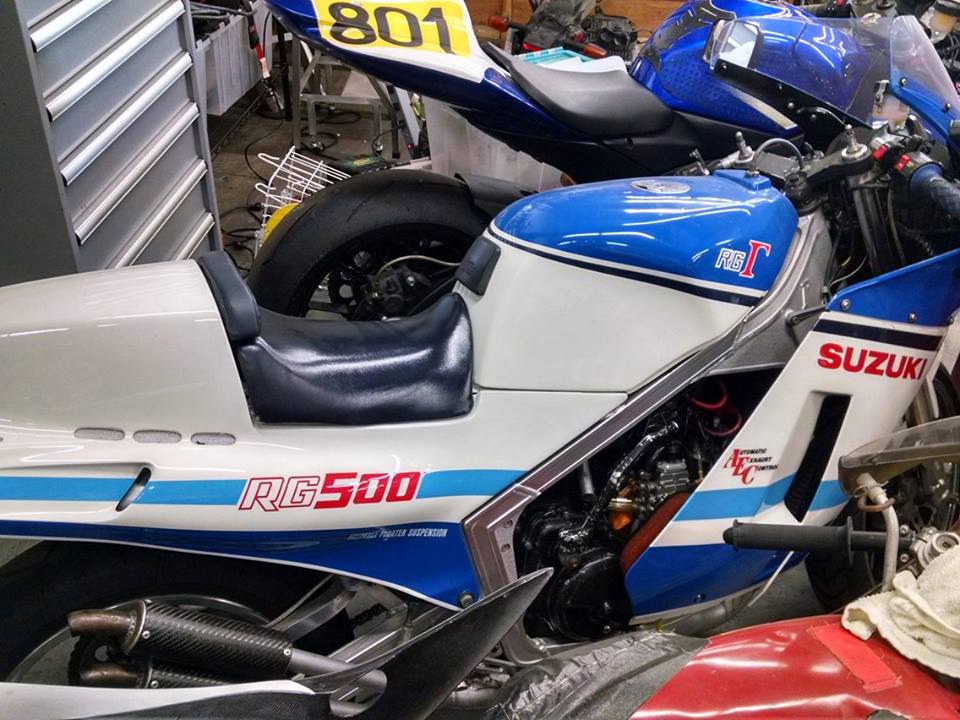

Congratulations on the Suzuki's win Doc.
They are a rare ride.
I know of three and one frame that buddies have.
