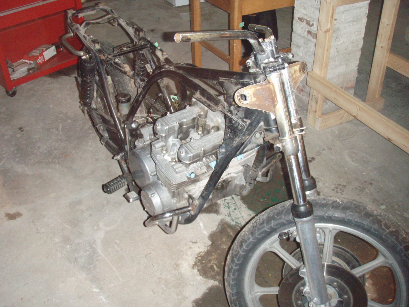

As it stands at present, I now have a bare frame in the basement and a large collection of labelled and sorted boxes containing the entirety of a bike. It's kinda interesting to see a bike broken down to component elements and put away like that.

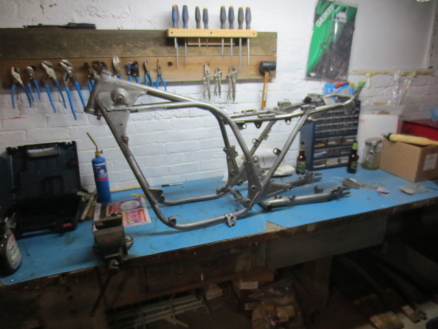

Frame stripped as least as far as I was able with chemical stripper, wire wheels etc.... I am never doing that by hand again. It would be worth the money to buy a sandblaster and do it in an afternoon. Soooo many hours to get it that far. Still, rewarding work, and I certainly learned something. Frame and swingarm are out for semi-flat powdercoat right now. Should be back in a couple of weeks.
Just an idea of where things were a few months ago.....

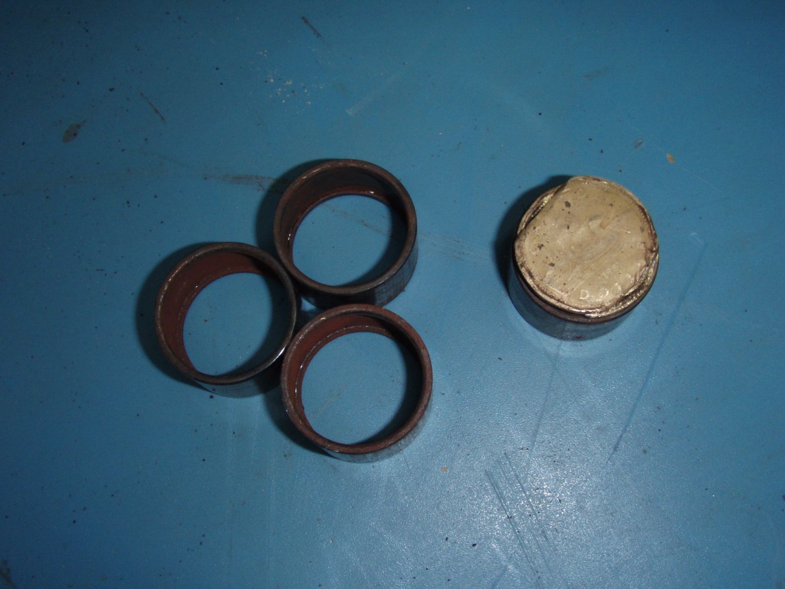

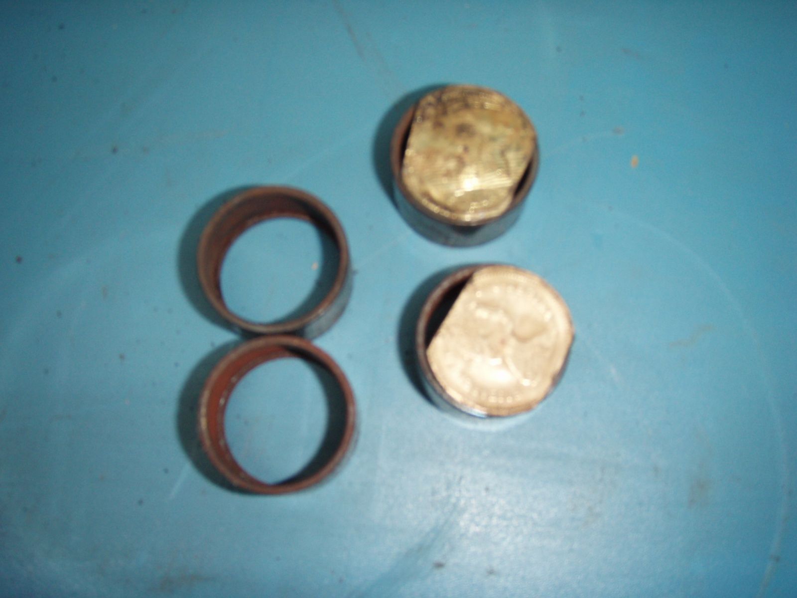

And finally, a trick for any Canadians out there who are struggling to remove swingarm bearing outer races. My $2 removal kit. (literally!)
So, it may be cheaper to go to the store and get some heavy washers like most people have done, however, when it is a really crappy December afternoon, and a trip to the nearest hardware store is going to take longer than the value of two coins, this works a treat. After heat cycling the bearing races (BFH method failed, and actually bent both coins before heating the races!) A loonie fits pretty much perfectly across the bearings on the inside.
