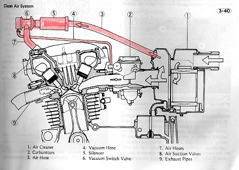

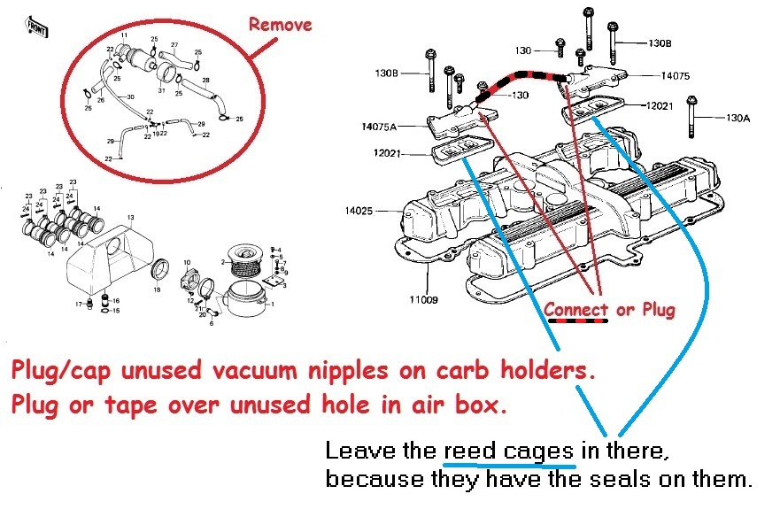

Kawasaki "Clean Air" system, as originally designed.
Upon removal of the clean air system, any old unused vacuum hoses should also be removed, because they provide additional sources for possible vacuum leaks.
Last edit: 01 Mar 2013 12:21 by Patton.

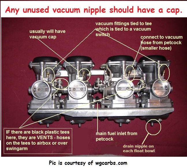

Fuel line is supposed to run from the petcock, through an in-line filter, and then to the carb where it attaches.
A separate and smaller vacuum hose also runs to and attaches to the petcock. It supplies vacuum from a running engine to the petcock whereby the petcock is supposed to allow fuel flow in the ON or RES position.
The carb end of the vacuum hose from the petcock may be attached to any available vacuum nipple on any carb holder. Some carb designs include a separate vacuum nipple on the carb itself, which looks very much like and is sometimes confused with a carb vent nipple.
Any unused vacuum nipple should be capped/plugged, because an "open" vacuum nipple creates a large undesirable air leak.
Good Fortune! :)
Good Fortune! :)
