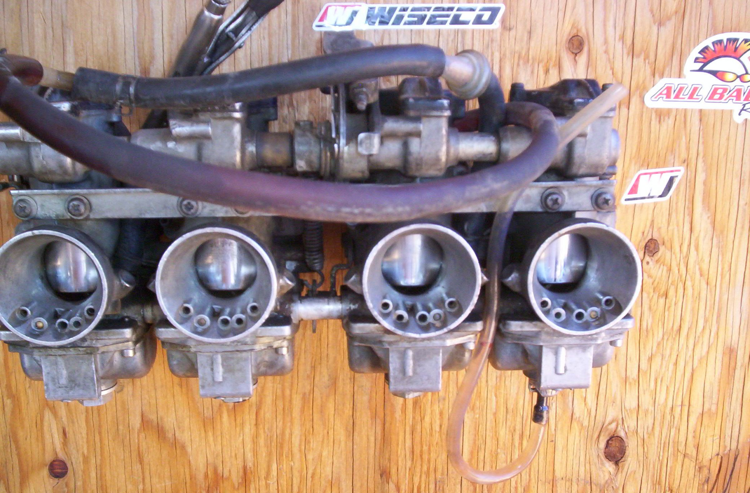

Very handy place to work on them
The kids named her Bossie the Kaw when they were young. My 69 Ford F250 is called Bertha. :whistle:

Oh for sure it is. Beats my ardox nail on the garage wall beam and hanging the carbs up by the spacer body.

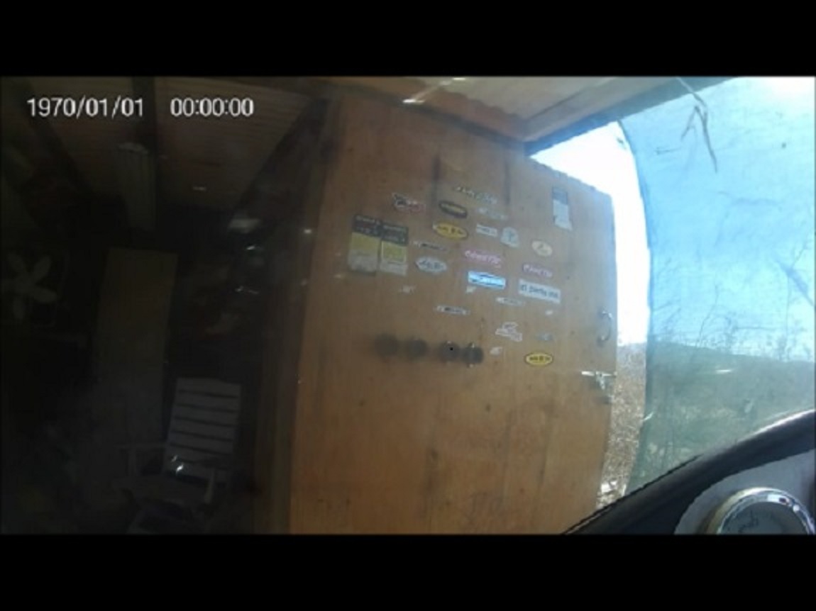

- Posts: 23776
- Thanks: 3042
Re: 650 Mod's 78 Fighter Build
28 Jul 2016 16:12
- 650mod
- Posts: 569
- Thanks: 48
28 Jul 2016 16:27
Steve- that's a sweet set up. I do pretty well the same, just a little sketchy on my end. A single nail holds the carbs up. So if it ever slips... i'm done.
