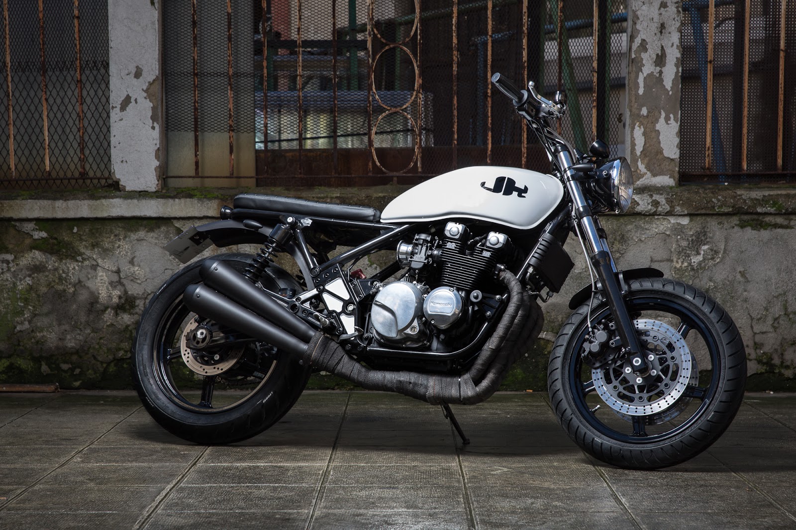

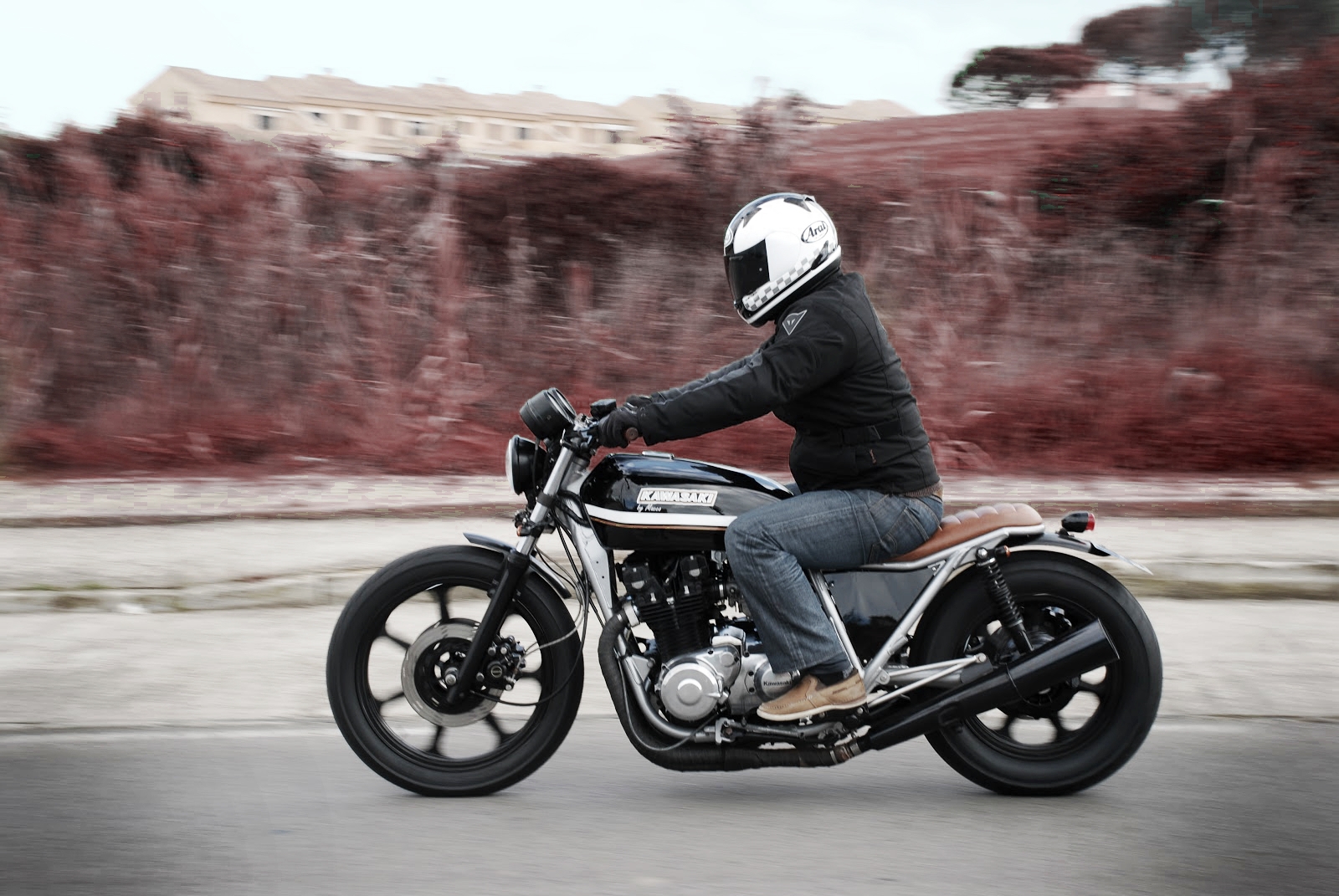

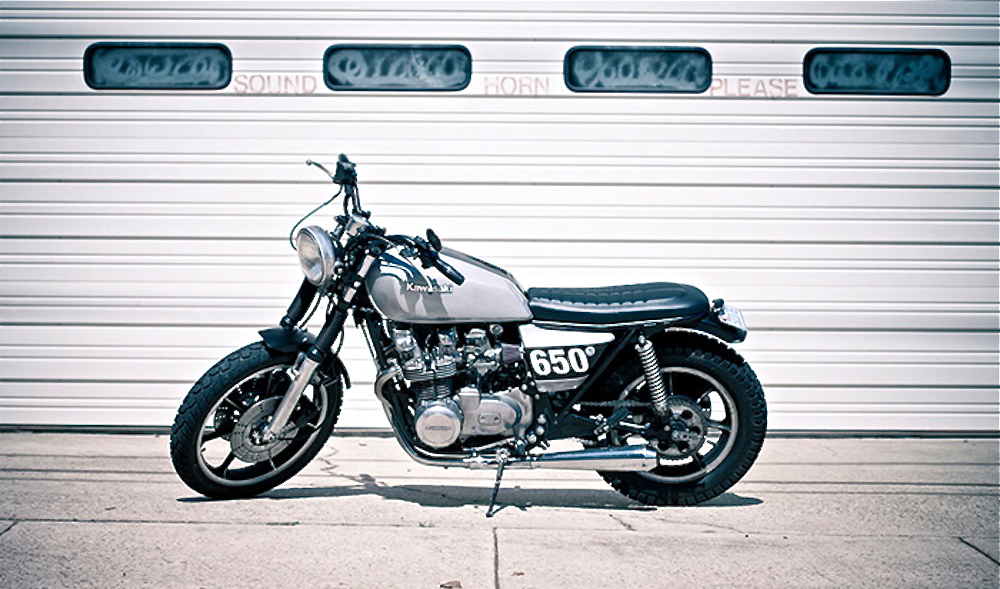

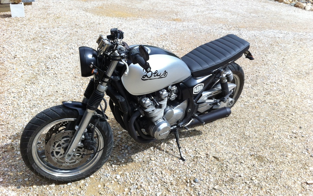

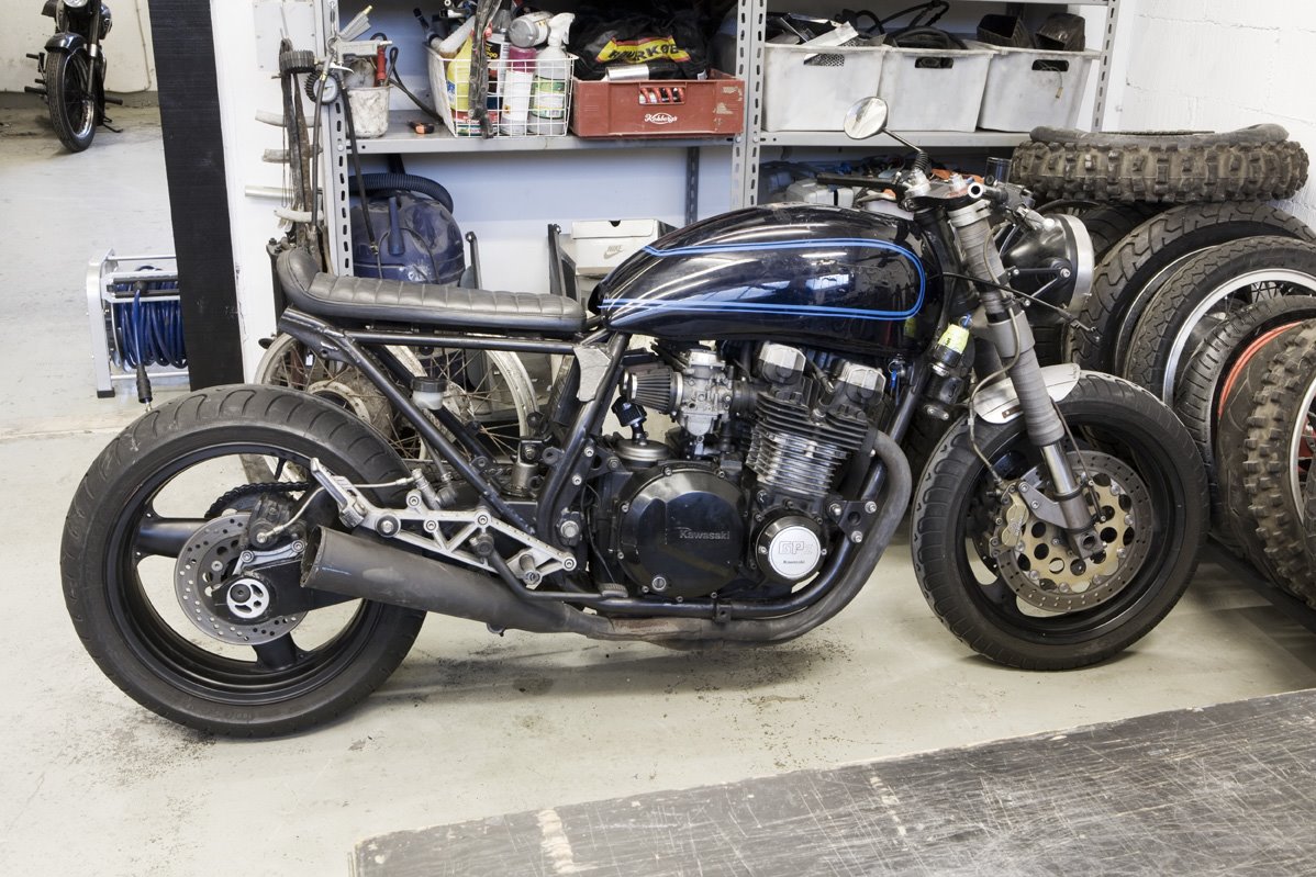

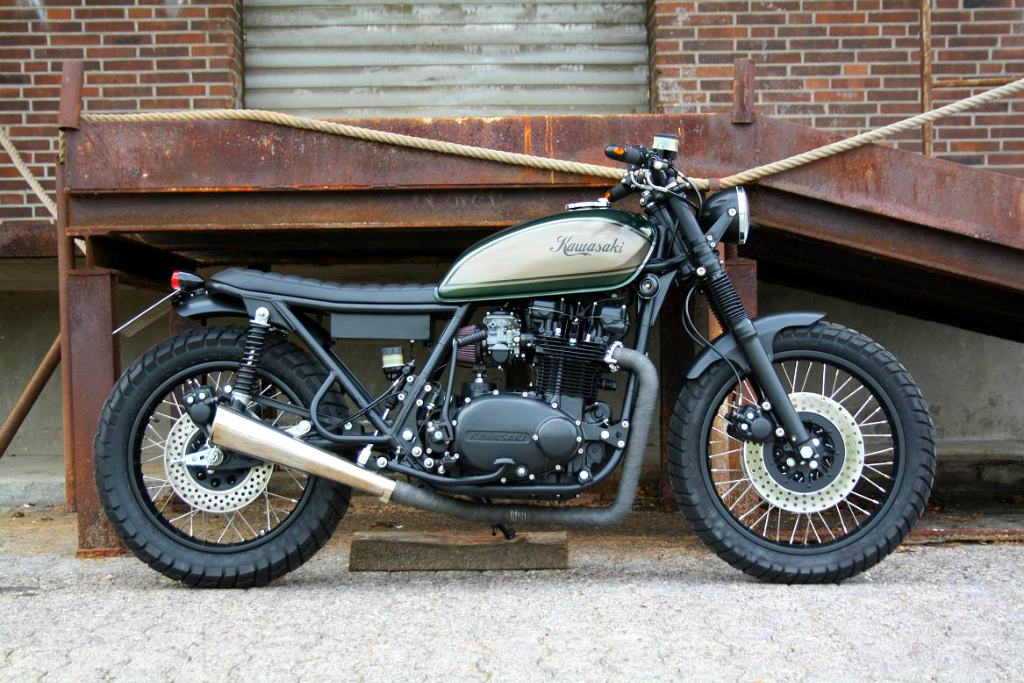

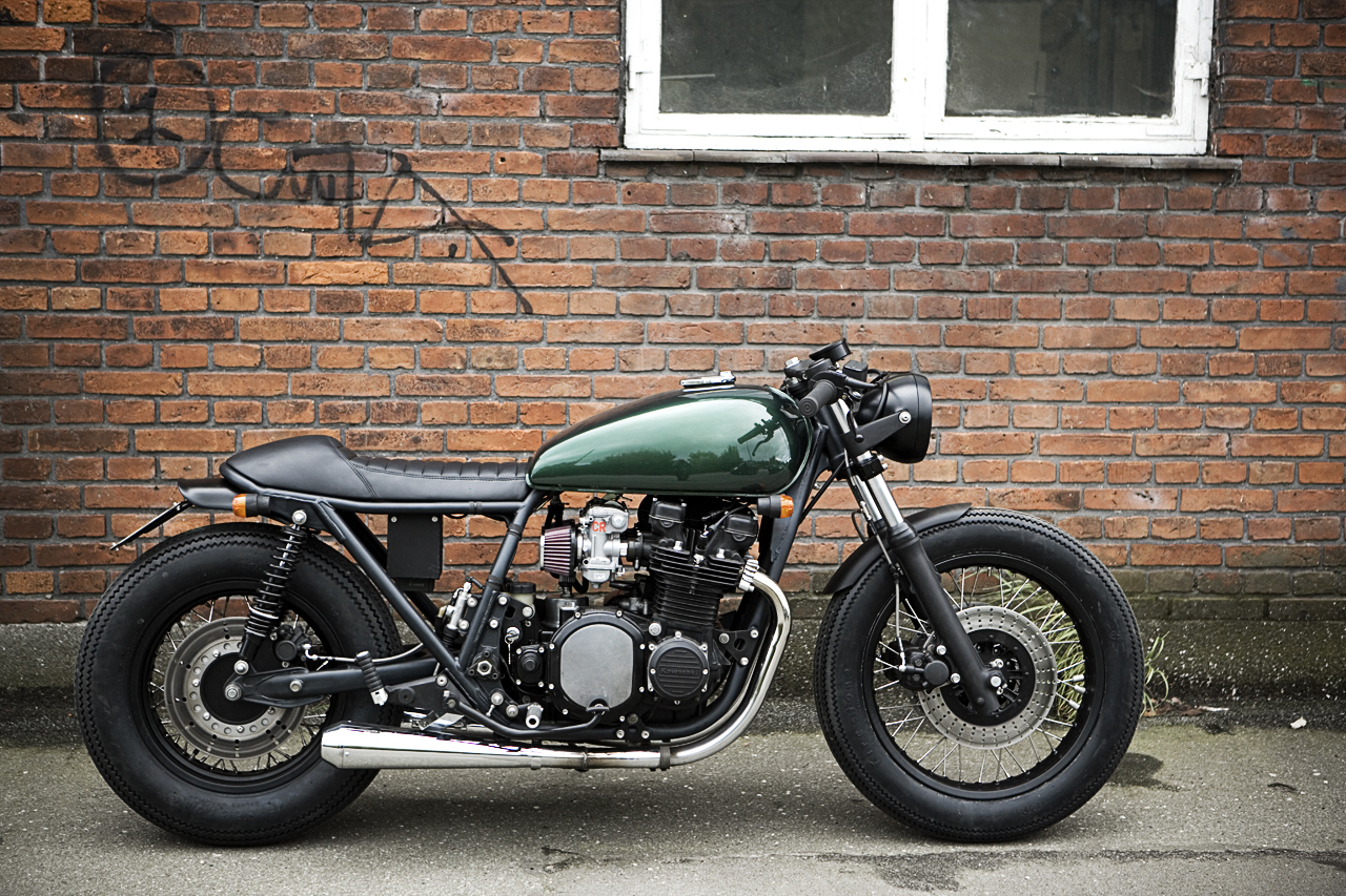

Here is another Brat, some nice details on this one.
1980 kz1000 LTD
1978 Z1R
1978 Z1R
