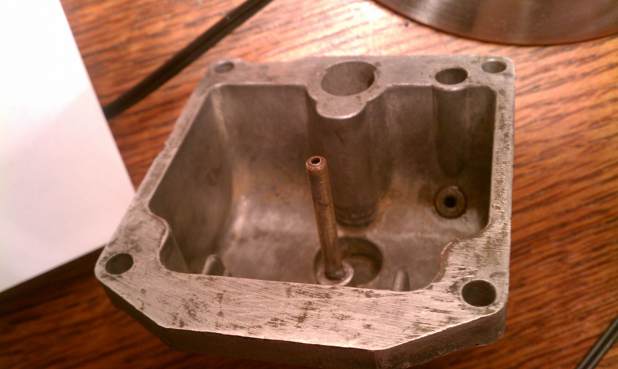

Alright guys, my stupidity amazes me. After alll that stuff to try to stop the leak, i spent 2 minutes polishing and cleaning the tubes this morning and found something worth noting:
lol, i can't believe i didn't see those. I even filled the bowls with water to check for leaks, but i guess the differences between water and gasoline made it not leak.
So i suppose the best way to fill these is soldering them? Anyone have any technique, i've never really soldered much besides a few electrical connections.
Thanks guys.

04 Nov 2012 12:29650ed wrote: I suggest you read through the following thread....
kzrider.com/forum/3-carburetor/553801-en...t=20&start=20#554472
that's a pretty good thread. thanks. so loudhvx recommended using acid flux and lead solder and just torching it on, not using a soldering gun. Is this the method anyone else recommends?

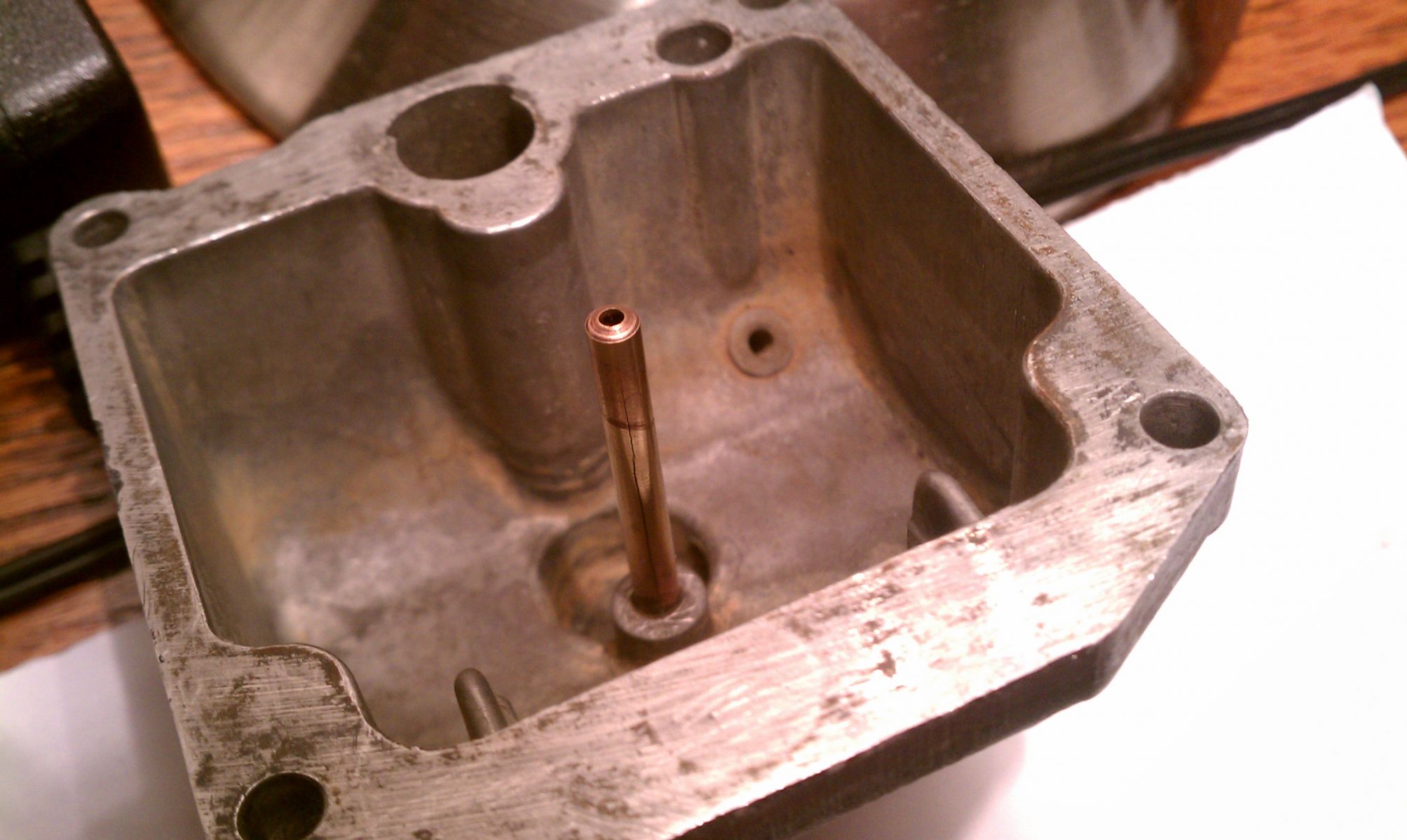

I fixed mine by using a micro torch, flux, and solid core solder. You first sand the tube (which you did), heat the tube up (but not too much where it will damage where the tube fits into the bowl), and once hot enough apply solder so it gets drawn into the crack. It will actually suck the solder in so you have to be careful that you don't apply too much solder and thereby clogging up the tube passage instead of just the crack. Apply as little heat as you can get away with. Then just re-sand once cooled.
Before soldering:
After soldering:

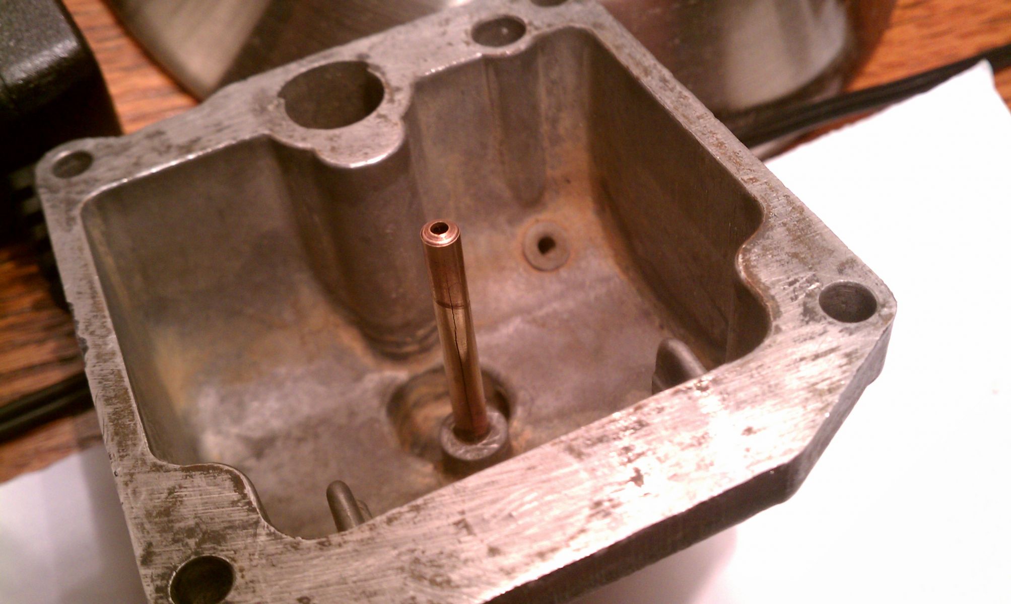

Ok guys i jsut finished soldering them up. It's sloppy (due to inexperience), but it holds. I filled up the bowls with gas and there are no leaks. I had some trouble getting the tube hot enough with just the 25W pencil iron, so i had to torch the tube with a propane torch, put some solder on the tip of the gun and lay it on.
ready to go back in tomorrow morning:

You can clean it up flush if you want to spend the time. Just use a small metal file and sand paper. Functionally won't matter. But on the other hand, wouldn't want any chucks to break off that and get sucked into the passages.
