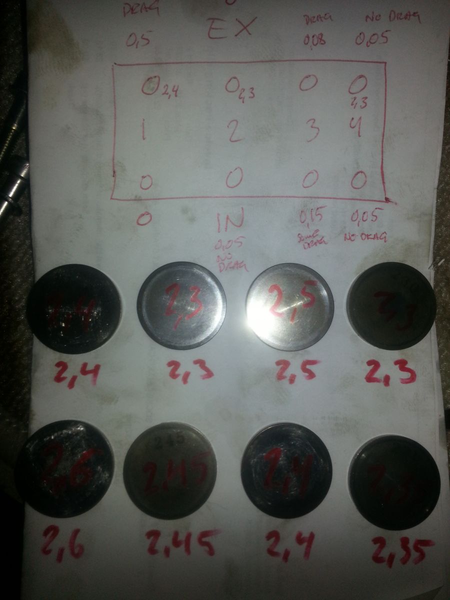

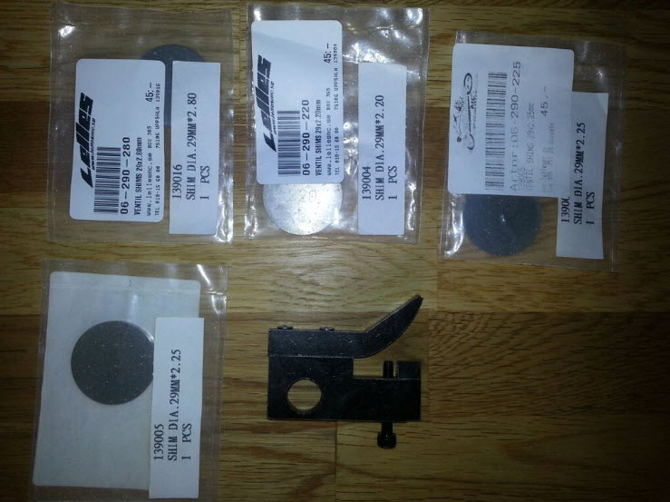

So...the issue with number 1 cylinder is about to get resolved.
We have some issues:
The stuff to sort it out:
