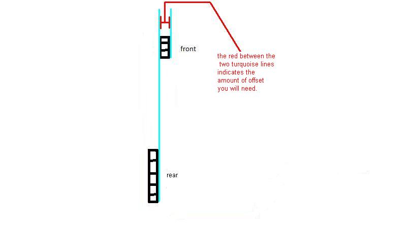

here is how to measure the offset for offset countershaft sprockets.
with a stock front (countershaft) sprocket mounted.
project a straight line forward from the back side of the rear sprocket and measure the difference between the back of the front sprocket and the line you projected forward.
that will be the offset needed to get a straight chain run.
