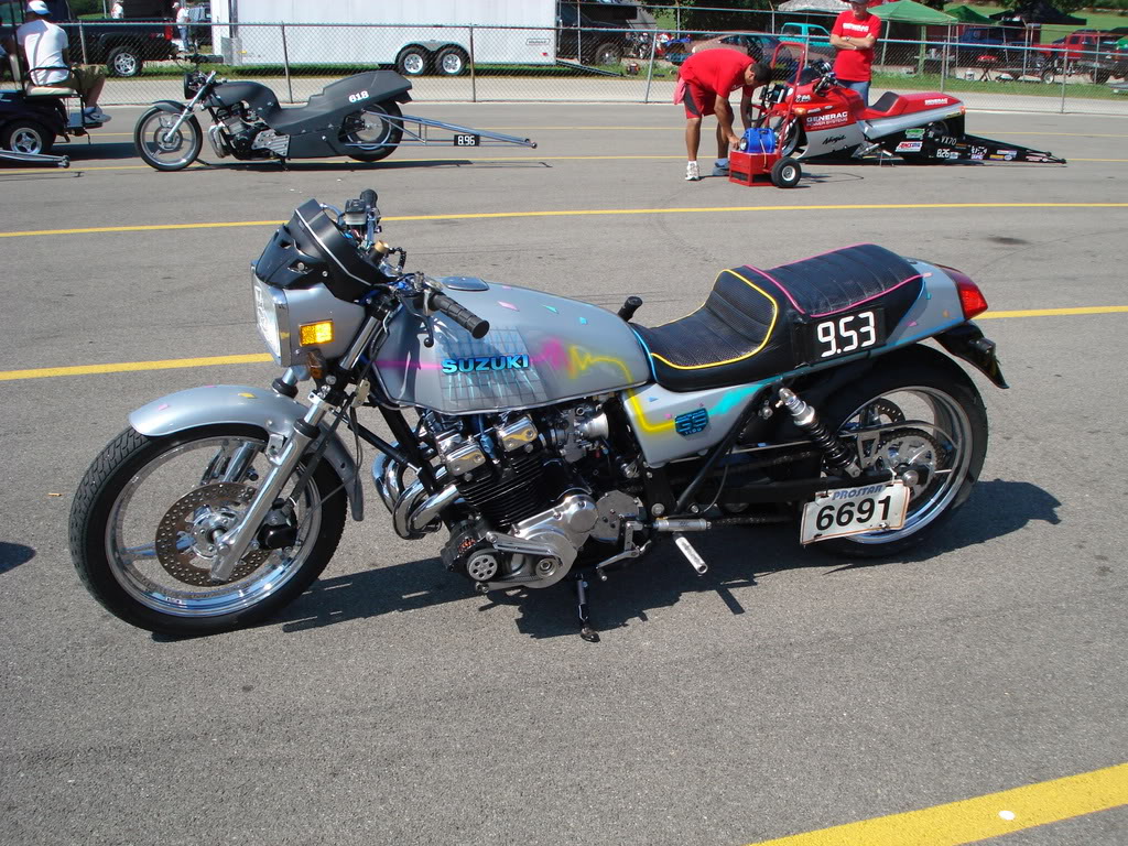

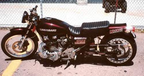

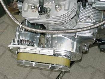

I'd like to get one of those set-ups that run off the end of the crank but they use an alt. off a suzuki (I think). Have seen them on a few older Suk's but only one KZ. Takes stress off end of crank. Like on this bike...

That is interesting as I have never seen a kit to do that. Every one I have seen were custom made. I am using an automotive alternator.
